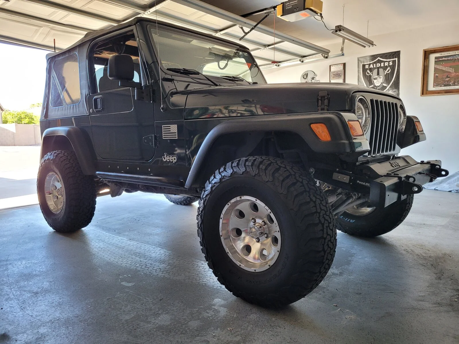

Anyone running a 2.5 inch lift with 33 inch tires? Pics and opinions wanted!

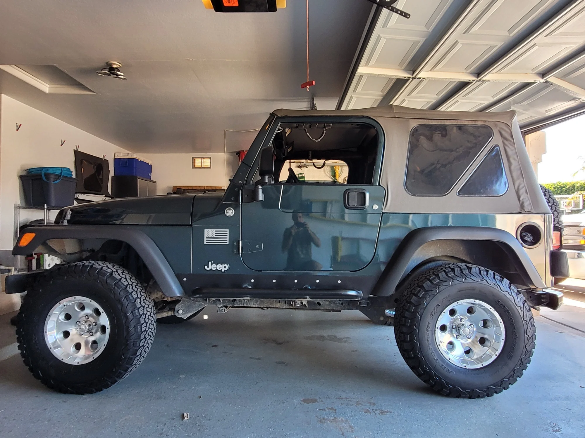

I personally wouldn't be comfortable running 33s on a 2.5" without adding a body lift to gain some tire clearance. I'm running a 2.5" OME lift with a 1.25" BMB body lift and 33x10.5s.

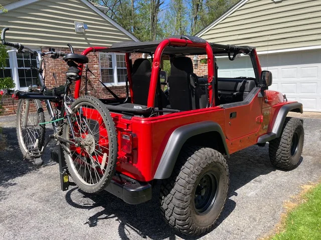

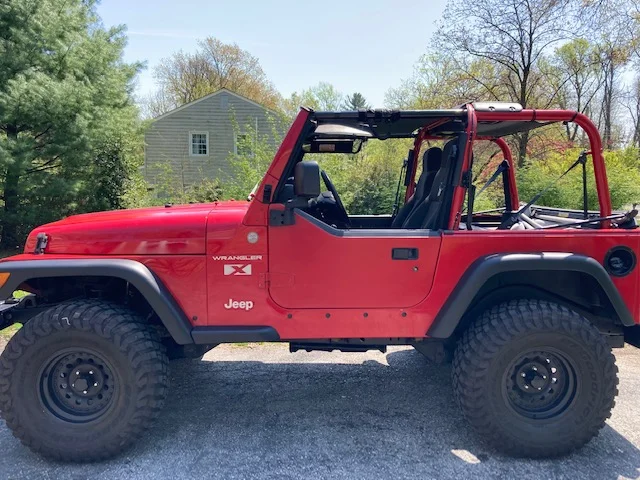

I’m close to that - the Genrights make it look like 4”
What wheels are these? And specs if possible. I’m wanting to run some solid wheels on mine, but these are some of the best looking wheels that I’ve seen so far.
