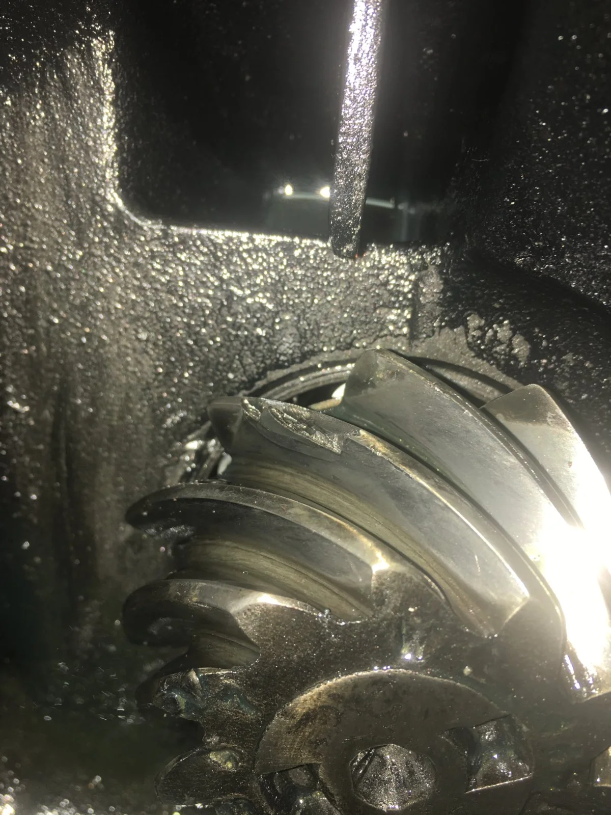

Here’s a pic of the Dana 44 pinion on mine.
Of course, this is sitting in the bedroom, so I’m not too worried. I won’t be running 40’s. :D
How did that happen? Or do you know?
I don’t know. The backstory is I bought the Dana 44 from a guy. When I was checking it out I pulled the shafts and looked at the ring gear. It looked good. When I got home I pulled the carrier and found the pinion badly damaged. The guy was running it on this rig, but he didn’t wheel it, so I guess 40’s are too much for a Dana 44 no matter what.
The good news is that the guy felt bad and offered to regear my rig for me. So, regear for free, heck ya!
Wow... that's damn nice of him!
And yeah, I think we can all agree that 40s are way too big for TJ Dana 44 axles!

I agree. What he upgraded to was a front and rear TJ Rubicon 44’s. I asked him why he didn’t just go to at least a rear 60. I don’t know. He got a great deal on the TJR 44’s, probably less than I paid for my 44 from him. He’s always getting good parts. He’s sort of supplying me with parts now. Anything I need I text him and he’s either got it or finds it.
I don’t think he will have much luck running 40s on TJ Dana 44 axles, even if they are built. At that point you’d want some full width Dana 60s or bigger. But hey, maybe he will prove me wrong!
