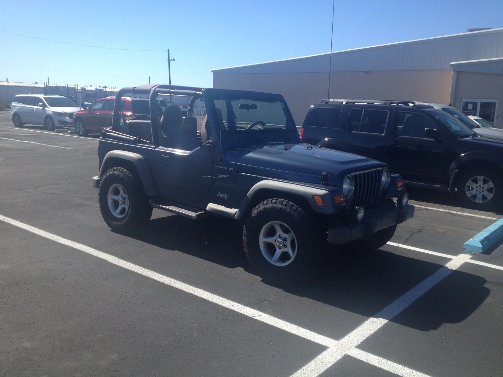

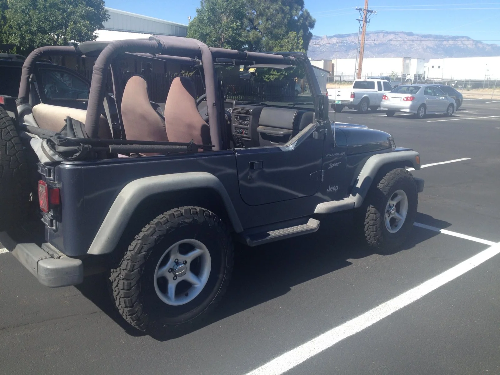

Related, but not really...it's not just JK owners who are sometimes blissfully ignorant. A fellow employee where I work and her husband were raving to me last week about the new BFG 33x12.50-15 KO2s she just got put on her Jeep. Her TJ sits on the stock suspension, no lift of any kind. She does have aftermarket wheels with less backspacing, but that's it. They told me 'they fit fine!'
I didn't have the heart to tell them they more than likely will take out a fender/flare if they hit a substantial bump...

I took a couple of pics out in the parking lot of the end result after the 33's were installed, you'll see what I meant:
The tires have nowhere to go...
View attachment 44982 View attachment 44983
Yeah, tell them I'll make a good deal for them on the 2" BB in the Parts for Sale. I need more TJ funds for my next mod and they need at least 2". And you can install it for them and save yourself from the embarrassment you'll cause them. How is this a bad idea?! :risas3:
