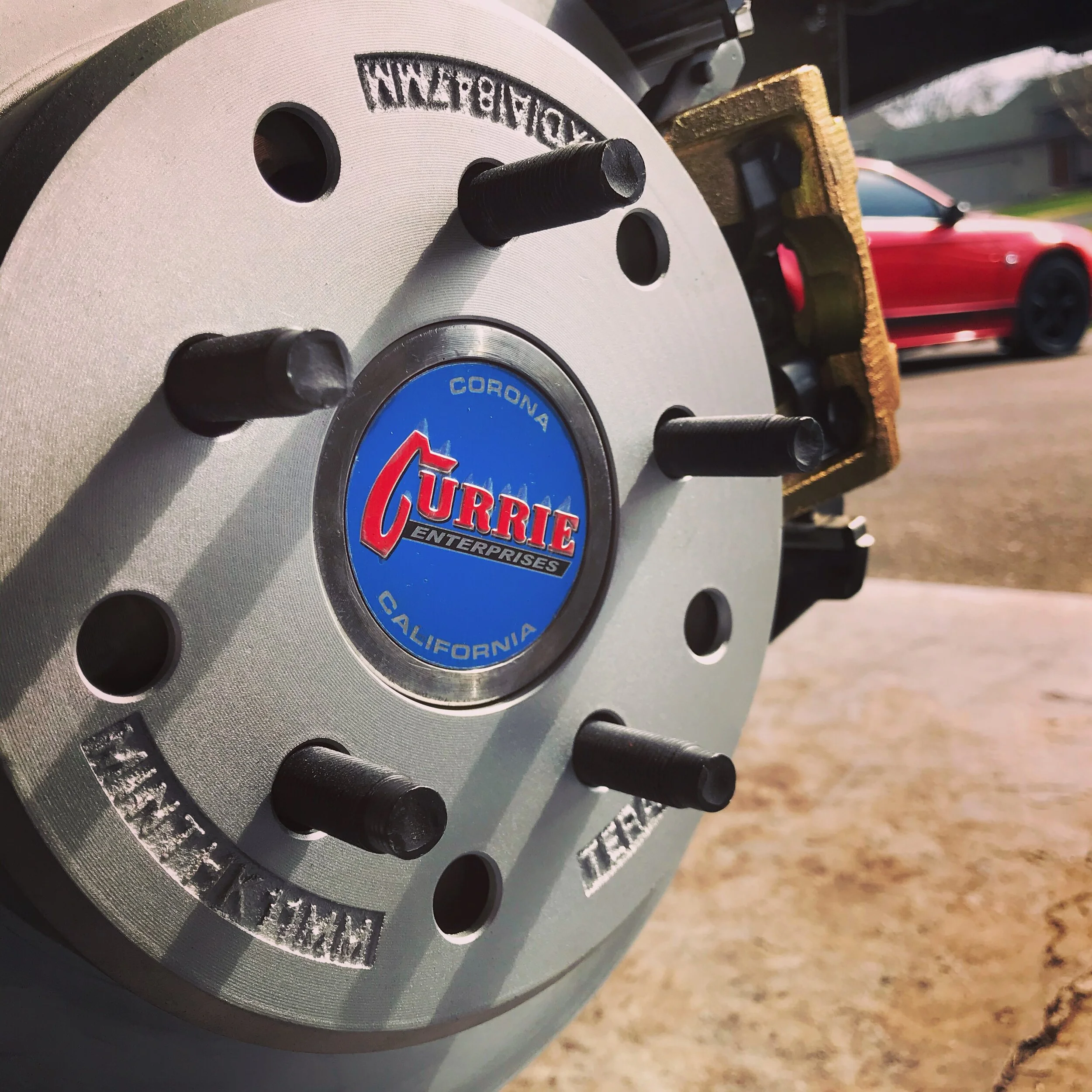

In my full float HP Currie 60’s I have them in 5x5.5 with 5/8” studs so they are available.
