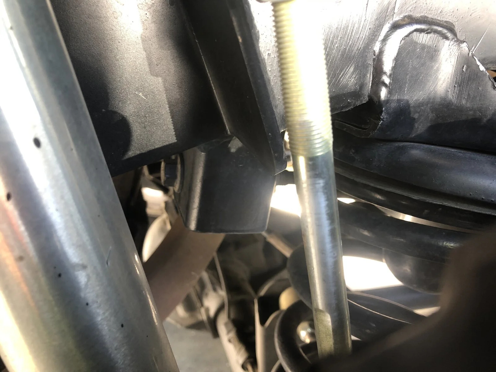

Blaine moved mine inside the frame. A midarm is in my future, but this is how it is now with the short arm.View attachment 244577View attachment 244578

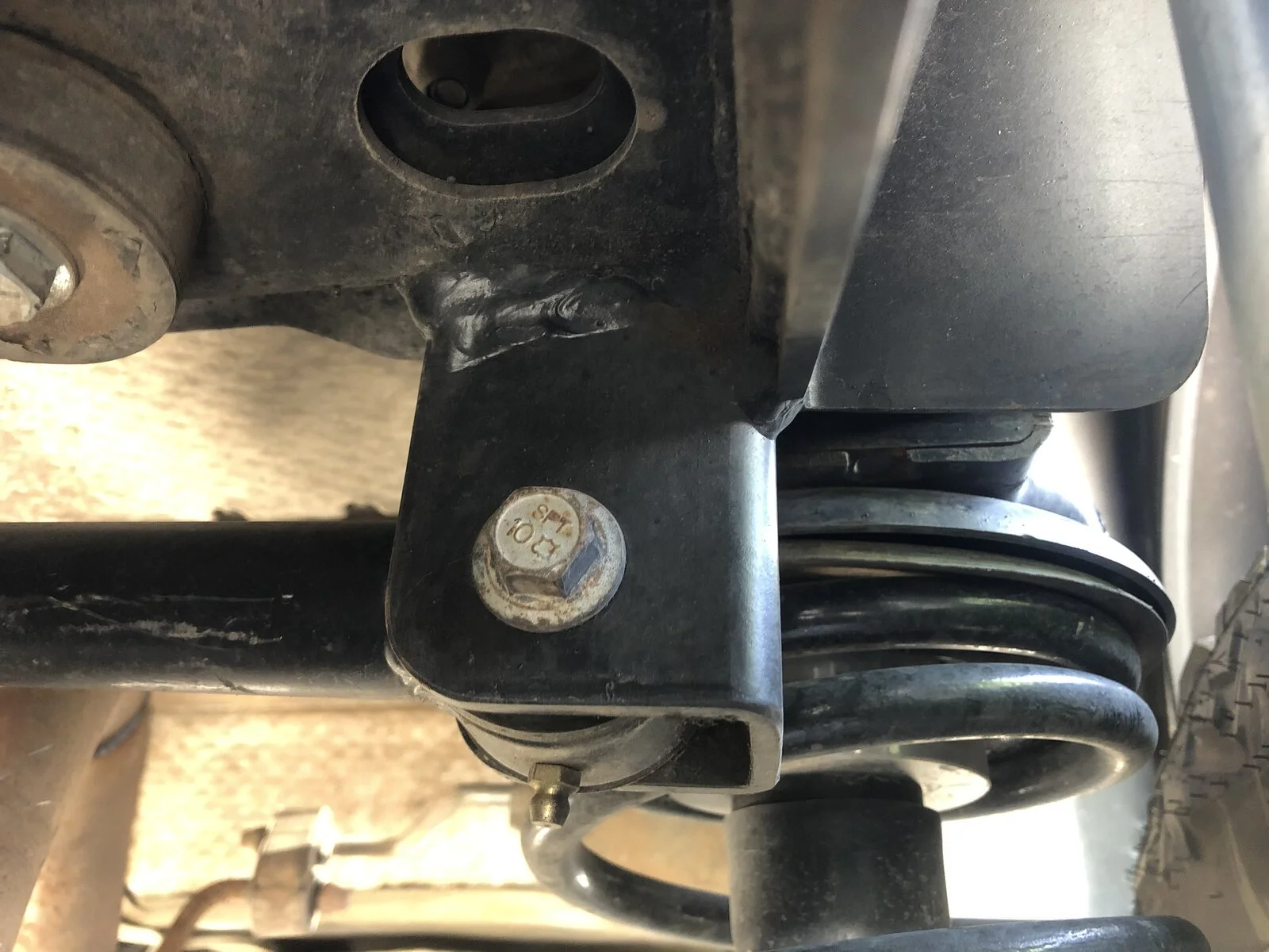

Had I known pics of my out of position-hood shoved up against the bottom of the tub- I can't fucking see- this is fully fucked and I hate myself right now-welds were going to be shown with such detail, I would have practiced up a bit more, those look like shit.
