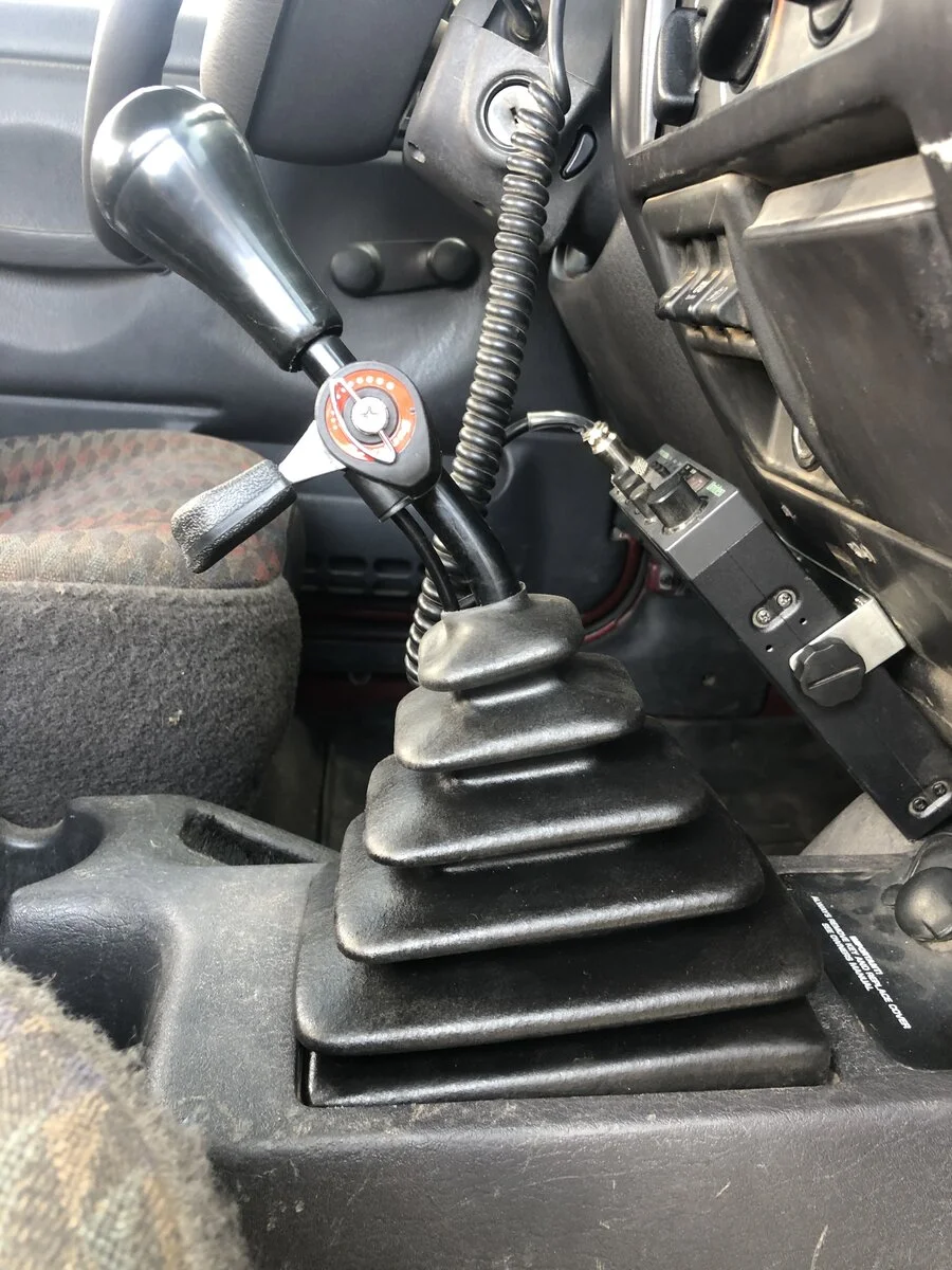

Much better, flexing that hand throttle tooLike this new shifter boot I took off the guys hands since mine had a giant rip through itView attachment 160156

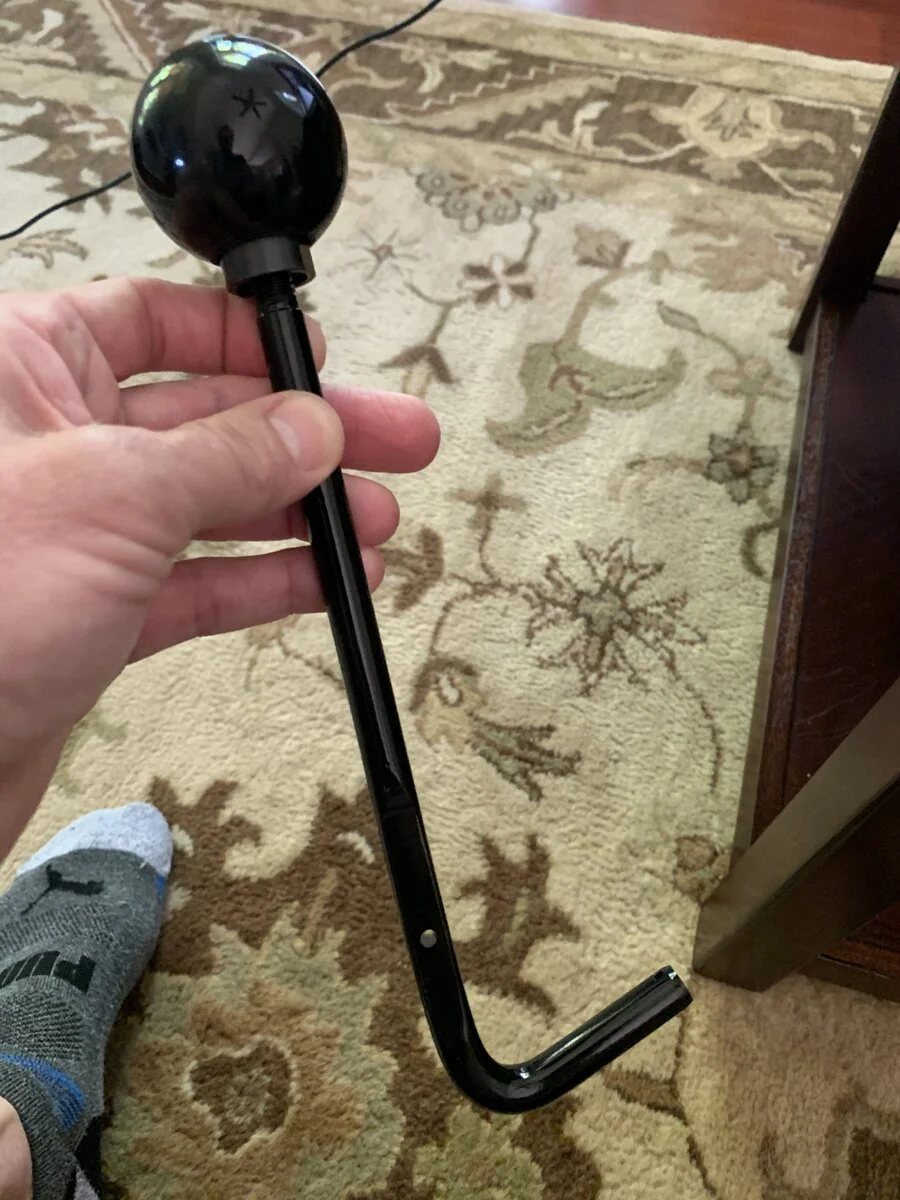

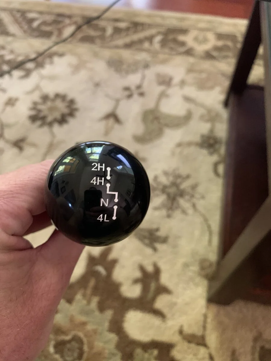

Nope what is that?Much better, flexing that hand throttle toohave you send the transfer case handle mod?

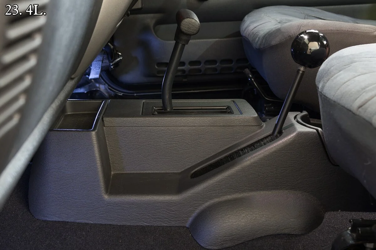

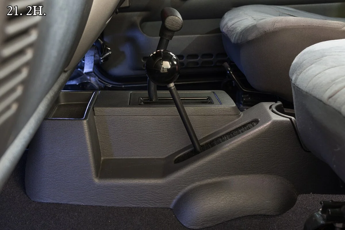

That looks awesome. I would have to find a new place for my CB though...View attachment 160161View attachment 160158View attachment 160159View attachment 160160
Might not be your preference but it makes the shifter much easier to get to and use off road. The factory handle is low for legal/idiot reasons. You can put whatever knob you want on it.
