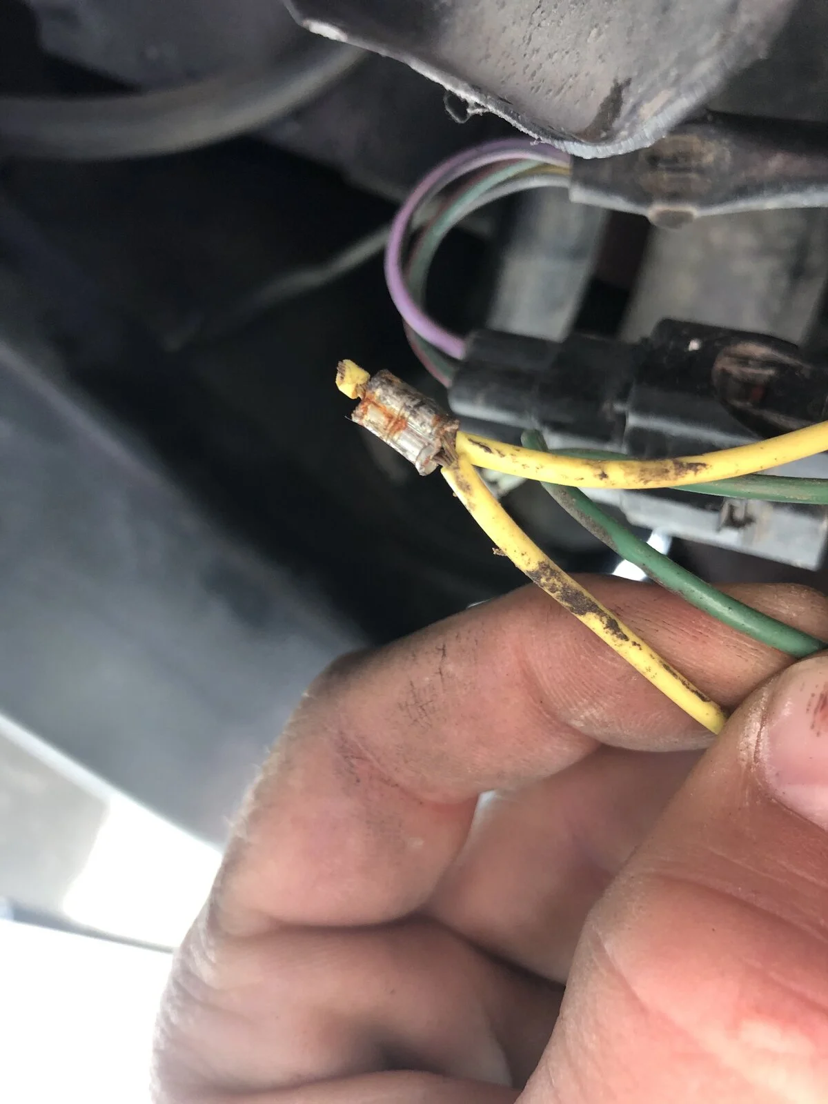

Wow POs are astounding. Going through some wiring for my license plate lights and all kinds of no nos. This crimp was covered in electrical tape but the butt end conductor was still exposed.

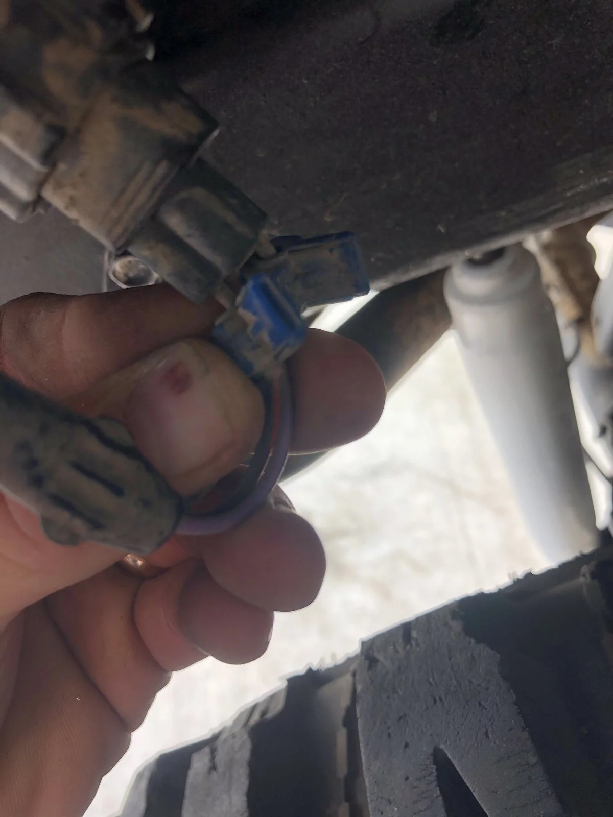

The conductors on these scotch locks are also exposed.
View attachment 235655The conductors on these scotch locks are also exposed.
Scotch lock style connectors. I hate those things on external wiring. I use them inside sometimes.
Good on you for cleaning it up. Those wires would be green already if you weren't in AZ!

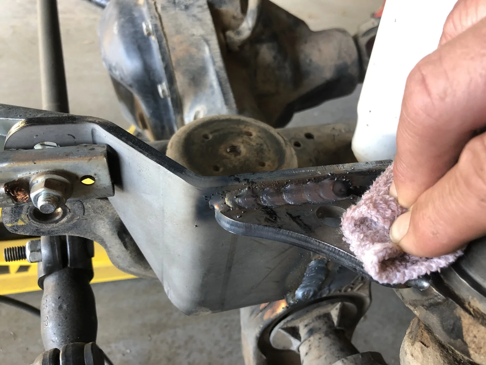

Getting some practice with the welder putting some black magic raised sway bar mounts on my dads Jeep. I’m still a total beginner welder but I’m gaining confidence.
I can’t wait to do all the fun cheap mods a welder opens the door to.
The welds look great!!
Got a good welder and good mask now. Making this welding thing a lot easier. Still learning with every bead I drop on real projects. It’s so much different getting into tight spaces at different angles than welding on a flat piece of scrap.

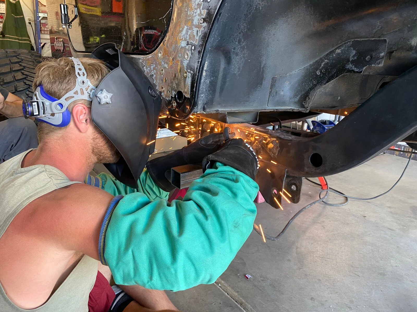

I’ll let @pc1p give the update on his project but I had a ton of fun helping him do a 5” rear frame stretch in his TJ yesterday.
Here’s Patrick giving me a lesson in vertical plug welding! Don’t let it get too hot or the puddle runs out of the hole.

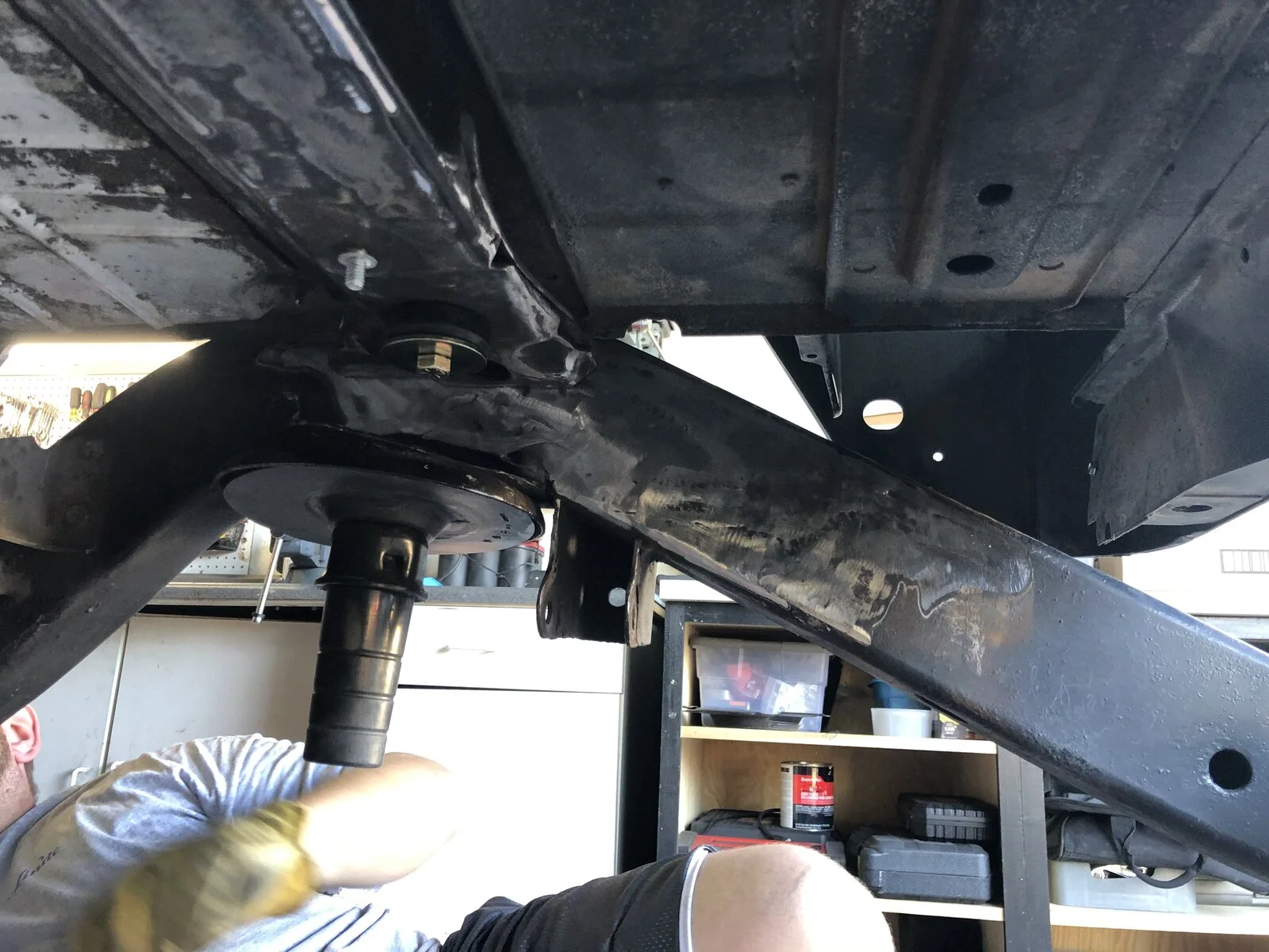

Fun discovery here is that the middle crossmember is in front of where the trackbar would be if you chose to do the stretch with a short arm rather than triangulated midarm.
We also determined that Patrick will be better off with blank corners and cutting his own wheel opening. Looks like the tire will be running into the stock gas filler location. So we figured something out that helps both of us. I’ll order him blank corners in exchange for his stock cut Savvy corners. So these will be going on my Jeep very soon. @Alex01 has inspired me to try my hand at color matching them. Although the metallic chili pepper red color scares me a little I like a challenge.
Patrick was also kind enough to give me his scrap frame tubing from the project which I will use to do a rear frame raise here shortly also inspired by @Alex01 who made it look easy! Maybe one day I will use it to stretch my own TJ as well! Thanks Patrick!
Getting some practice with the welder putting some black magic raised sway bar mounts on my dads Jeep. I’m still a total beginner welder but I’m gaining confidence. View attachment 235753I can’t wait to do all the fun cheap mods a welder opens the door to.
Possible tip for you. It looks like you are getting some spatter (those little round dots stuck around the welds) with your welding. A couple of things to try if it’s happening often. Make sure the metal is clean, remove the oil coating if it has any, sometimes a quick flapper wheel across the edges you’re welding do the trick. You may reduce the wire feed rate a little. Make sure your not leaning the torch too flat, also or if there is a breeze or fan running it could be blowing the shielding gas away. Otherwise it looks good.
Thanks for the tips! Appreciate all the advice I can get to improve
