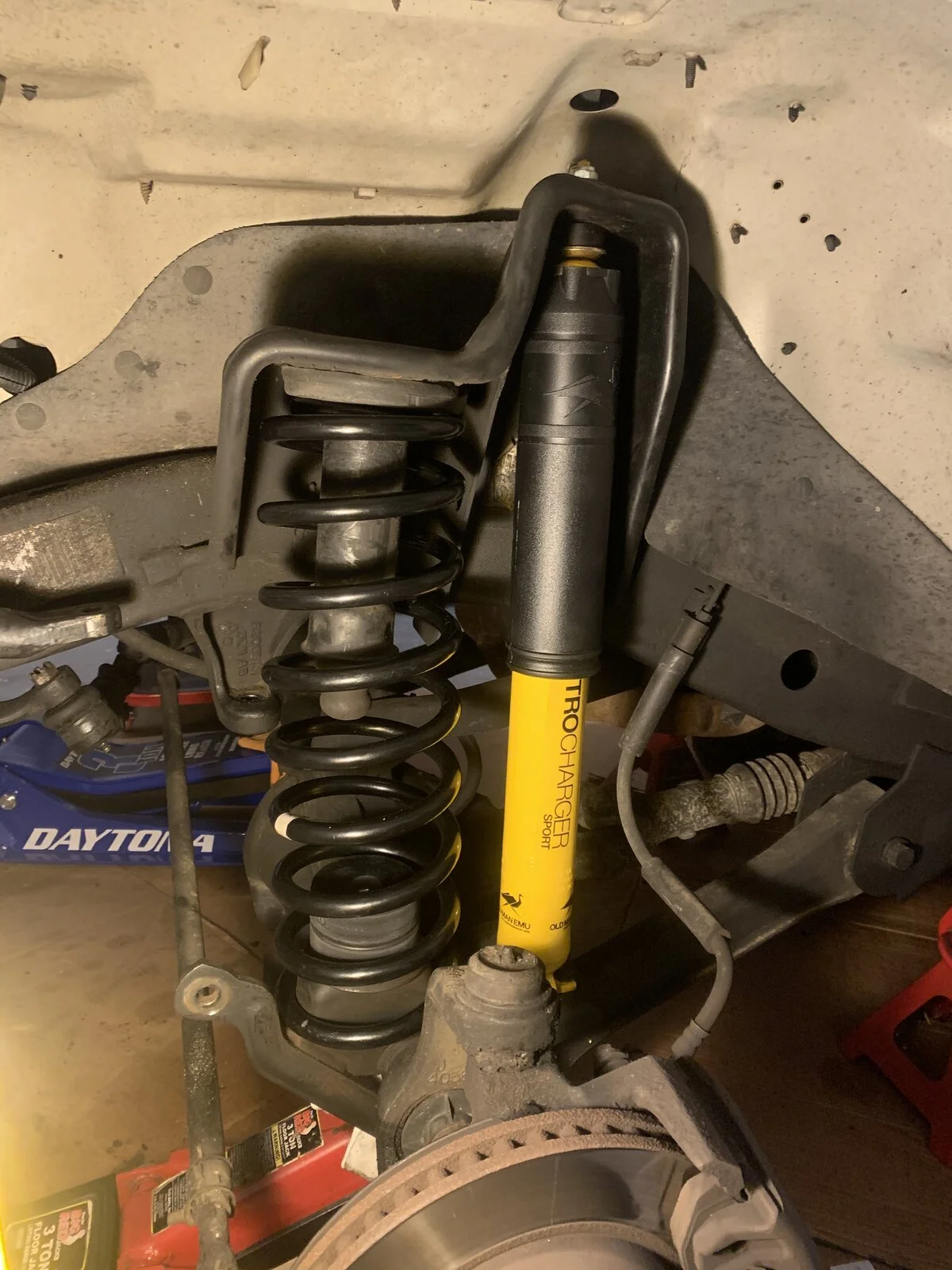

Thank you all for the help. Really can’t say it enough because I couldn’t have done it without your advice/what worked for you guys. I went and picked up Harbor Freight spring compressors and that got the job done. Onto Trackbar, quick discos, and Currie Currectlync this week!

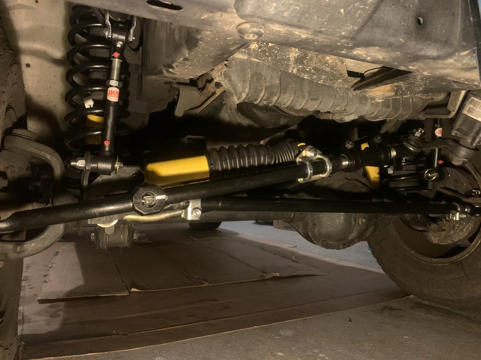

Looking good! What are you getting for tires?
Since you ordered the OME kit did you get the JKS Rear Sway Bar End Links? Wondering if you had to cut some threads off of those or not? Got any pics of the rear components so I can see if I'm doing it right? :D
I’m going to run these tires through the Northeast winter then I’m leaning towards BFG KO2’s 265/75/16
I did put on the JKS rear links and I had to cut off 3/8inch off each end of both sides to shorten them

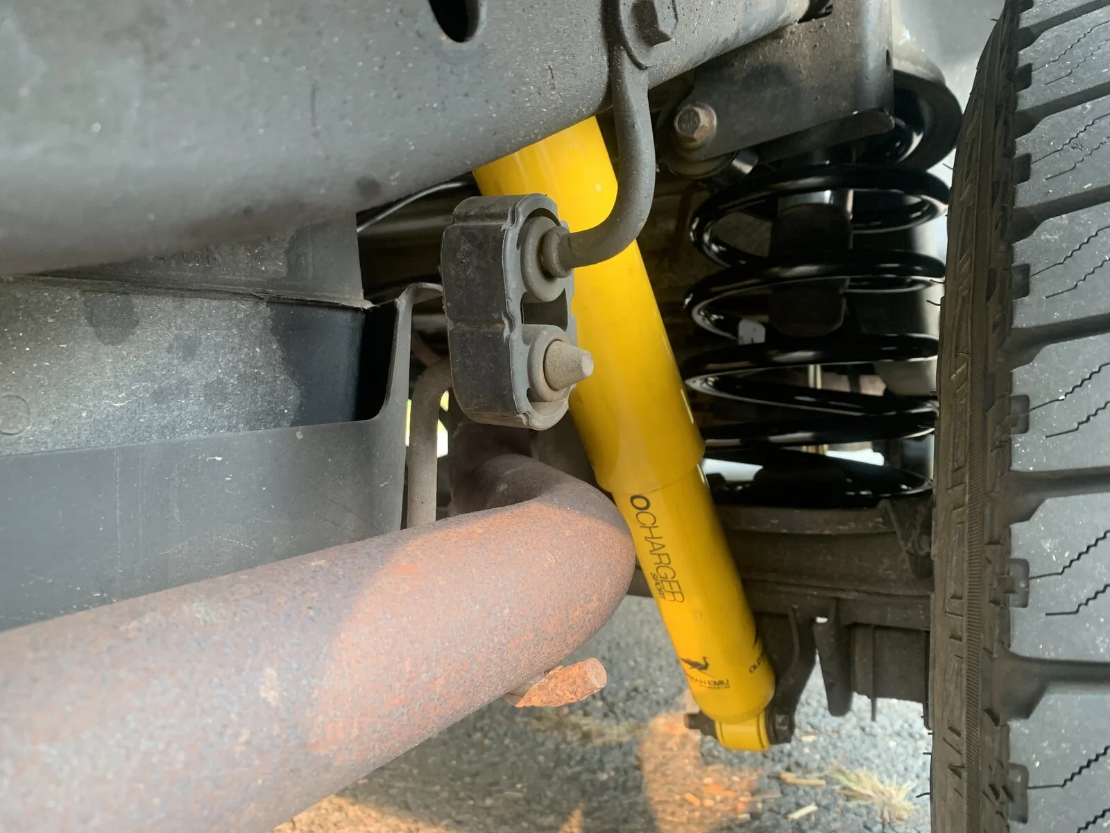

My OME shocks came with the black plastic upper boot/covers. Those look metal and similar to the older style OMEshocks that everyone says ride better.
Do you have the part numbers for them?

My fronts came with black plastic and rears with metal on rears. Front 60047 and rear 60048.
Oops, I was wrong. My rear shocks were all metal too. I had the same parts numbers too.
For some reason I was thinking all four had the plastic tops.
