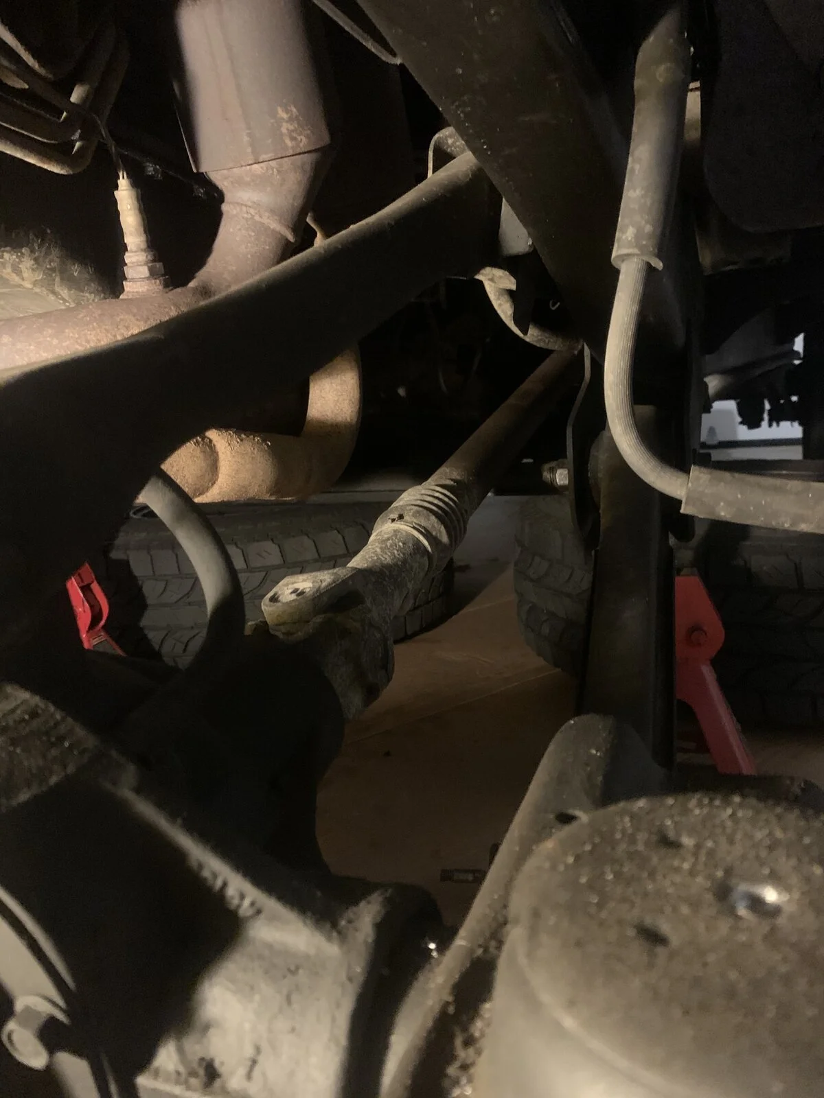

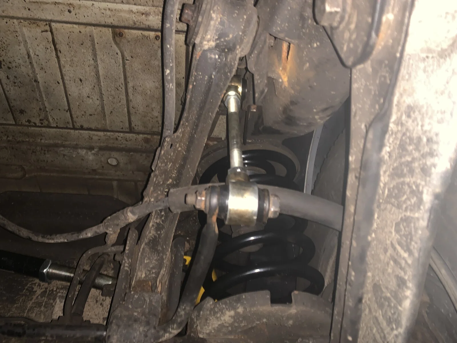

@isaac2098 could you post a photo or two of your rear sway bar links installed? I think I got mine right but want a comparison. Thanks!!

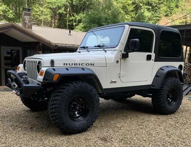

How much lift did you net on that Rubicon? Was wondering if the 2-2.5" OME lift is based on a standard ride height wrangler - Do you get less with the Rubicon since it sits higher to start?
BTW....Looks good.
After driving about 100 miles I am at 2 3/4 front and 2 1/2 at rear. That’s with 2932 and 2941 springs. Also did 1.25 body lift.
