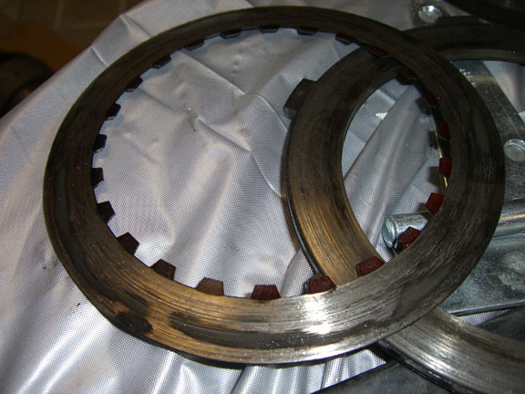

IMHO, get it changed before the drive back. The concoction of friction modifiers between the three different ATF's may lead to your clutch packs slipping way more than they should be.
The last thing you want is this....
