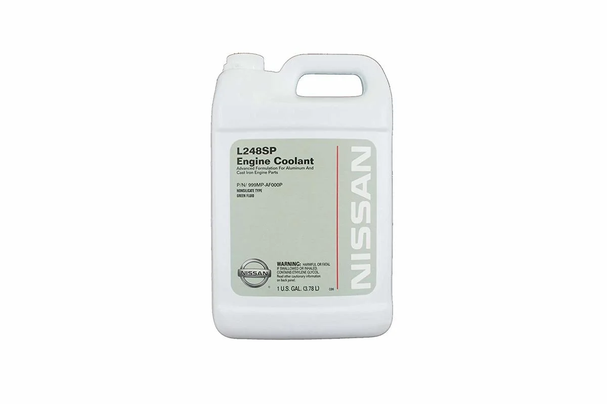

To complicate the discussion even more, I now use Nissan branded dark green coolant in all of my vehicles because each of my vehicles has an aluminum radiator with plastic tank, each has a cast iron block, and each calls for ethylene glycol coolant with HOAT technology. I like to standardize lubricants and fluids whenever possible for the sake of consistency and because it costs less in the long run. I could have standardized with Zerex G-05, and I typically do use Valvoline products, but I already had an unopened gallon of Nissan green coolant leftover from servicing my Xterra so when it came time to change the coolant in the Jeep and the Miata I decided to standardize with green. Besides, I'm old school and my mind expects coolant to be green and not a rainbow of colors that require a guidebook to decipher.
Nissan L248SP Engine Coolant (P/N 999MP-AF00P) is a silicate-free "long life" HOAT coolant that is fully compatible with conventional green coolant should I find myself in the position of needing to add coolant rather than plain water when I am away from home. With my usual discount at the local Nissan dealership's parts counter it costs no more than Zerex at the chain auto parts store.
