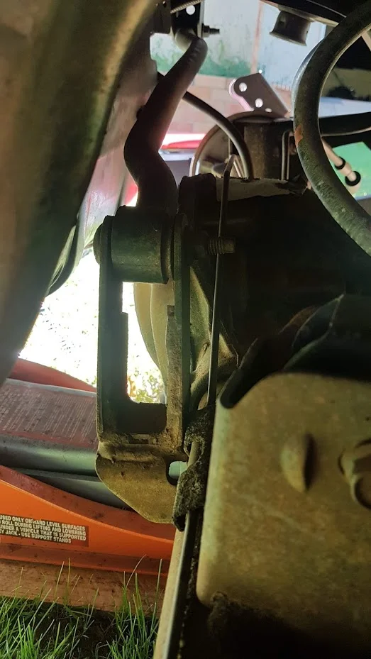

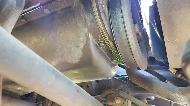

Noticed a leak after flushing and replacing the coolant. After reading up a little determined it was due to failing water pump bearing.

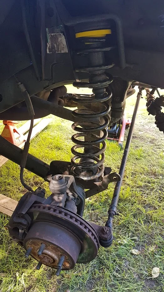

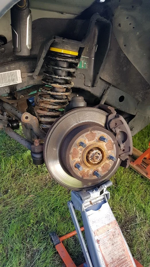

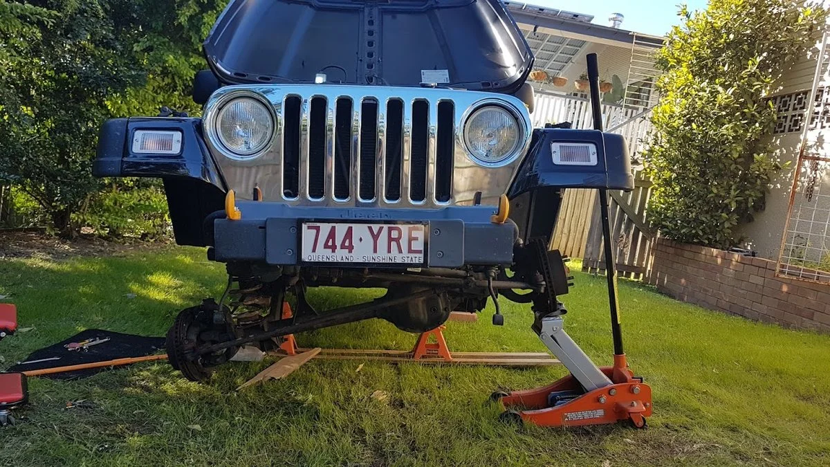

Fortunately it was replaced under a 3rd party warranty. So after acquiring the remaining parts for the 2.5" Old Man Emu lift kit it was time to tackle the job. This is how she sits stock after 150,000kms with 31" tyres on 15" wheels.

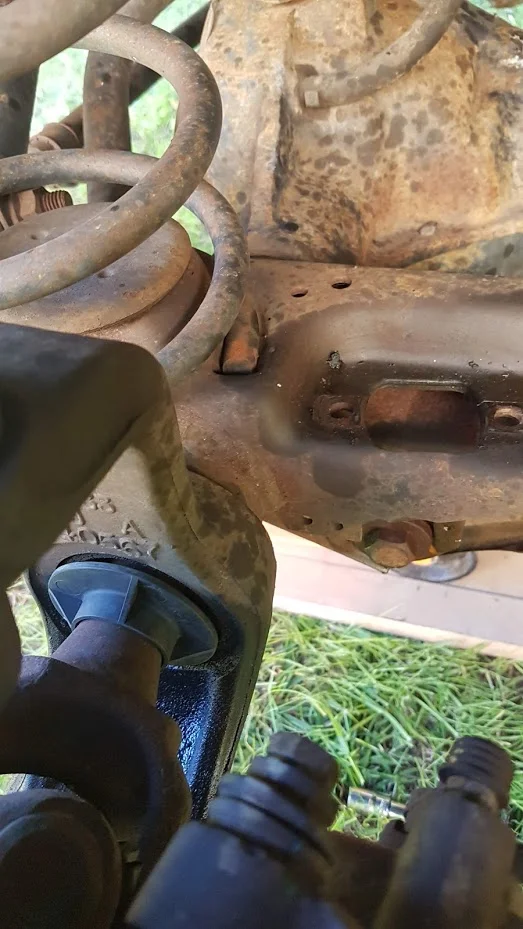

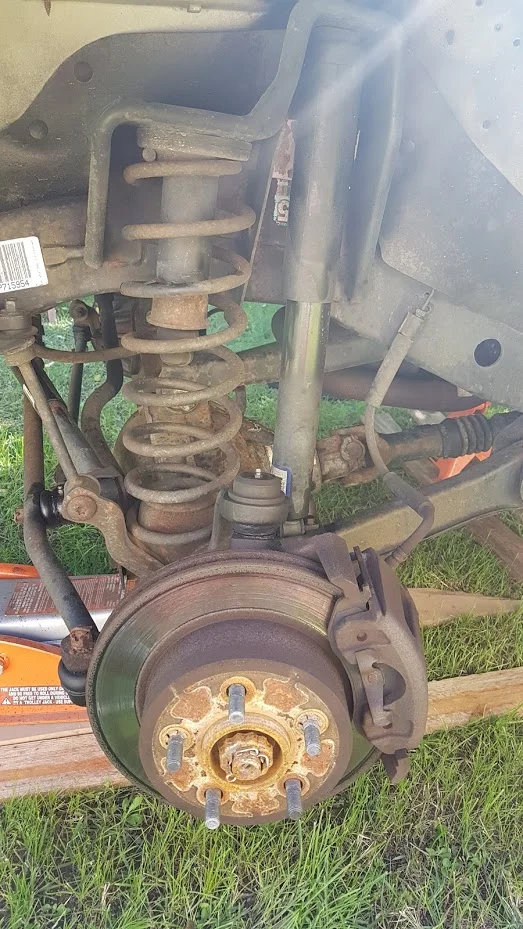

Front end lifted.
Shocks removed.
Getting the opposite side spring seated with some assistance.

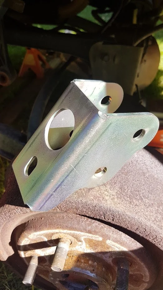

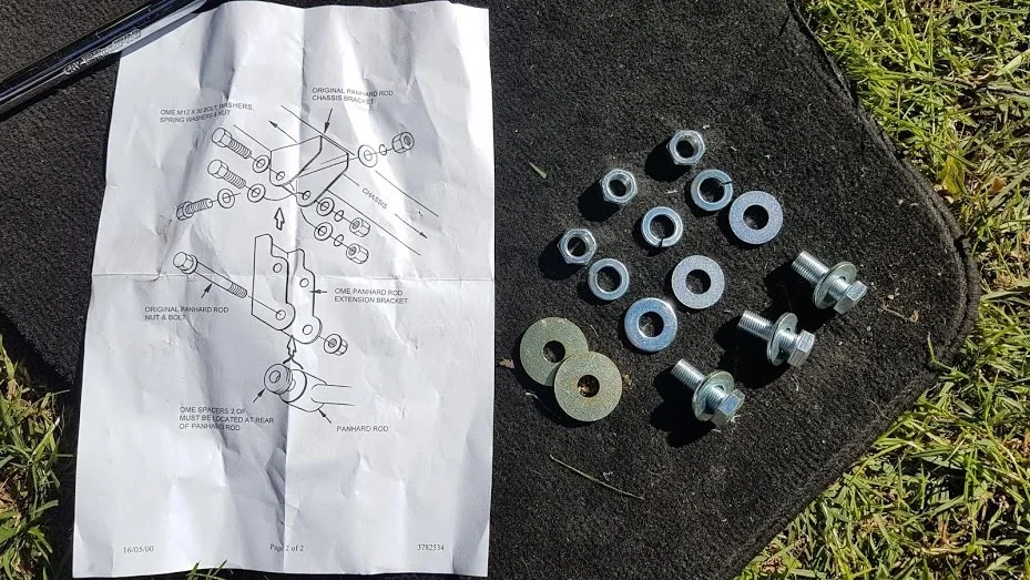

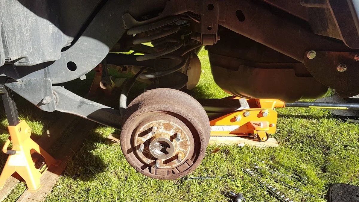

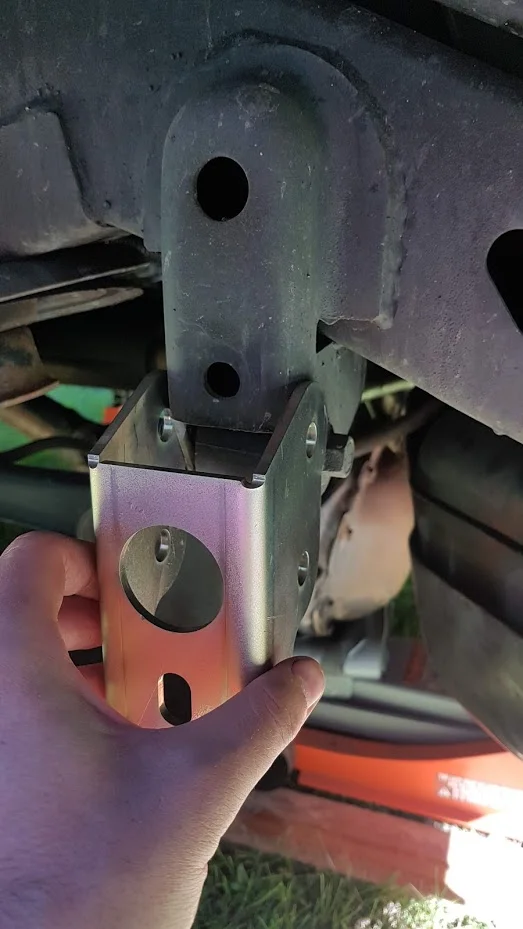

Working on the rear end.

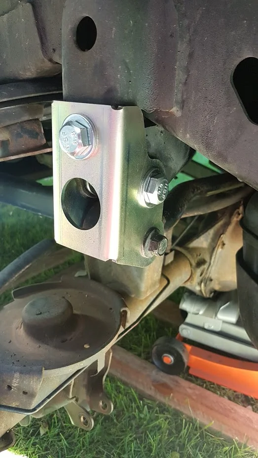

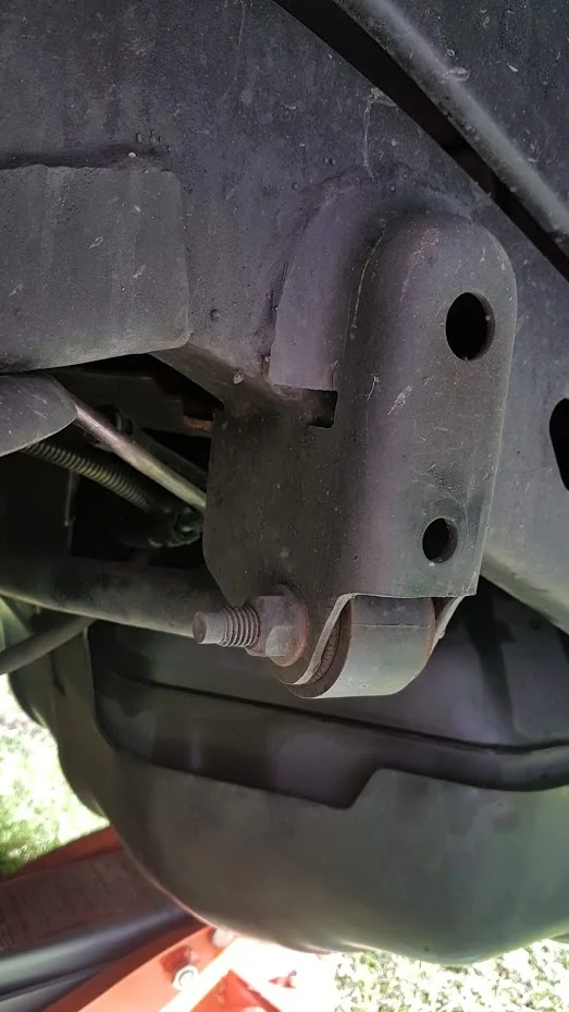

The rear trailing arm bracket extension is located on the chassis end as apposed to the differential end on LHD Jeeps. Making installation much easier.

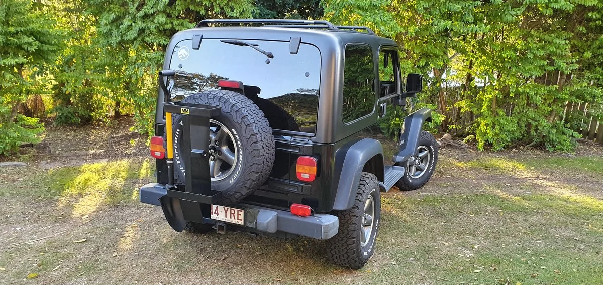

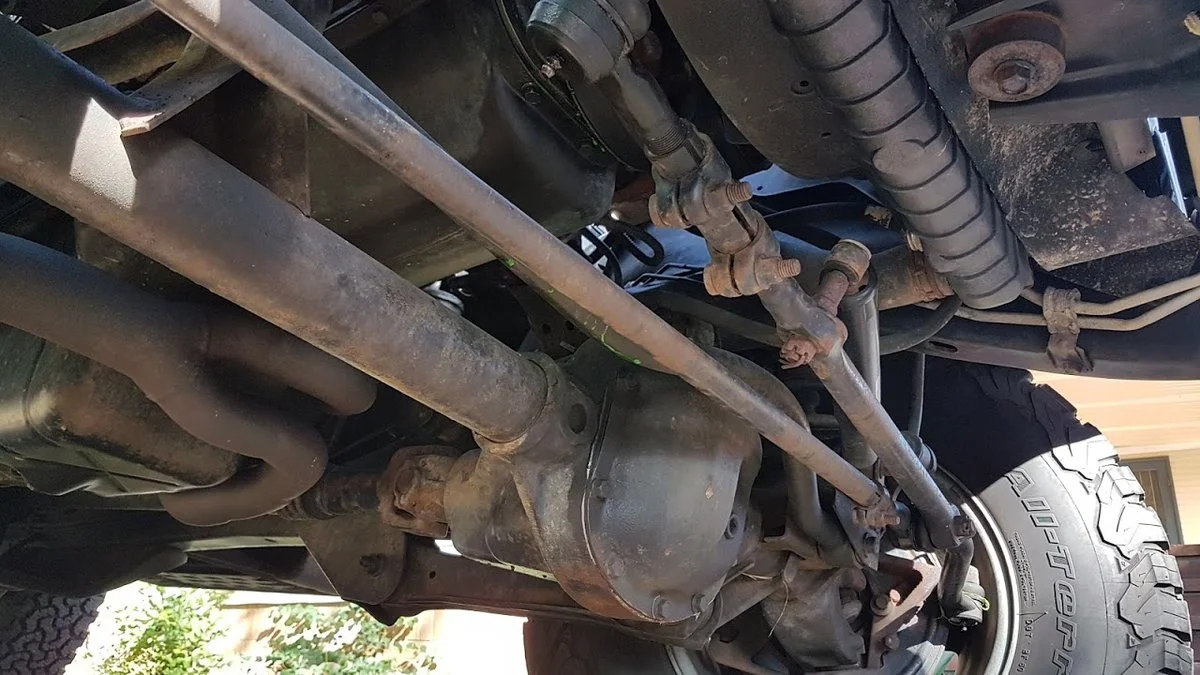

A lot easier than working on the differential end plus no drilling required. That was the completion of the OME 2.5" lift. I'll post some photos when I get the chance along with some measurements before and after. Very happy with the end product although they are pretty much bang on 50mm increase with OME spacers/leveling installed on each spring, they are second hand springs. Will probably look at replacing them in the future to squeeze a little bit more lift. Definitely going to be replacing all shocks and steering dampener with Rancho RS5000 as the OME shocks are toast.
Reactions: TJ Starting
Also worth noting I didn't install the transfer case drop kit yet. I haven't noticed any significant vibrations and that's with the terribly worn shocks.
