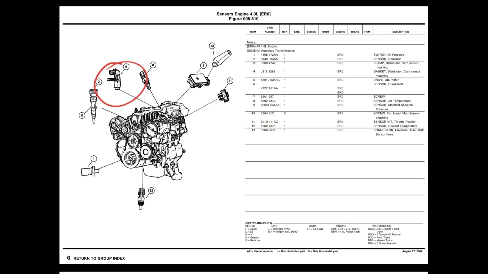

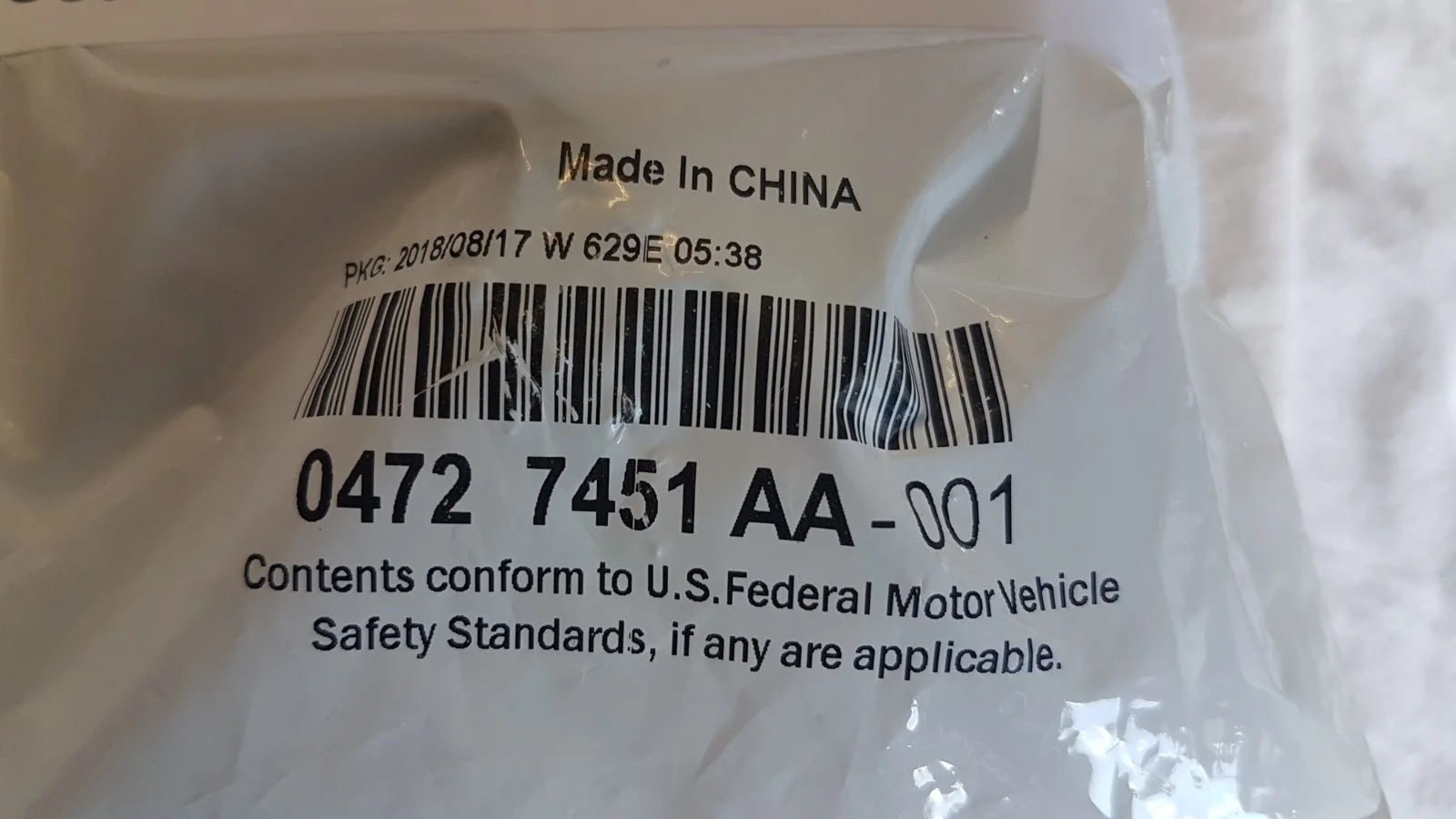

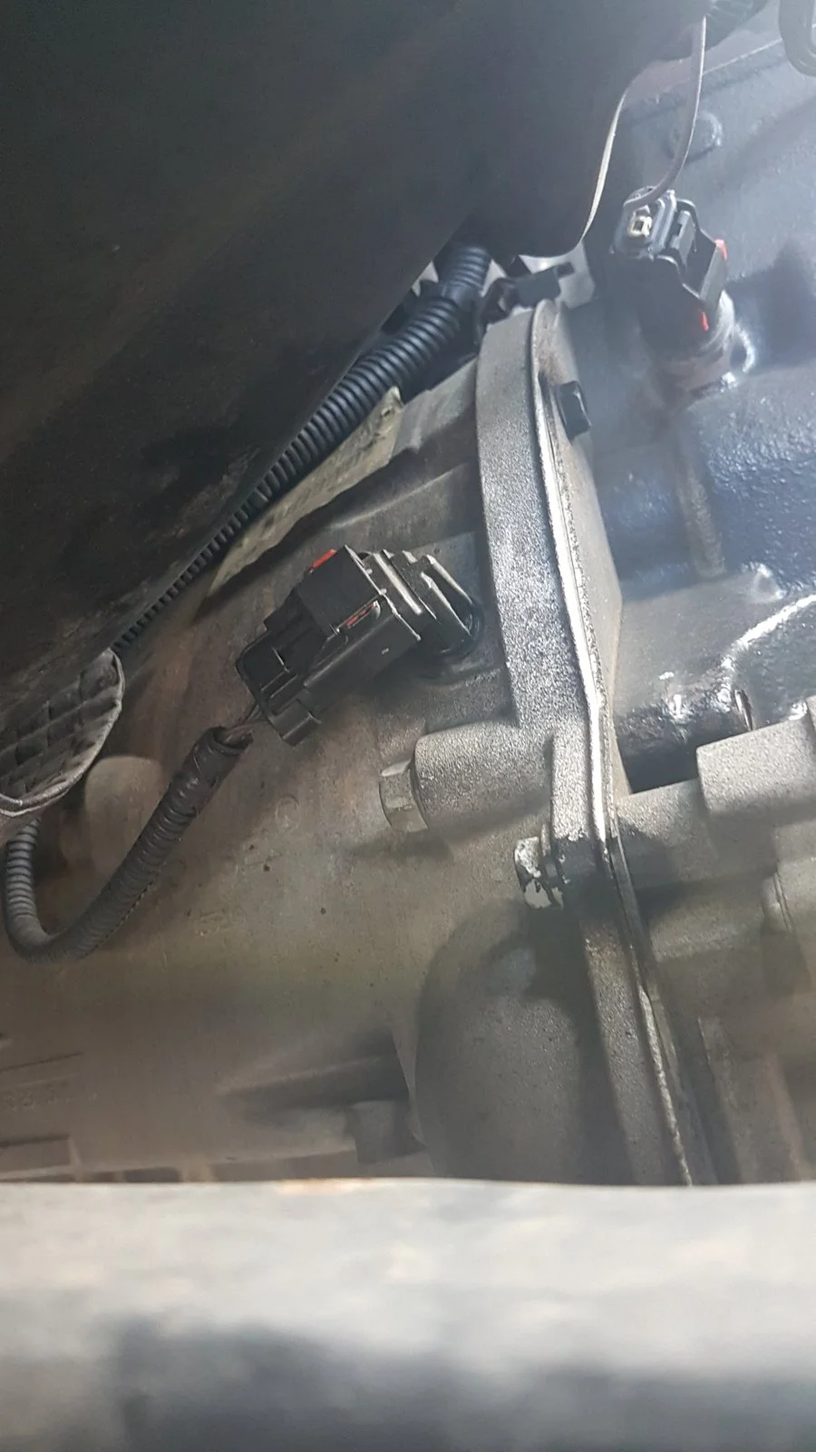

I did pick up my order for a crankshaft position sensor and was hoping it would have included the cardboard spacer as discribed in the service manual. Does anyone know if it is necessary on the later models?
My crankshaft position sensor appears to be in a different position then older models.

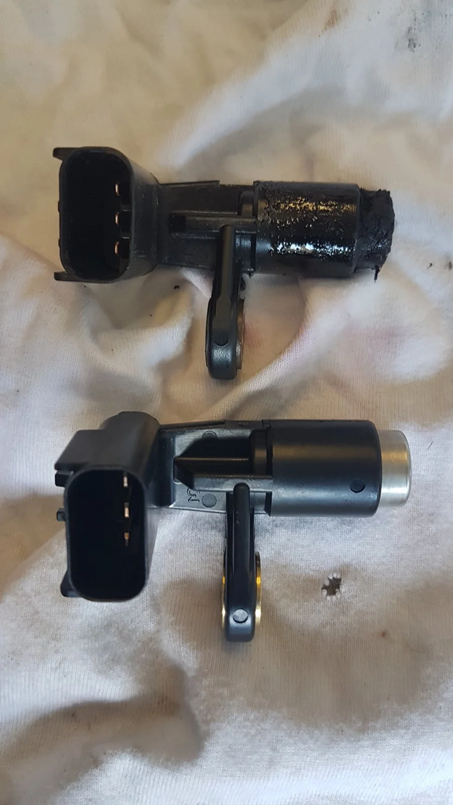

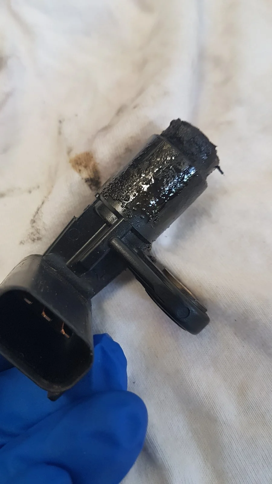

Ok so a little update crankshaft position sensor was replaced with a new one. Genuine mopar part.

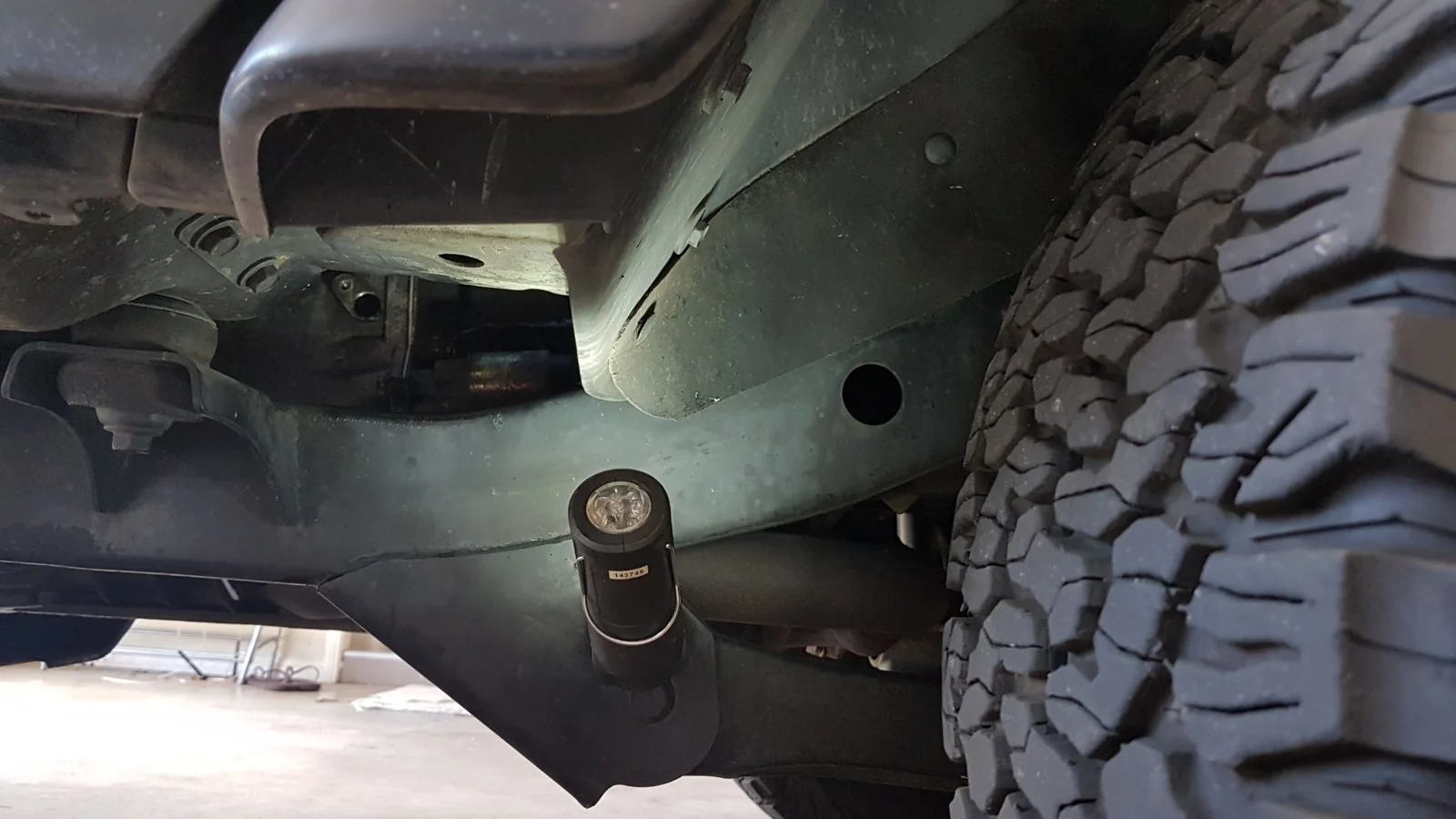

Just so you can see where the crankshaft position sensor is.
Went for a short test drive and the symptoms returned. Driving along and engine stumbled, dropped in rpm as if it were about to stall. Giving it a little throttle and putting the clutch in saves it from stalling. But back to square one :(
