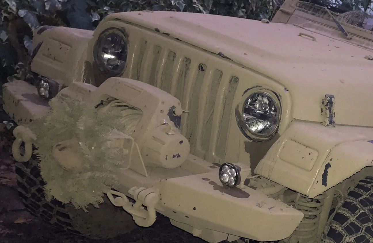

Baja Designs makes great led lights that you could put in place of those stock fog lights. It was a simple swap for me. Super bright too
Factory "fog lights" don't do a bit of good in actual fog. 🤫 I swapped in some $40 LED driving lights with great results. You'll have to splice the wires.
