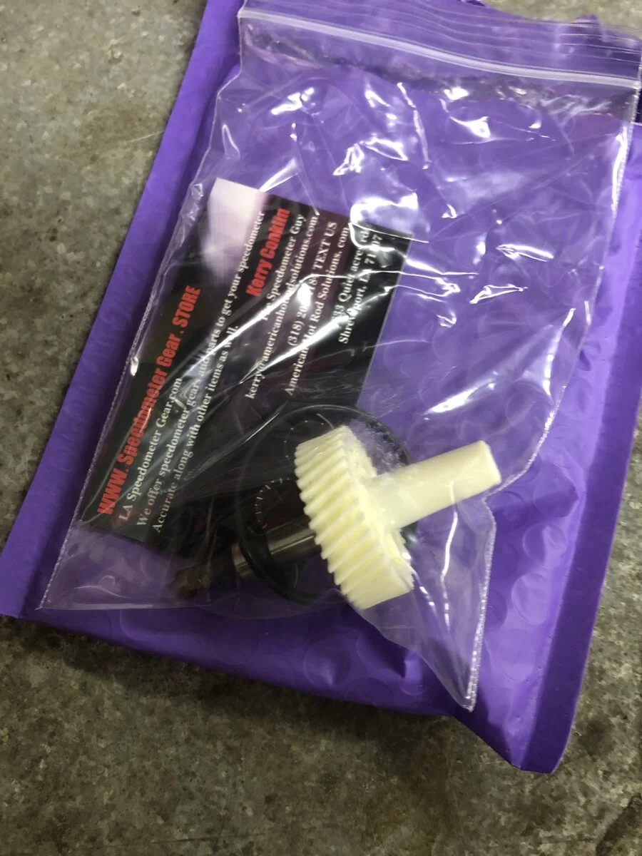

Got the correct speedo gear thanks to the forum
went from 31 to 37, it was way off after the gear change. I will have to get a 35 gear for when I eventually switch to 33x12.5s.

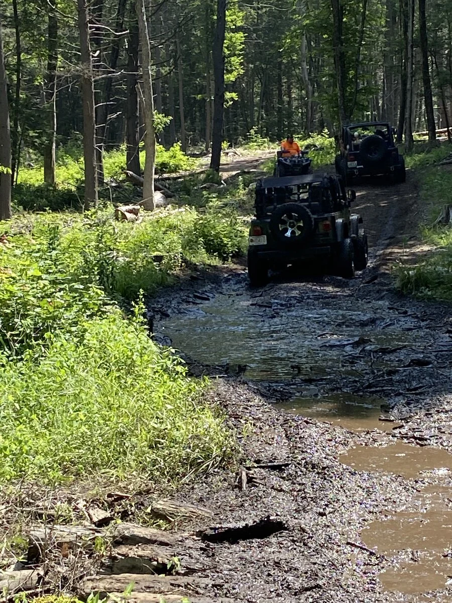

Maiden voyage
Finally got to hit some trails and test out the new suspension and Dana 44.

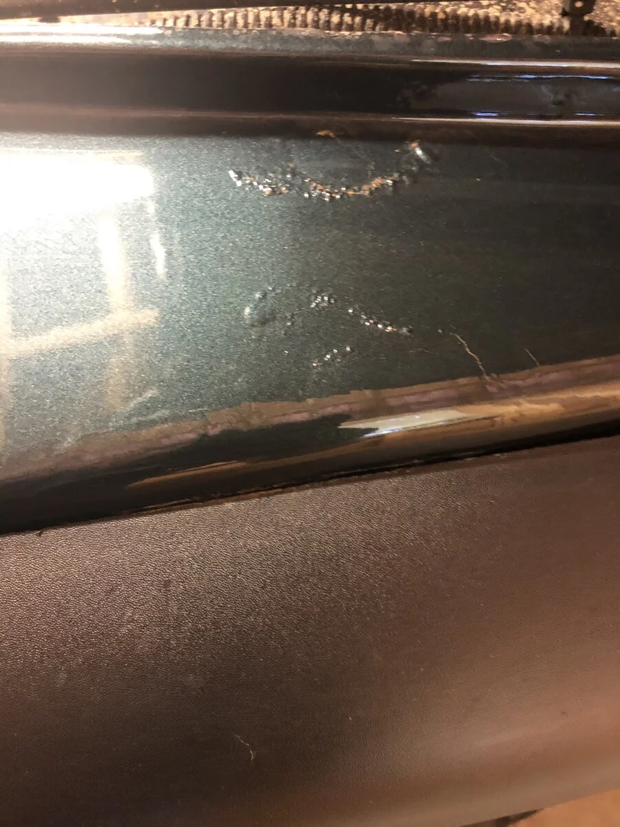

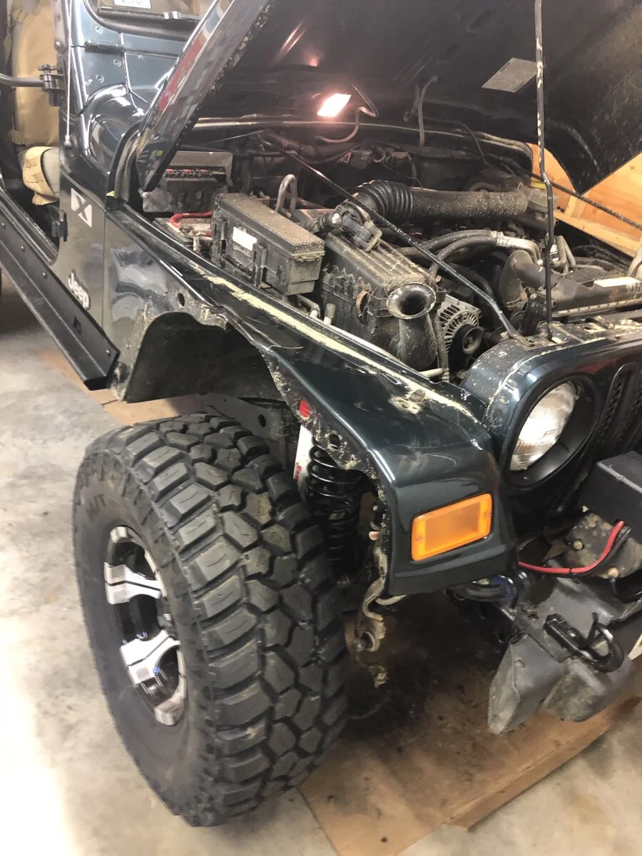

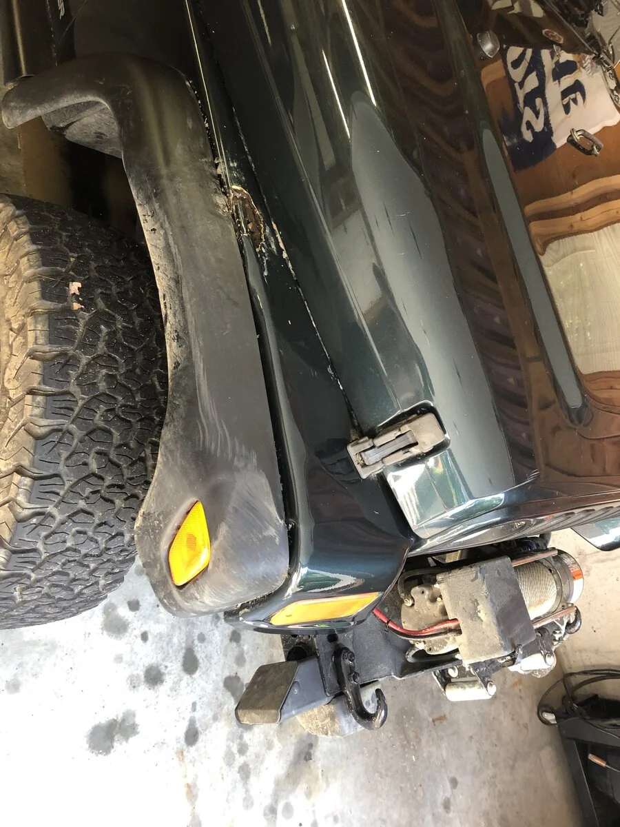

Unfortunately a little trail rash from a tree on a tight turn stuffed my fender. It wouldn't have been so bad if the rot under the paint hadn't blown out.
So it looks like the flat fender install will come earlier than expected. Ordered a set of MCE's for the front.

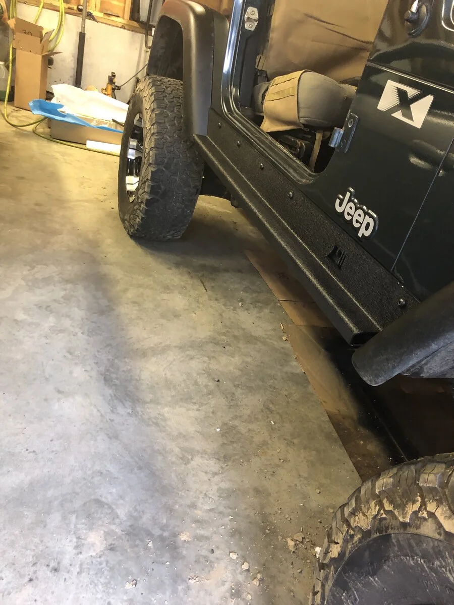

Also realized I need more protection underneath. Ordered some rocker sliders and am looking at engine skid options. M.O.R.E. set up looks pretty good, going to take some measurements.

Was able to get the CB installed and Rugged Ridge Rock Sliders today though.

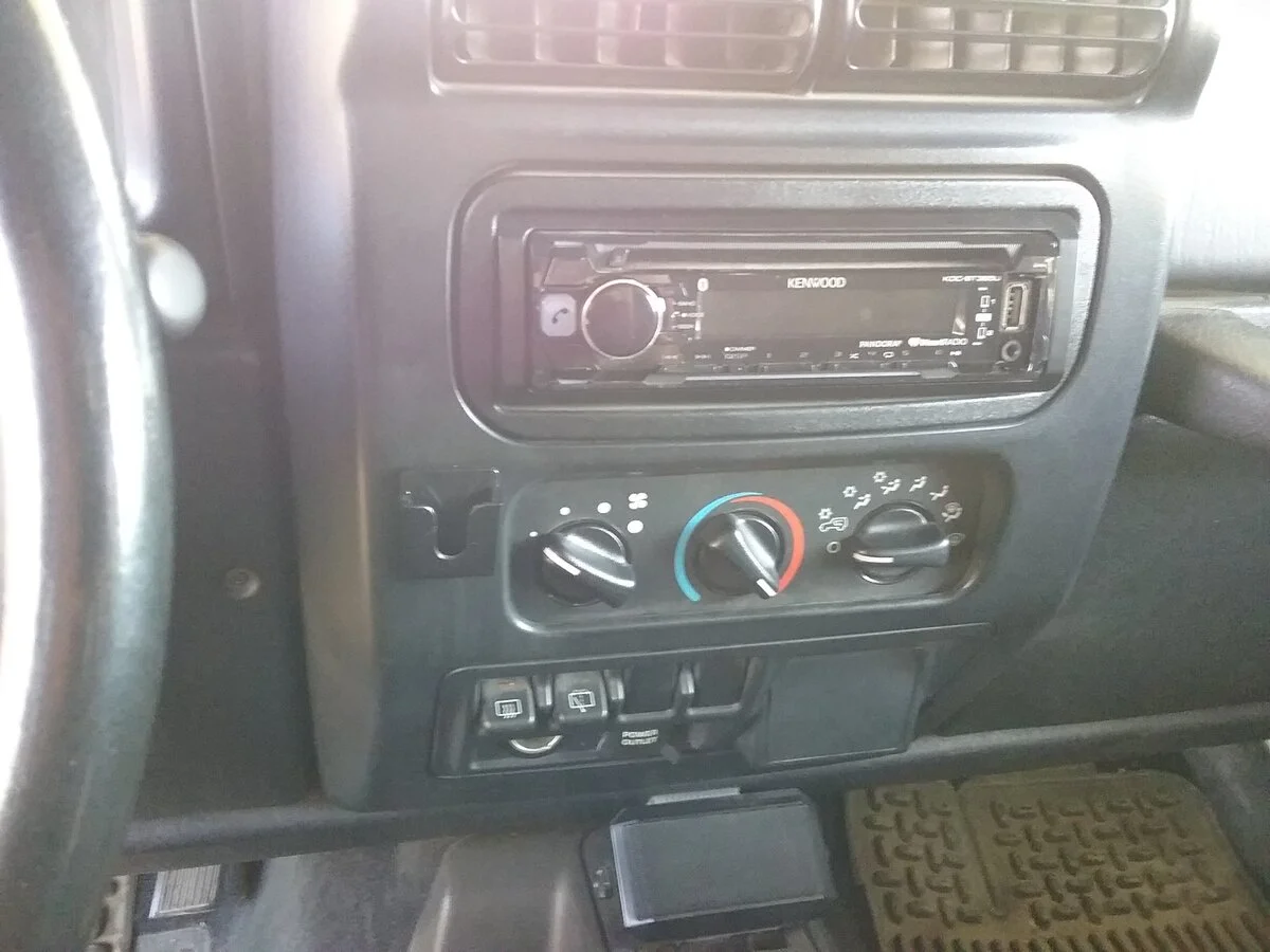

Need to figure out where I am going to mount the Mic clip
I went with these RR ones because they do not use the body/frame mounts, just the tub. They also come with the rubber gasket attached to them to protect the body. They seem pretty heavy duty, are powder coated, and have a nice 2" step bent into them. Install was straight forward, and picked them up from Morris 4x4 (even though I swore I wouldn't go back to them) for only $213 shipped.

I have those same sliders. Been thru the Rubicon twice, and Moab and have taken the hits like a champ!
I bought a cheap plastic stick on mic clip off Amazon and stuck mine here.
You could easily stick it on the right side to keep your cord out of the way of the shifter.

Is that just a "stick on" clip? no screws? the one I have uses screws so I was a little hesitant to drill into trim. I wanted to put it in the square to the right of the switches but I do think it will interfere with 3rd &5th gear.
Yep, just a stick on. The tape that came with it didn't last long, so I cleaned the back of it and attached some good 3M automotive double sided tape on the back. Has held up fine so far.

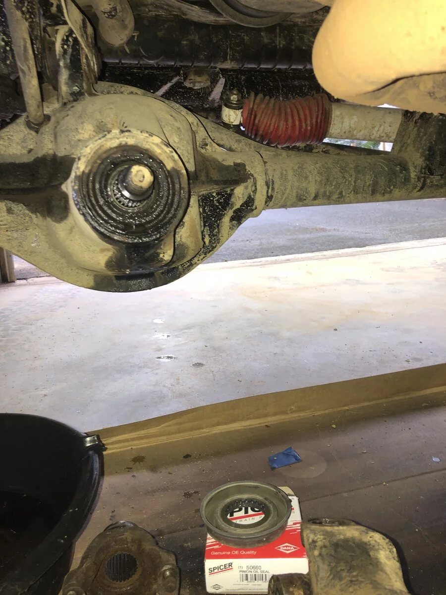

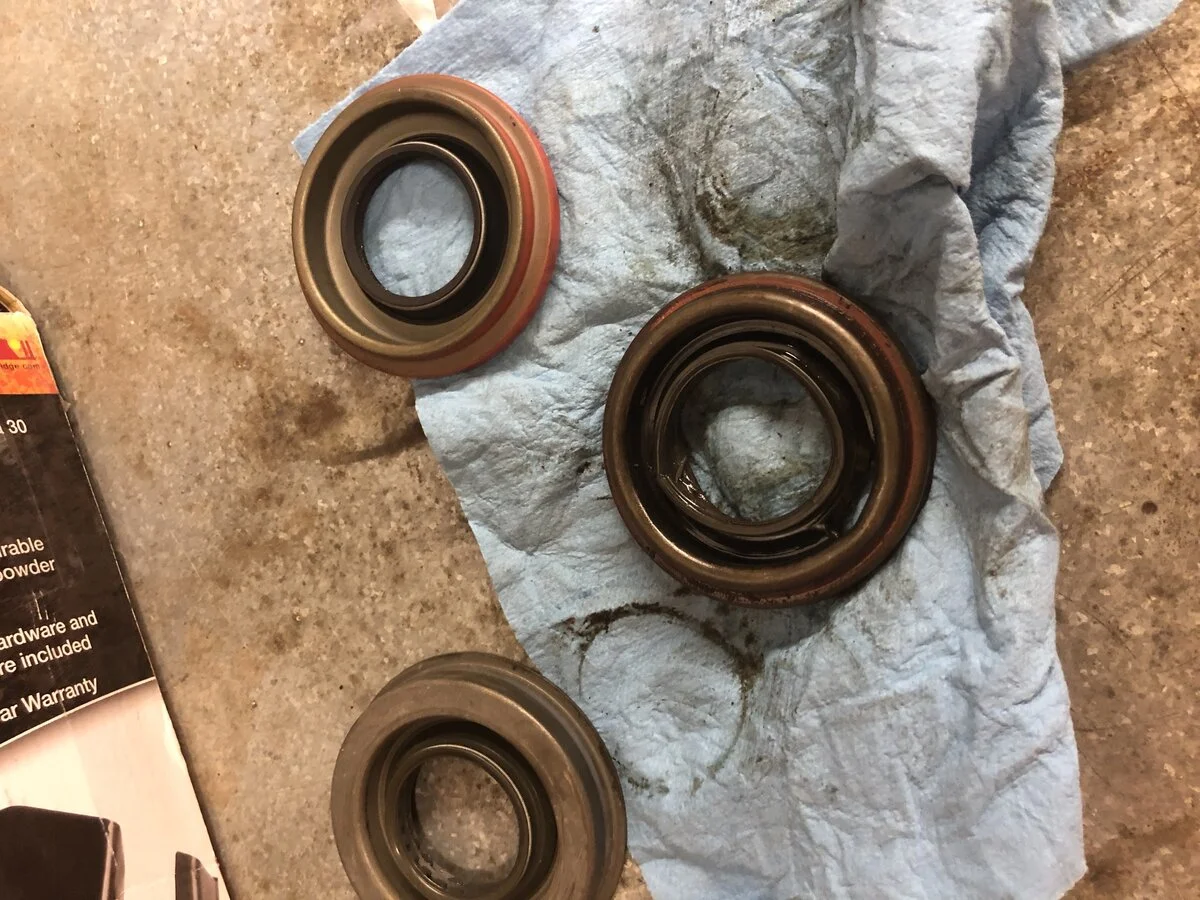

Replaced the leaking front pinion seal on the Dana 30 today and added a Skid for the front. Ran into an issue with the seal I ordered not fitting, luckily I found one at a local shop. I never found out the year of the used Dana 30 I got so I took an educated guess at the seal.
The back of the seal on my Dana 30 has ridges, whereas the spicer one I ordered is flat in the back. All good now.
This will at least give me peace of mind for the front, still need to figure out what to use for the Dana 44. I like the glide style skids from Rancho that bolt underneath the rear diff but there like $150 vs the $40 I paid for the front.

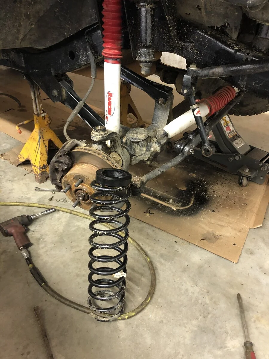

.75 front coil spacers to level the front after the winch weighed it down:

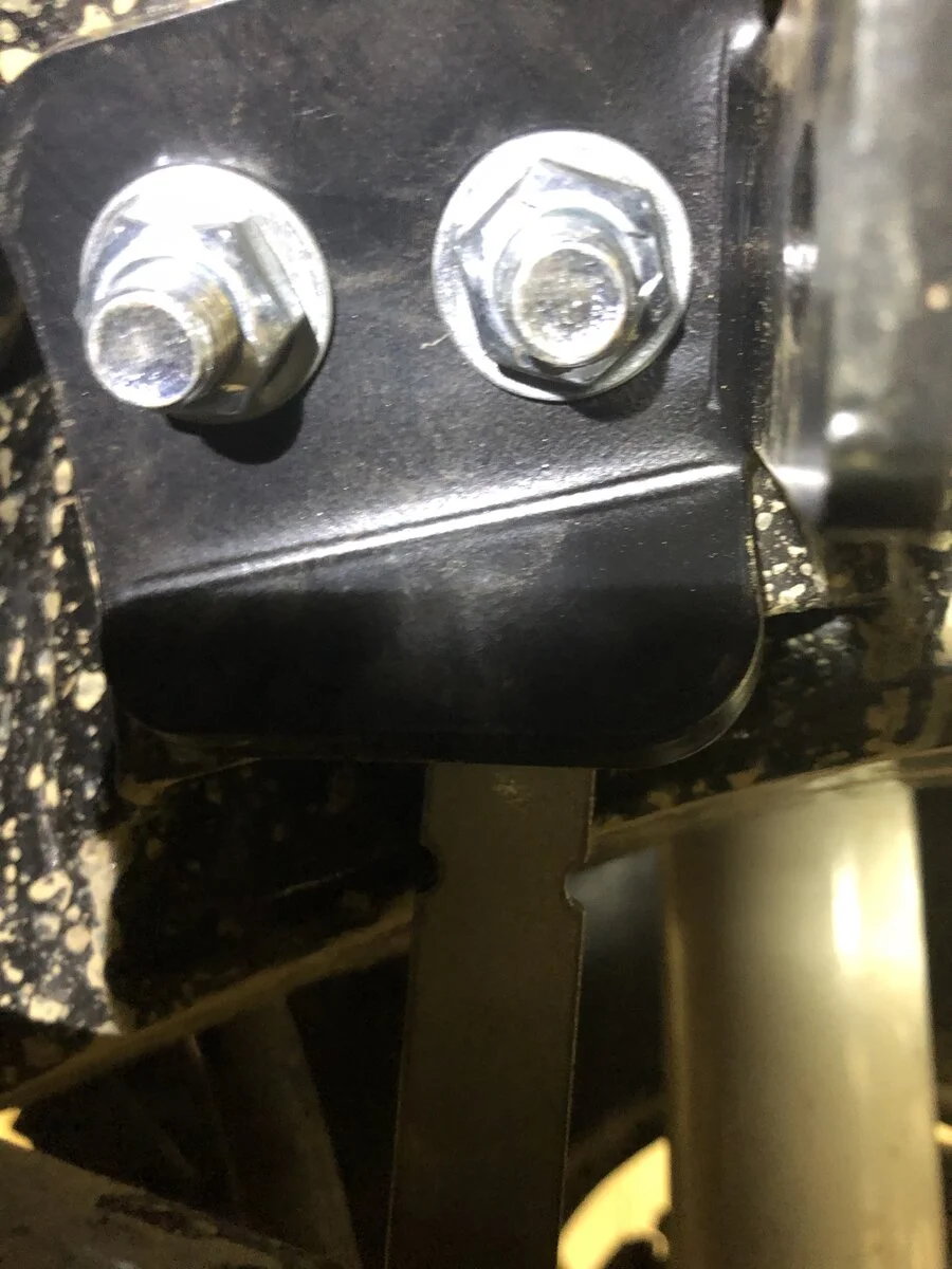

Here is the Mountain Off-Road Enterprises Engine Skid Install:
These brackets go on the frame horns just below the motor mounts. They give you a little wrench that you can bend as needed to hold the bolt heads behind it.
Used a magnet to pull the bolts through:
The Y-brace in the front then bolts right on to those:
The hardest part was drilling through the RC skid plate for the rear bolts. I think these engine skids are designed to work with the factory skid, and anything else has to be drilled.
This is a nice, heavy duty skid though. Definitely will give some peace of mind sliding over rocks.

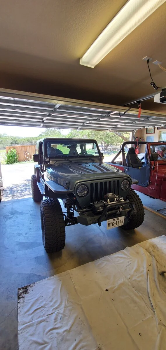

I am much happier with the 33s with this 4.10 gearing. The chart in the resources forum says that 31s are the matching size for 4.10s and the NSG370 6speed, but I was shifting to 4th before 30 mph. I felt like I was driving a semi truck. For 33s the chart says 4.56s, but I think its perfect now, I am able to ride out each of the gears a little more.

MCE fenders came in. Today was just the front install and JK turn signals. I was eager to get the rusted/duct tape fender off.
The Jigsaw with the metal blade was a great tool for this. No other body panels on my TJ have rust/rot like these front fenders did. They both had it bubbling under the paint right over the wheel where the fender has 2 layers. Poor design flaw just traps the moisture in-between the layers and rots out.
Here is the passenger side.
Here is the new 4.5" MCE front fenders:
I used Jerry's technique of slotting the JK lights:
Tomorrow I will get the Rear MCE fenders and hopefully the MOR/ryde Tailgate reinforcement kit.
