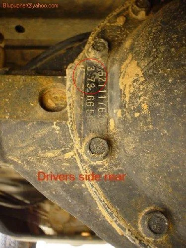

Can someone confirm my axle gear ratio? I think it is a 3.73 but not certain. Its a1999 TJ, Dana 30. I need to order parts.
The rear is stamped with the following
5211 1032 AE
73 808546
Check for the axle ratio stamped into this tag at the 9 o'clock position of the differential cover. This one is indicating 3.73.
