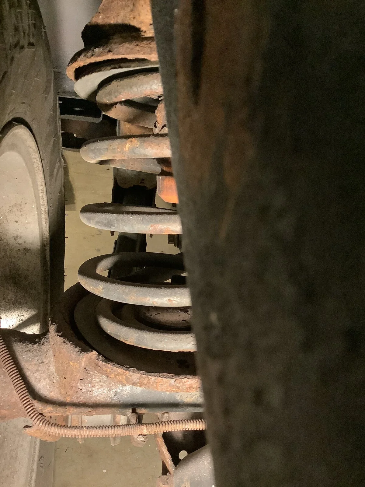

I just so happen to have my rear coil out today.
The bottom isolator is a thin hard plastic with three tabs. It was very brittle and broke into a bunch of pieces when I tried to remove it.
The top piece is a rubber/foam material and 6mm thick with no tabs.
Moog K160060 $20 ...This looks to be a set of the top one AND the bottom one. So order two sets and you got all the correct isolators for the rear.
Confirmed! Seems to match the factory pieces. I have not installed yet but pleased so far.
