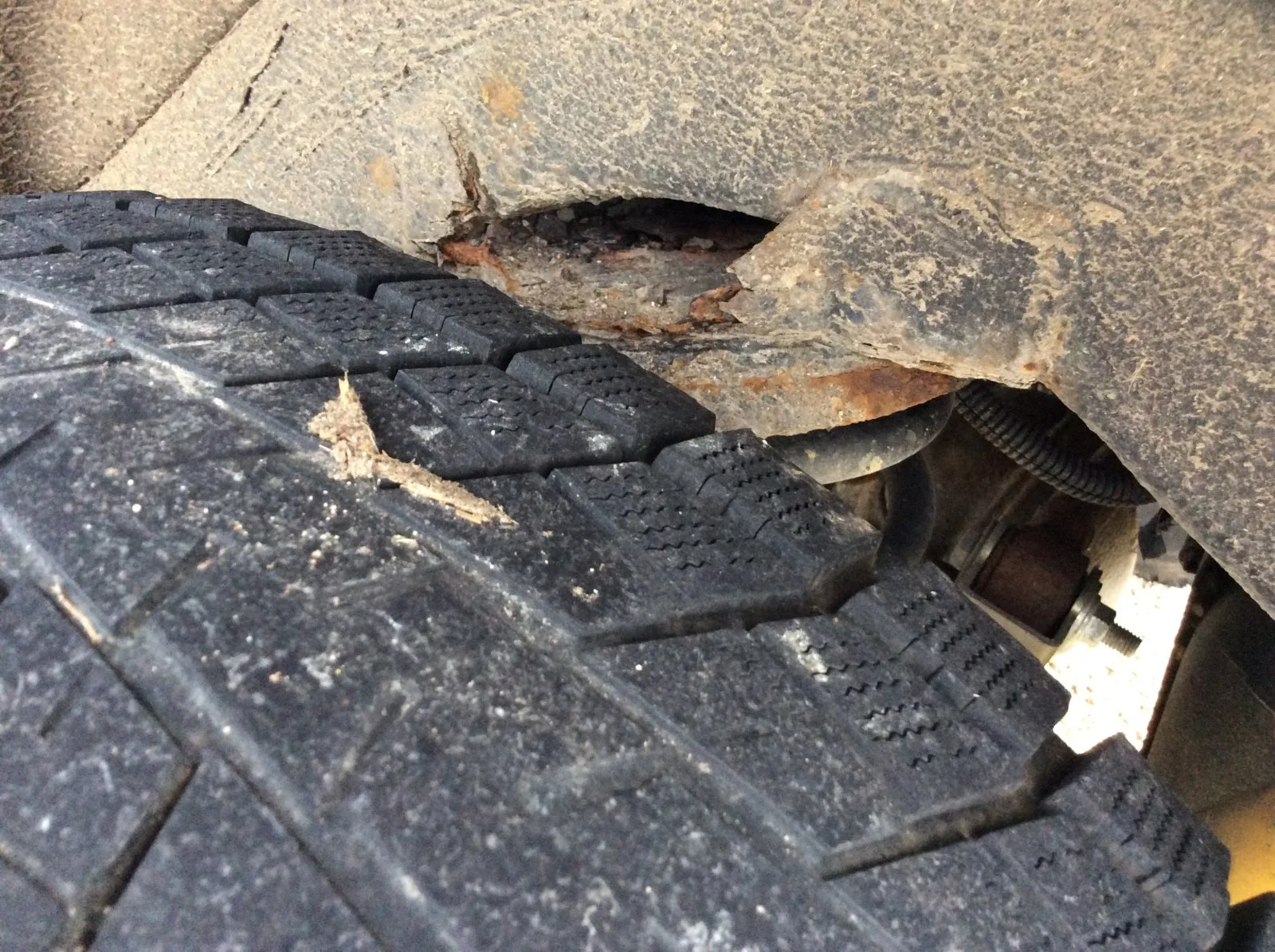

I'm not sure what the back inboard tabs are. But I do know that when I was underneath my jeep before purchasing it, I found that besides the fact that the frame was extensively but thoroughly plated, reinforced and painted, the only notable rust was on the mounts themselves. I think. See pics.
I'll admit, I found it strange that since the PO bought it with a rusted frame from the Manheim auto auction with the intent to fix the frame and flip it, that he didn't address the upper coil perches. At least I noticed and was able to get the price down.
View attachment 96257View attachment 96258
If you look at the mount, it has two tabs that come up on the outside of the frame at the front and back of the perch. They are matched exactly by a pair on the inside of the frame. The back tab on the inside is blocked by the bottom of the tub so the tub has to be raised to cut it loose from the frame. You can hack it as high as you can reach and run the perch with 3 tabs but that is a hack way to do it.
Ah okay, that makes sense. I'll have to get under there and check it out later today if I can. If that tab is also compromised and I'm insistent on doing a proper job, any idea how much more time I'd be looking at for them to raise the tub to address that tab?
