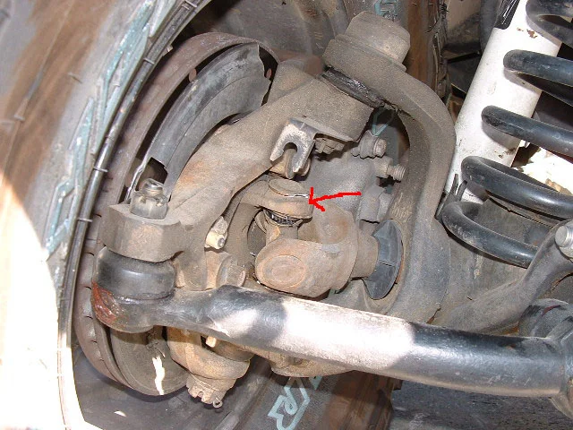

The pinion isn't the problem when you get to larger tire sizes like 35's, it's the axle shaft ears that hold the axleshaft u-joints. Replacing the front axle shafts with 4340 shafts like from Revolution Gear is strongly recommended for 35's and a locker. Once I did that with mine no more breakages even on very tough rock crawling trails.
My Dana 30's factory stub shaft ears cracked/broke with 35's and a locker.
