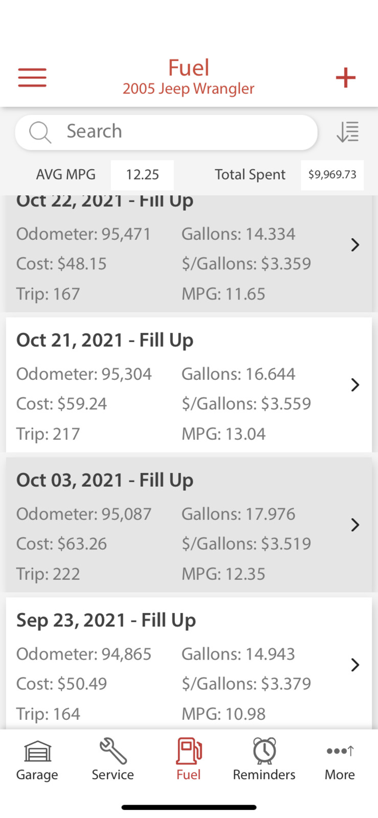

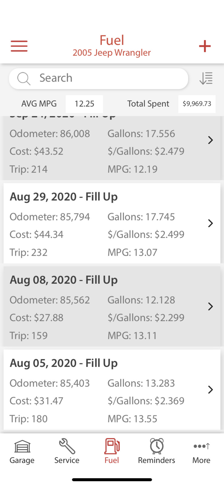

It could be your gearing with those larger than stock tires and if you didn’t change the speedo then your mileage and speedometer gauges are wrong and you’re traveling farther than they read. Look what happened when I changed from 33’s to 35’s with 4.56 gears with a proper speedo.
33’s
35’s

What app is this one? Seems interesting.
