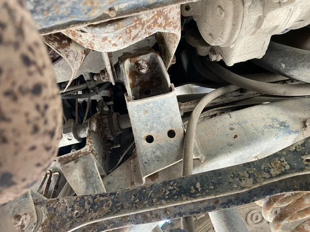

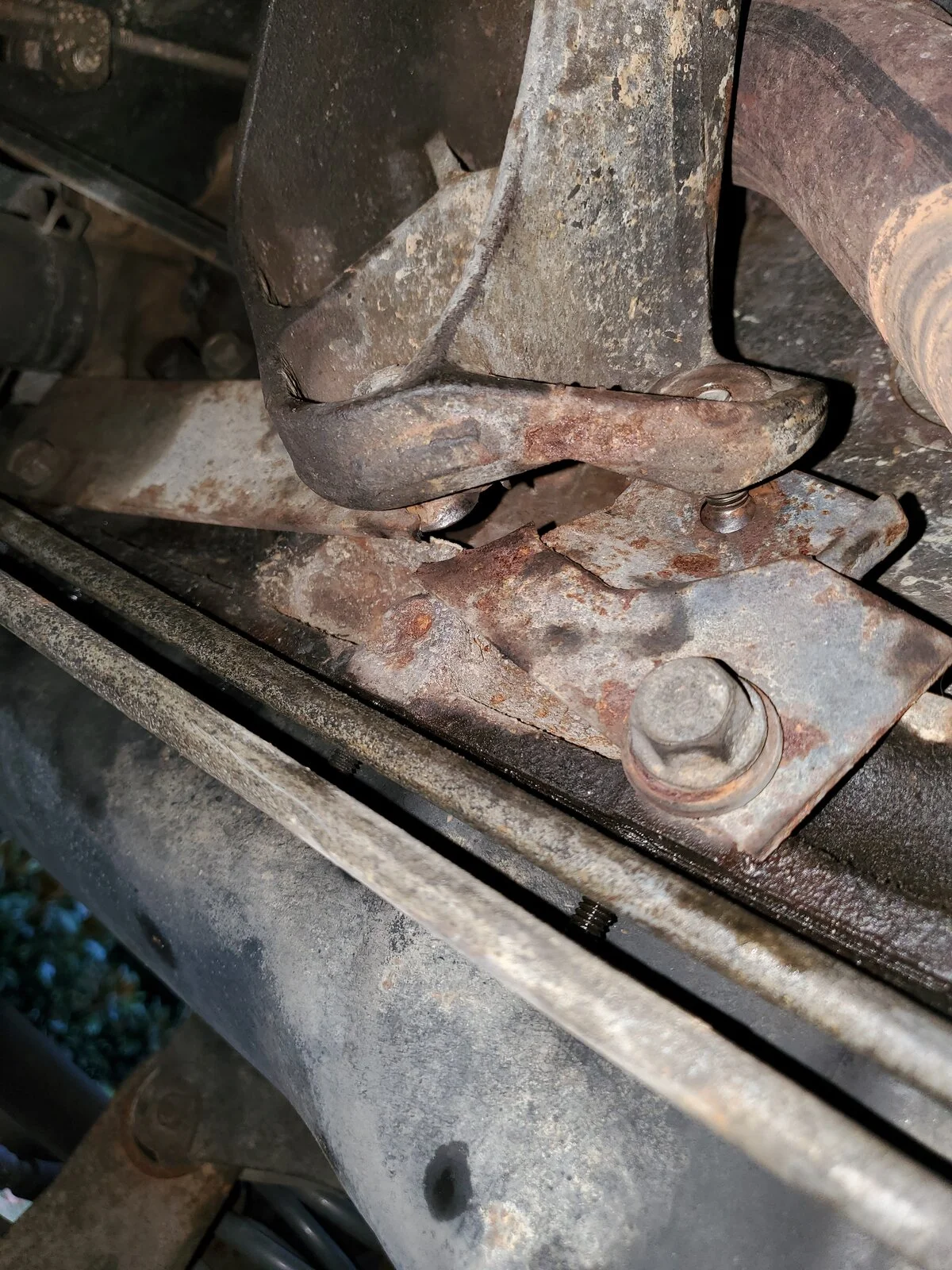

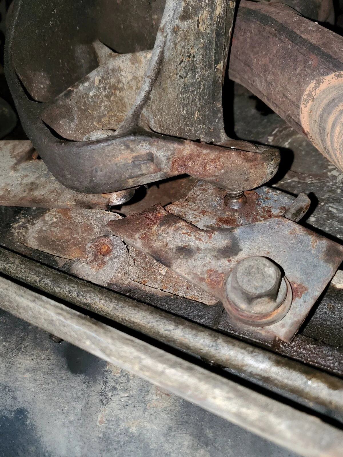

I had my two oldest boys up on top of a mountain at the beginning of August heading off to do some backpacking when about 3/4 mile from the trail head the passenger side mount snapped off at the block. The engine fell over and pushed the exhaust pipe into the front driveline. The kicker was that I had seen a polished ring around the driveline when I bought the Jeep and was puzzling over what had made it. It all became clear in that moment; so this had happened before. I think I had been driving around on one bolt in the mount to the block for a year and it finally gave up after 10 miles of washboard. I used a borrowed ratchet strap to limp the rest of the way to the trailhead and left it for the night. We just got it back yesterday from the shop that towed it out. He confirmed that it looked like two of the bolts had been broken for a while. I guess I too wonder how common breakages of this nature are and what can be done to stay ahead of the problem short of just going to Brown Dog or the like.
