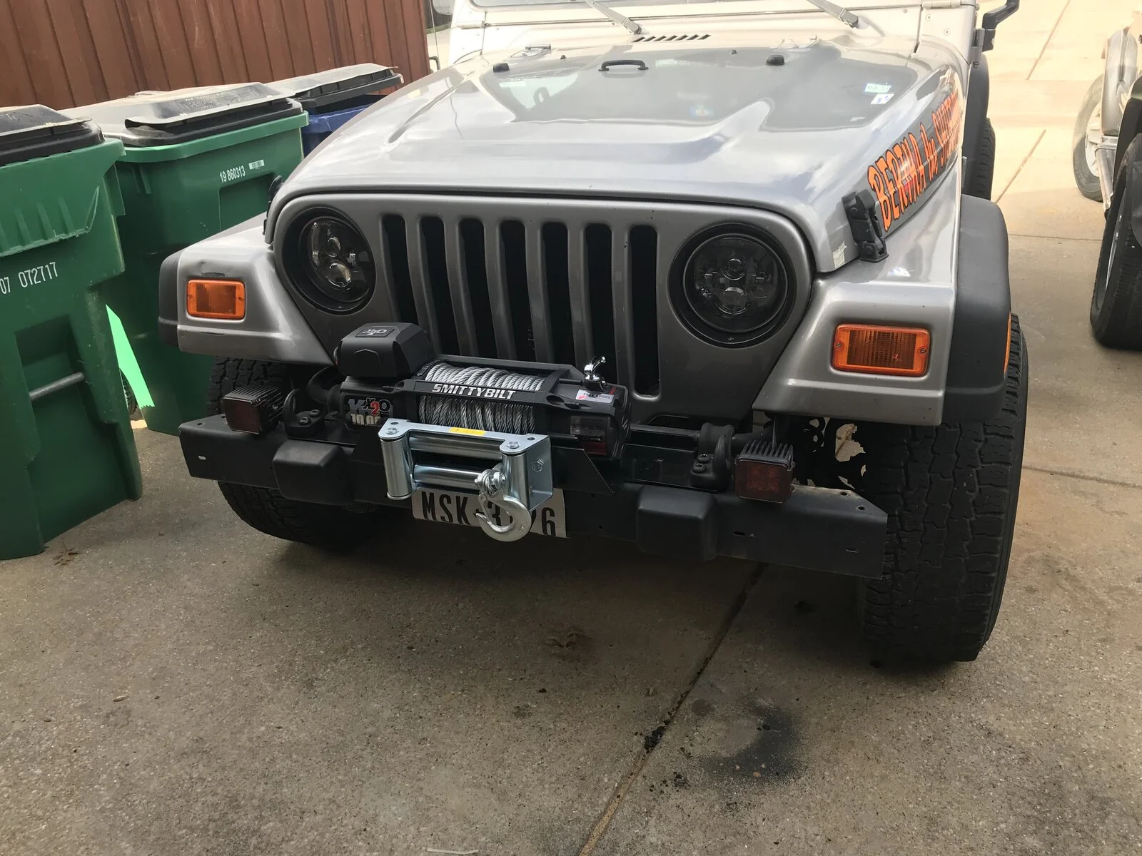

A winch plate bolts to the frame, and your winch on top of that. Assuming the HF bolt pattern is the standard 10x4.5" then something as simple as the rough country winch plate would suit your needs and fit the stock bumper.
https://rover.ebay.com/rover/1/711-...0001&campid=5337789113&icep_item=383802849870
Stock bumper with an RC plate.

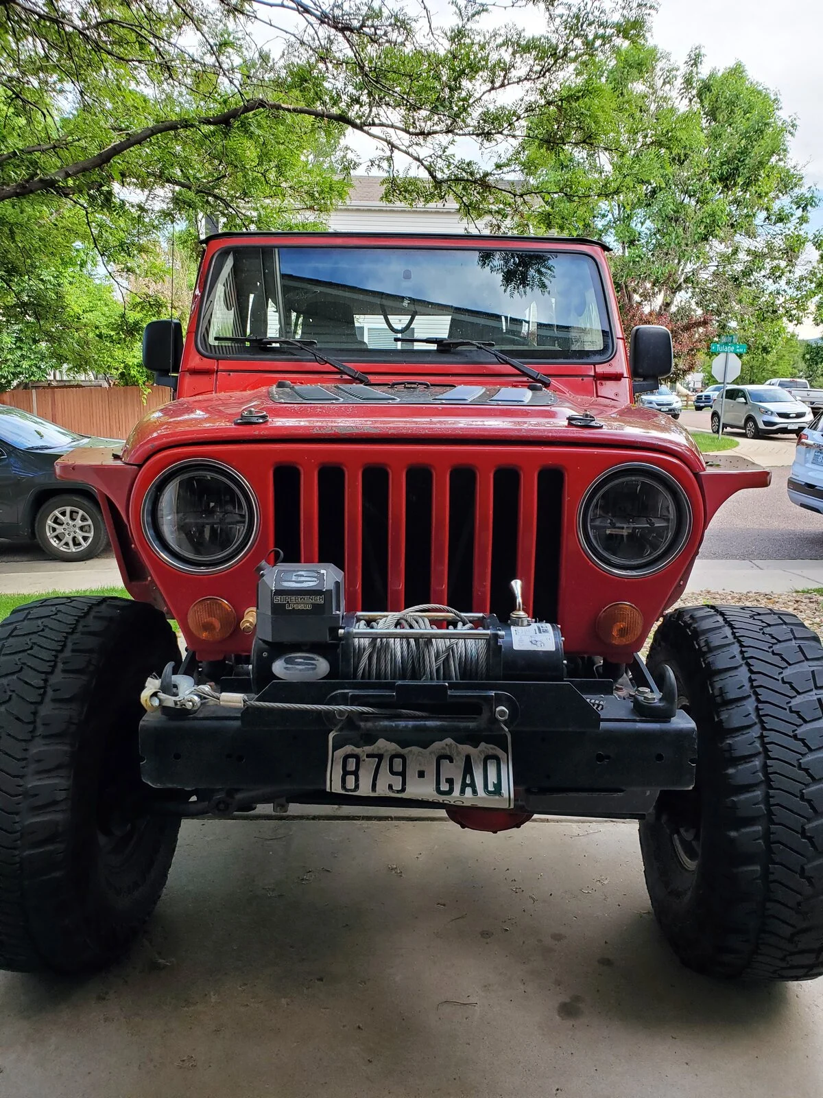

I picked up a X20 (was 330 when I bought it) works well, no problems so far. Been through a few rain storms and some street pulls (cycle the winch at least once a month to Jeep things from sticking up) mounted it on the stock bumper with a flat plate from @Ephry73 (RC I think but it doesn’t really matter, it’s just plate steel)
I like the look, and for me it works great 5year electric warranty and lifetime mech. Waterproof to. It’s no warn, but it’s got the APEX beat IMO
(you can also mount the Control box above the drum if you like that look)

I have the X20 in 12k# I am moving the control box to the engine bay just because.
Looking good!!
