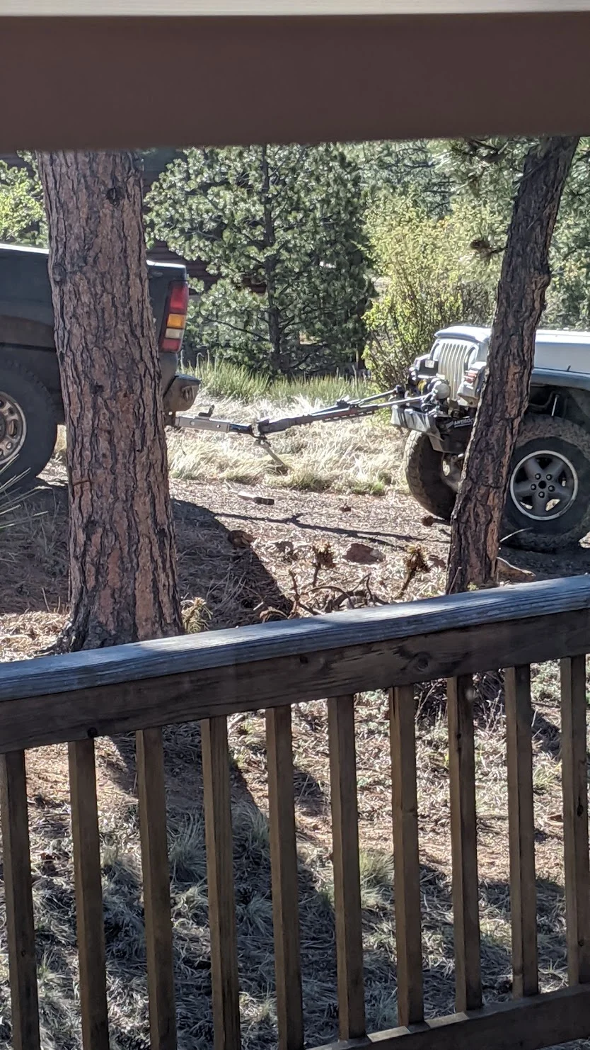

I do already have a tow bar that I think is exactly what I want as well

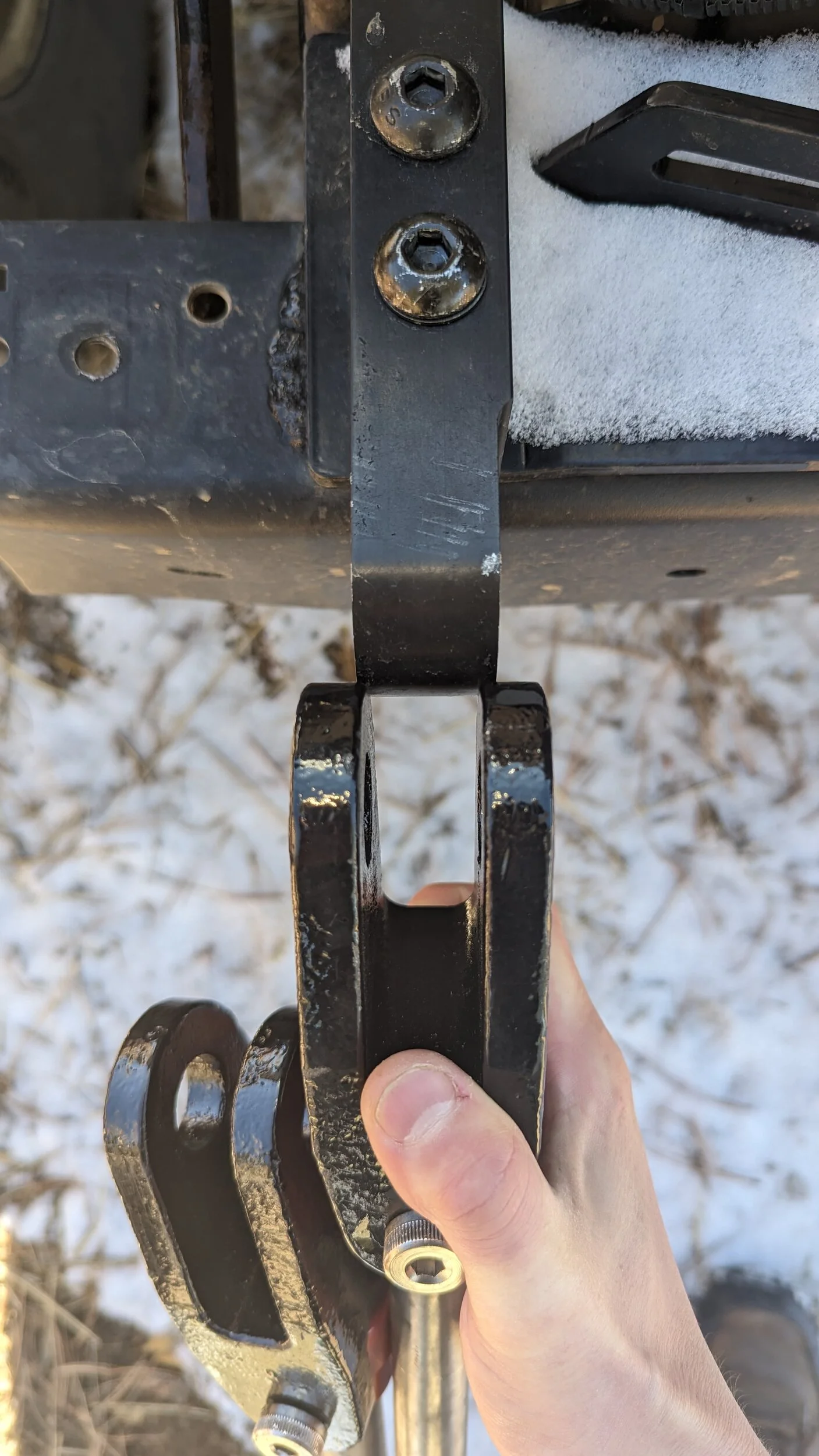

The D ring adapter from RoadMaster are too small for the mount from MetalCloak.
I'm planning on just grinding the bumper mounted brackets a bit thinner. Would there be problems on using them for winch pulls if I made them a little thinner?

This amazon one is the one I have, for 1" thick D-ring mounts. Do appreciate the help, these are all the blue ox/roadmaster ones I was mentioning though.
The blue ox ones are designed for 7/8" thick d-ring tabs, so they're even smaller. Seems like the metalcloak thing is wider than a traditional tab?

How wide is the metalcloak mount?
Just to make sure I'm understanding the Metalcloak tow points are wider than 1"? If that's the case I wonder if you could take them to a machine shop and have them trimmed down to 1" width up to the point where they meet the bumper? Necked down I think would be a little stronger.
Turns out I can't read, I went and measured and the metalclock tow points are 1", I was wrong on which adapters I had. That's the easiest solution at least
COOL glad you got it figured out and it was something EASY.... Been down that other road before and it's always a PITA trying to get things to work together.

Yep! It felt like something was off since these tow brackets used to be advertised as being for flat towing
