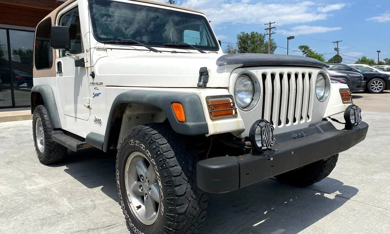

Starting from a pretty clean (if heavily used) slate. Stock photo from the dealer when I got it at 194k, 4.0, 5spd:

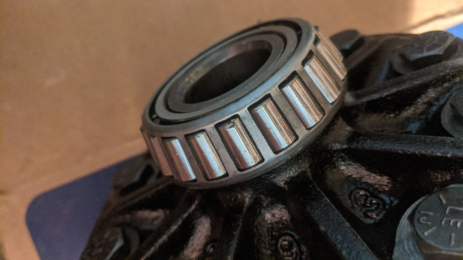

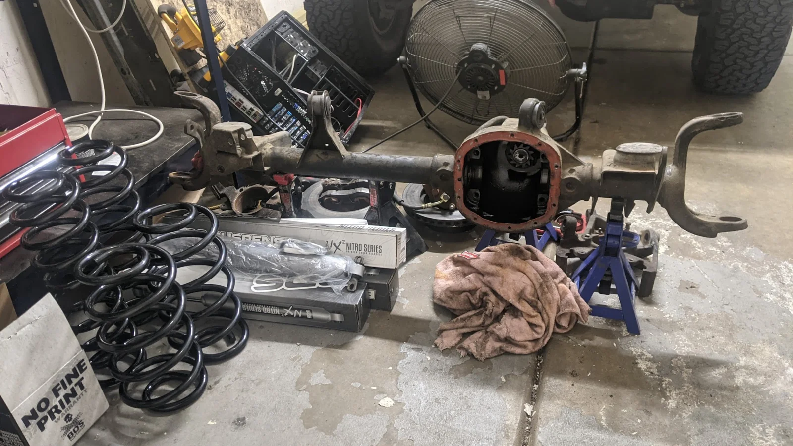

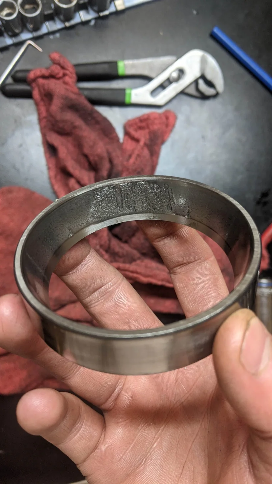

As well as a HP Dana 30 I picked up for 200$ with 136k, end to end. I originally planned on regearing since my carrier gears/bearing races in my LP Dana 30 look like this (screwed, as far as I can tell):
I know I was asking about gears recently and I appreciate the advice I was given for sure. But I guess I balked at the idea of spending 2-4k on axles (the jeep was only 5k...) when I wasn't sure how "committed" I was to wheeling yet. So a 200$ axle with way less miles is a good stopgap while I think that one over - and a slight upgrade at least.

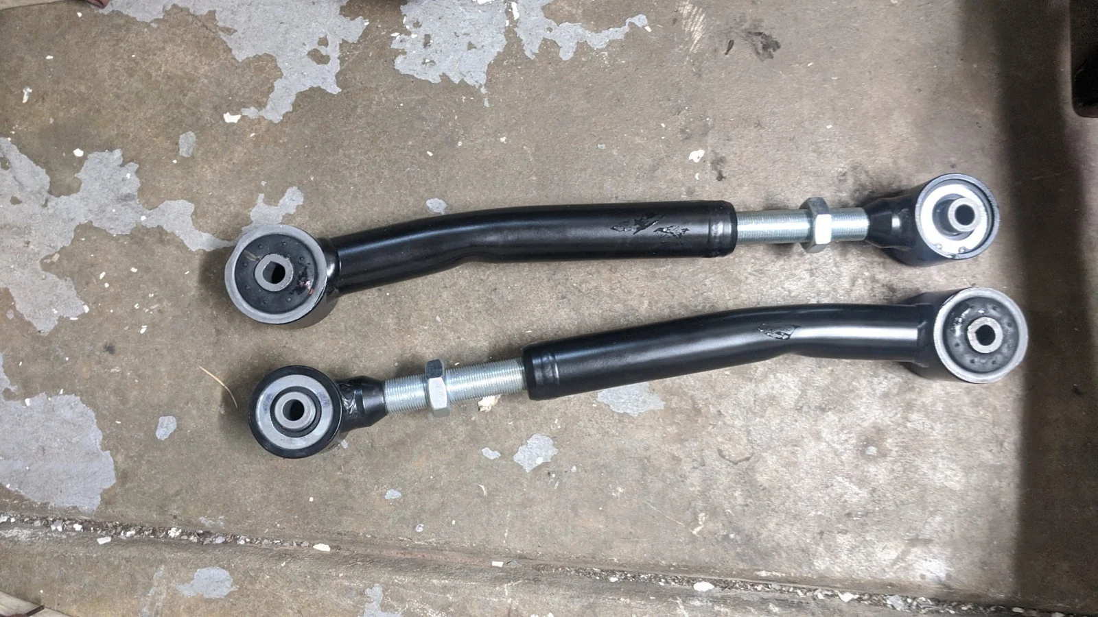

My LCAs came in today!
They look pretty heavy duty! I've got the new axle and lift in the front installed.

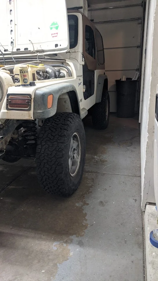

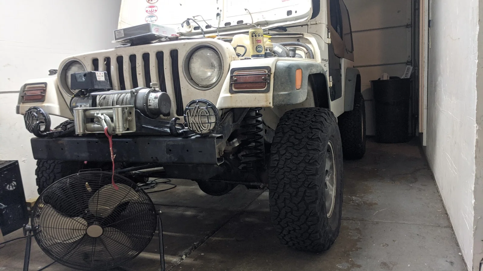

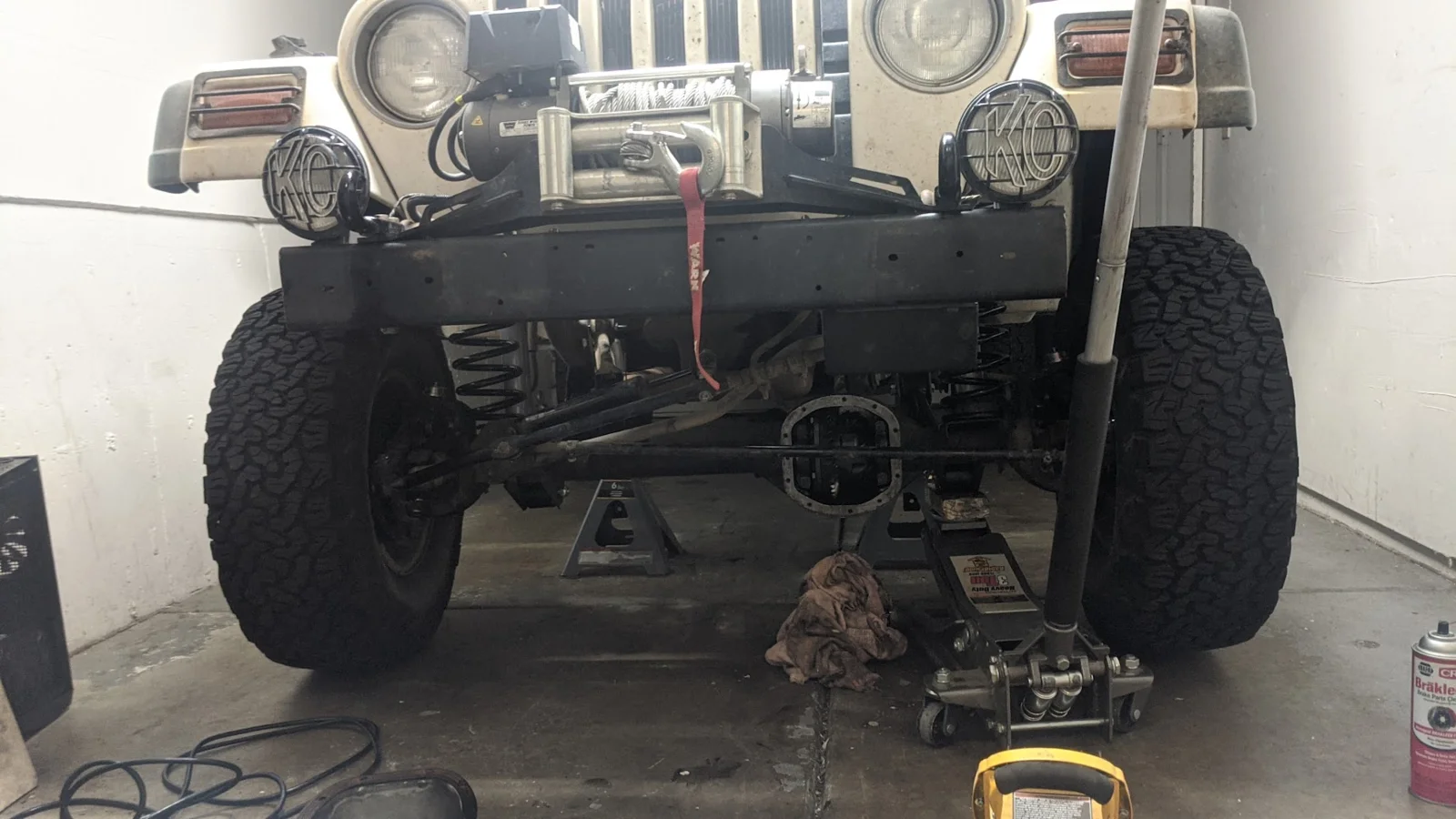

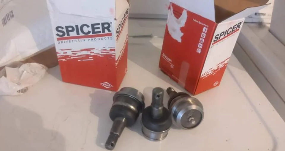

Alright I got my lift in with the new axle! Definitely the biggest job I've done on the jeep so far. So this included...
  • All 4 front ball joints with Spicer
  • new-to-me axle (HP30 w/ 136k)
  • lunchbox moved to new axle
  • 2" BDS lift
  • core4x4 tier 2 LCA front
seems like a lot! I also had the OME rear trackbar bracket but I couldn't fit my drill where I needed it. You can tell the rear axle is off center, surprisingly the front doesn't look offcenter. I'll either buy an adjustable trackbar or a 90* turn for a drill... but I feel like I might as well go with the adjustable if I'm gonna spend money on/for the track bar.
I just need to bleed the front brakes tomorrow and I should be ready for the test drive! Good timing, I am hitting Medano pass on 8/27 so I'm happy it's about ready for a test drive early.
excuse my tiny garage
I'm pretty happy with the way it looks, looks like the tires "fit" now. I am excited to see how it feels with new springs, quality shocks, new bushings in the front axle, and the core4x4 arms. As long as I didn't screw anything up, I bet it'll feel really nice
