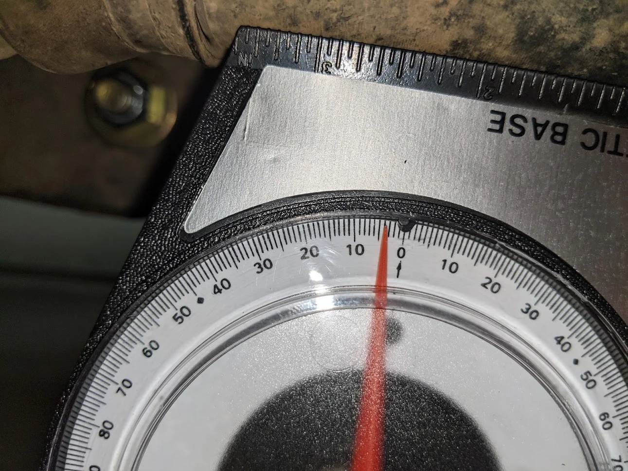

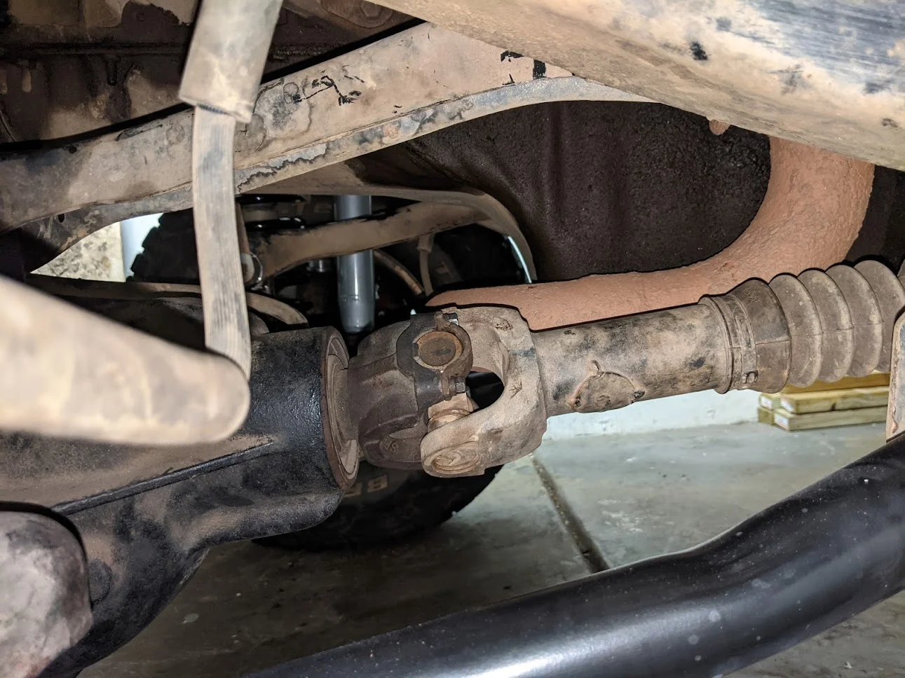

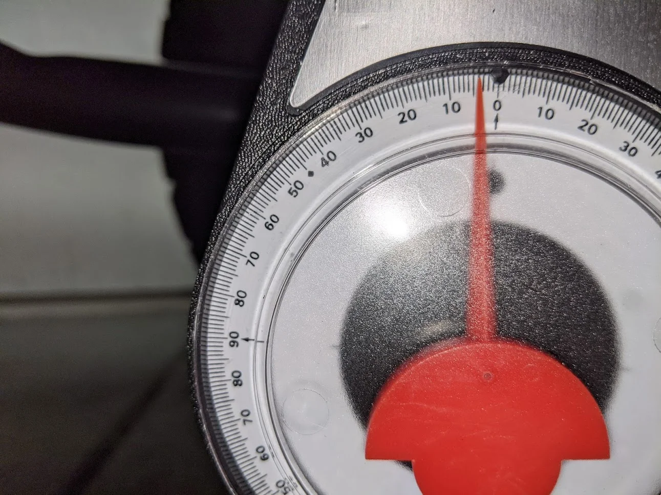

Just drove the jeep some more after doing my alignment yesterday and the jeep has some kind of vibrations now since the lift and new axle. I set my toe-in to 1/8" using the guide here. I figured that I had set the control arms to the wrong length in the front since they're adjustable so I grabbed an angle reader, but it looks like that's not the problem.
Pinion:
Driveshaft:
But it seems like that's setup pretty well I think. I am thinking my best bet is to go through with a torque wrench and make sure everything is still torqued? I shouldn't have too many vibes from a 2" lift I thought. Maybe I just need a MML or TCase drop

FWIW, I ended up somewhere between 2" and 2.5" with my lift and it resulted in some minor vibes. To me, they're innocuous enough that I'll live with them instead of considering a t-case drop.
