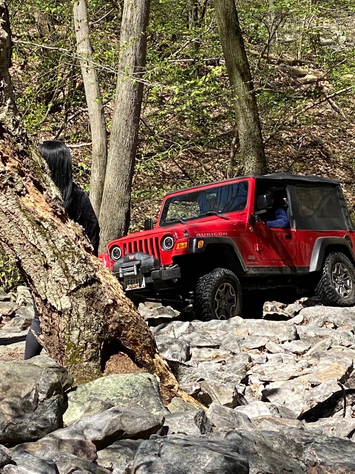

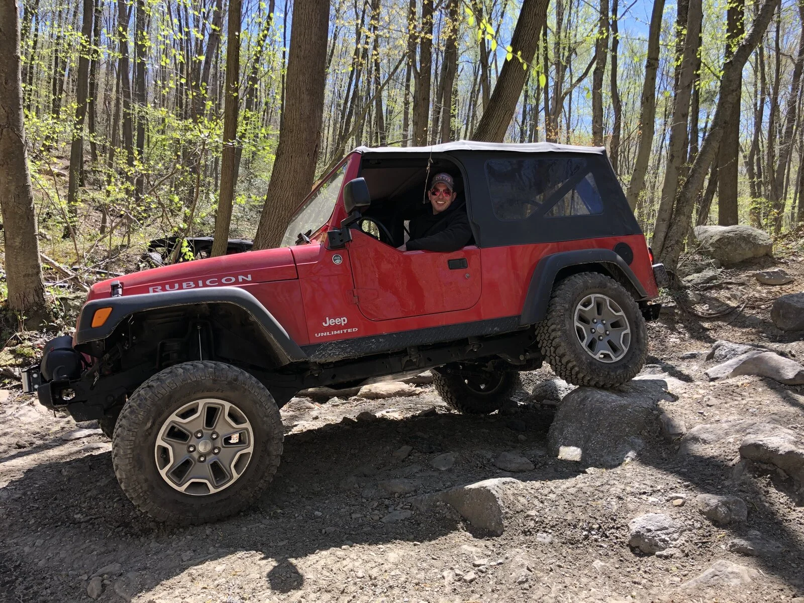

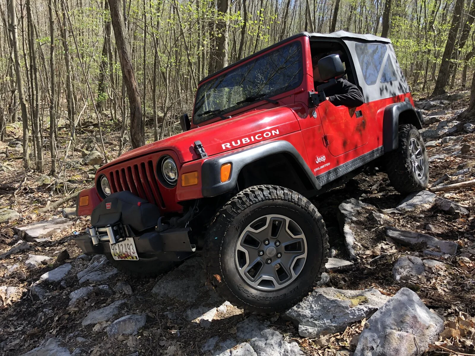

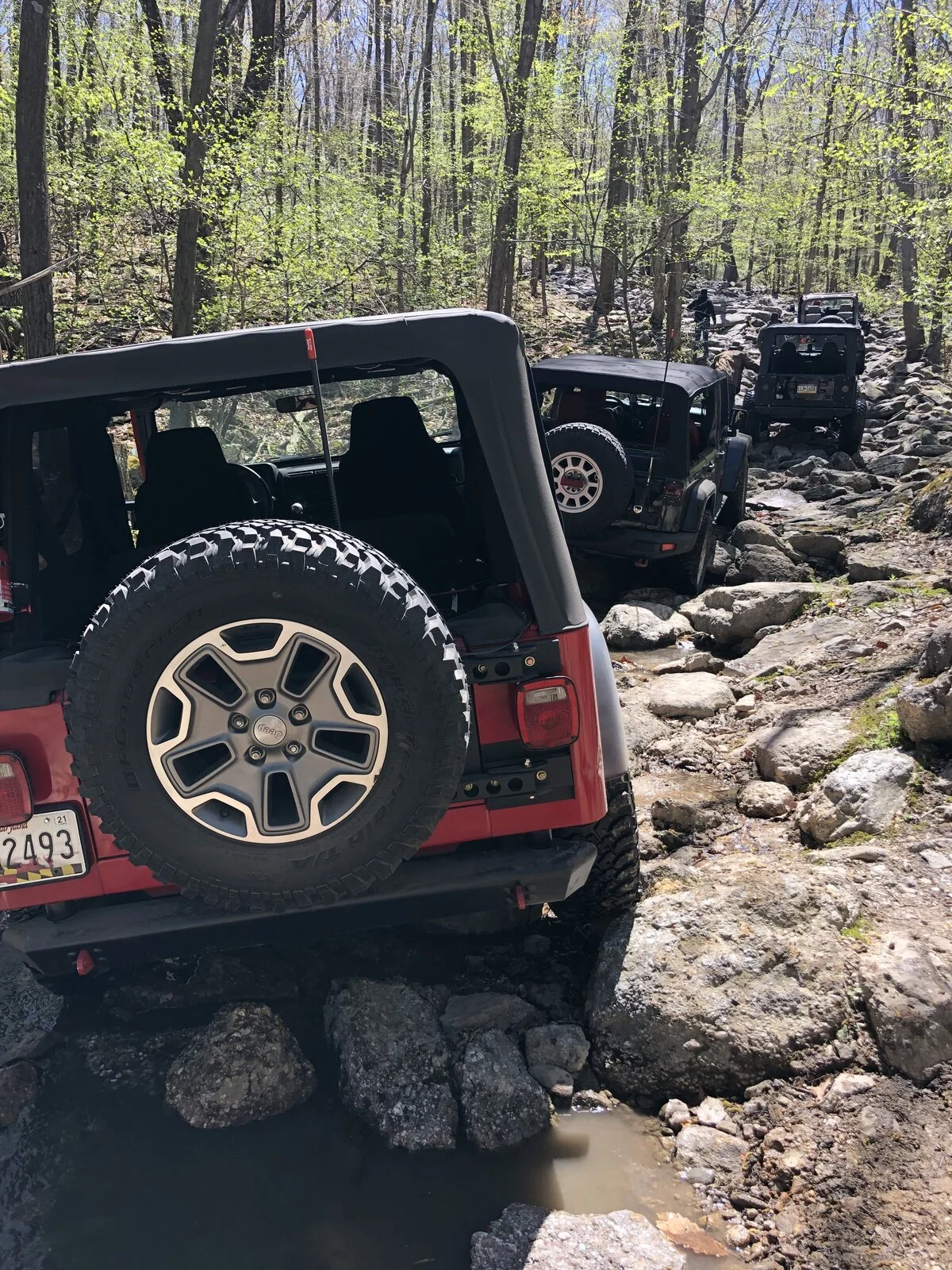

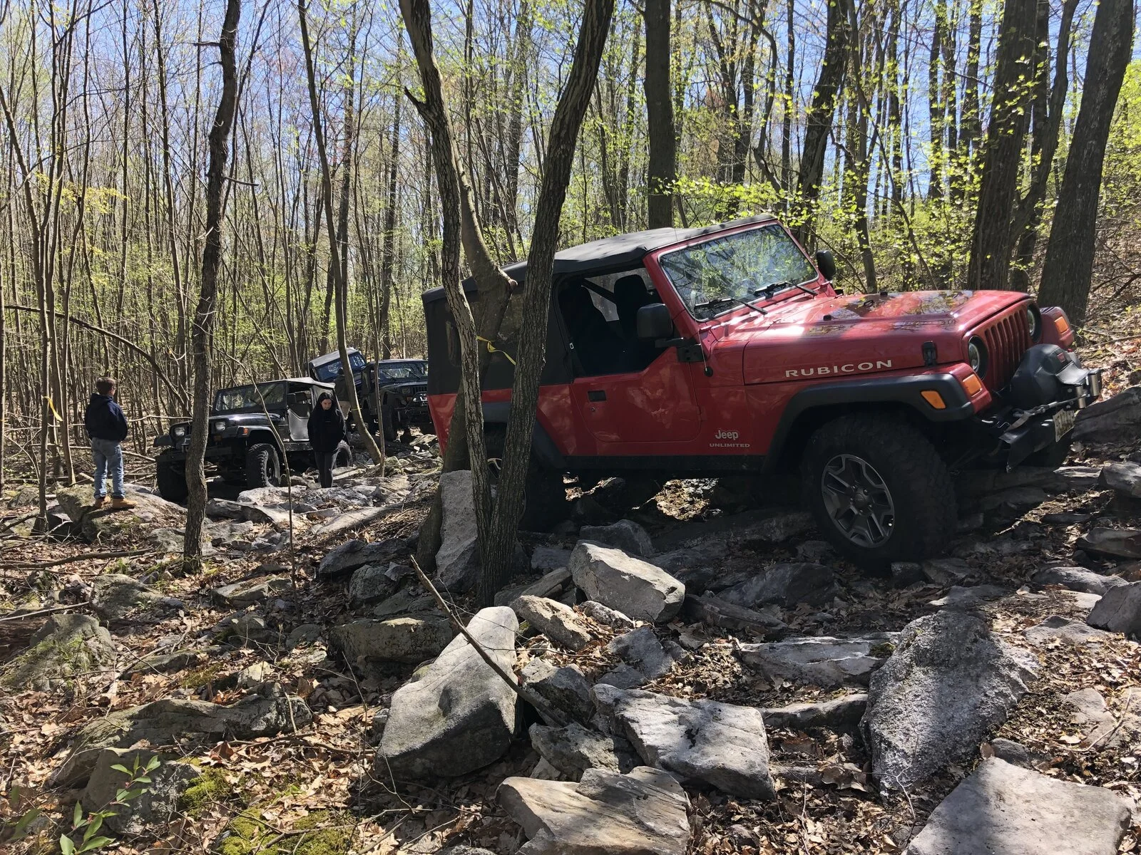

Some light wheeling. Only got 2 pictures, but I had a blast.
New issues that came up: need a new trans (reverse is gone), pretty significant clunking in the tcase or front driveshaft, and that's pretty much it!
I replaced the stock controls arms and added some diff protection. I'm debating replacing the track bars and upper control arms as I'm going to eventually lift it. But, given the condition of the lowers maybe I should??

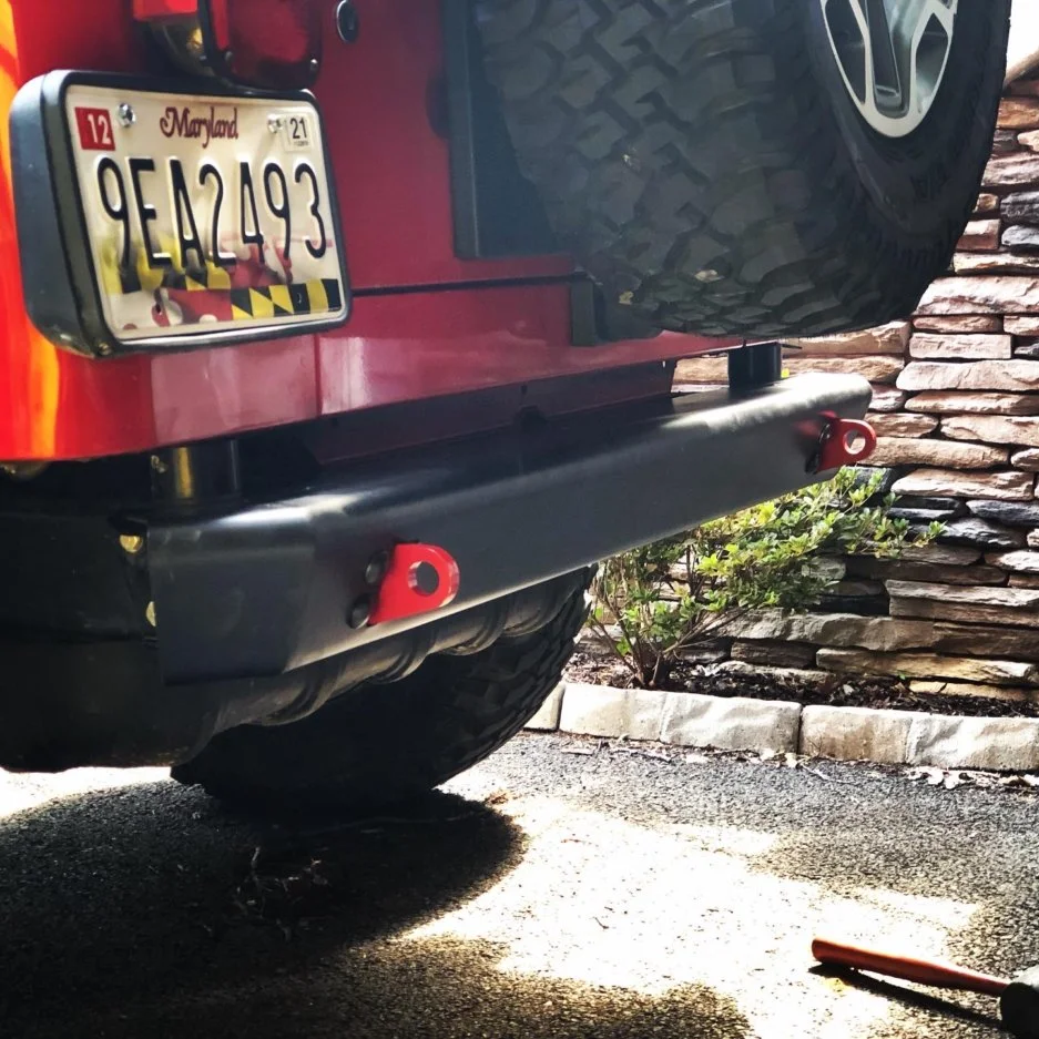

Savvy Tummy Tuck with engine skid
Poison Spyder Corner Guards
Unless by 'Tasteful' you really mean a well built trail rig. Hell, you'll be in the 90th percentile!
Just keep in mind that MD, like VA, uses too much salt on the roads in winter (ie. look at your half doors), putting the corner guards on gives the salt some place to hide and do it’s corrosive thing on the body........just my 2 cents......

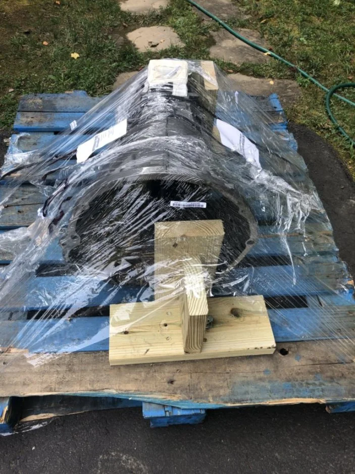

If anyone is considering replacing their NSG370, this is what it looks like when it arrives at your doorstep
So where did you end up getting it? I would like to replace mine. Reverse is finicky. Otherwise, I have no complaints but sure would like to get reverse fixed.
I went with High Impact Transmission and Gear.
I liked their warranty and shipping options.
Please let us know how it drives and anything you run into getting it back together.

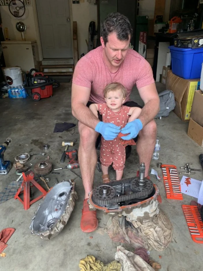

NSG370 Install
  • I found it easier to remove the tcase first, then the trans
  • Make sure to remove the bell housing dust cover bolts.. they will prevent the trans from being removed
NV241OR investigation
  • So my tcase makes a lot of noise when wheeling.. clicking back and forth whenever I'm in 4lo... I thought it might be the chain, so I replaced it. Turns out its how the tcase engages and stays in 4lo. I guess its normal?
  • Disassembling the NV241OR was actually not that bad. There are no c-clips like a 231 and everything was pretty straight forward
  • One thing to note: make sure the tcase is in 4lo for reassembly.
Let me know if anyone has any questions or comments!

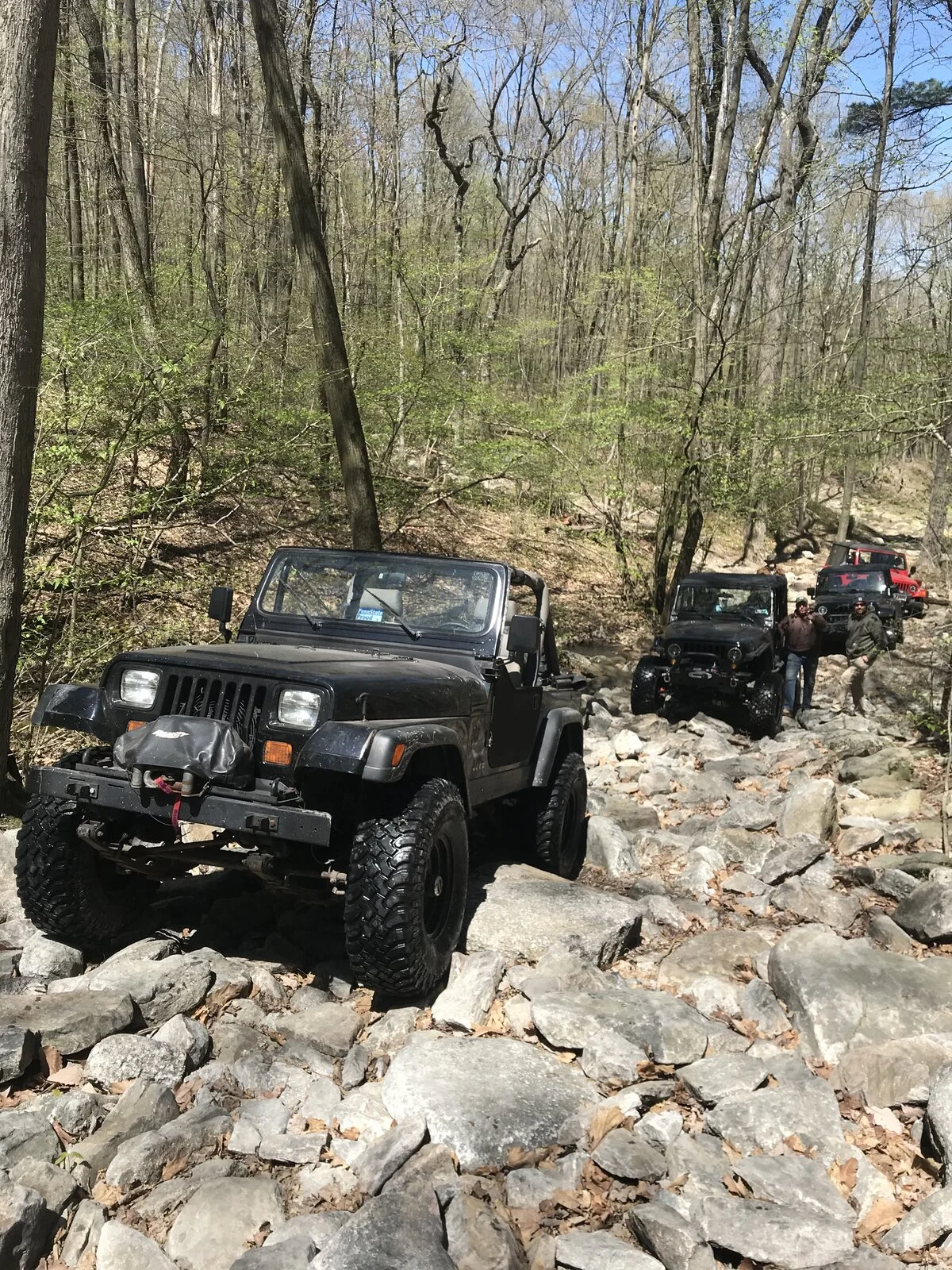

And then went wheeling!
