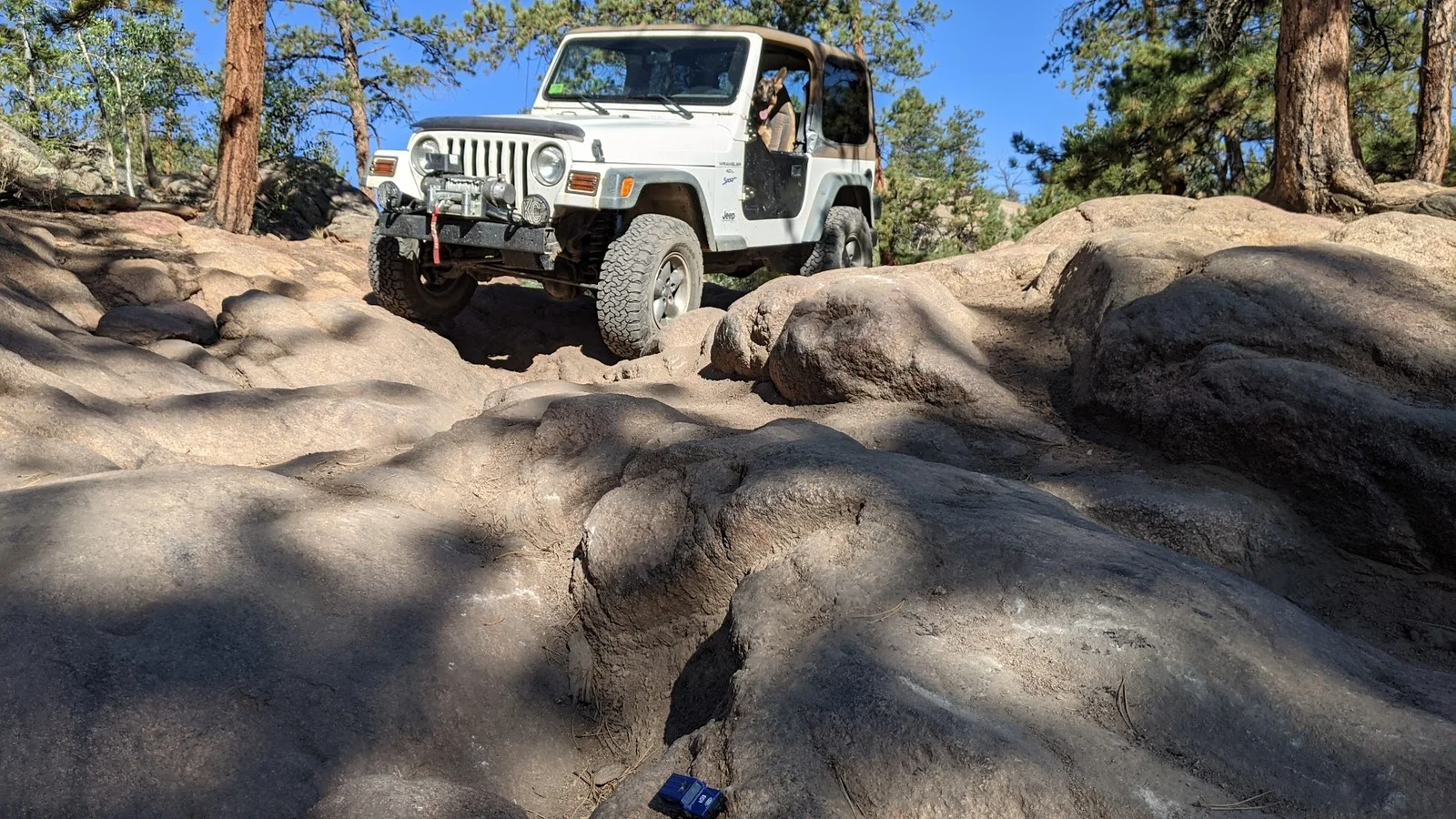

Here's a pic from my trip to China Wall in September:
It was a fun trail, this section was technical and fun. There is the other tough obstacle where you make that turn going on the offcamber hill if anyone knows it... got nervous doing it alone and turned around. Guess I need to go back

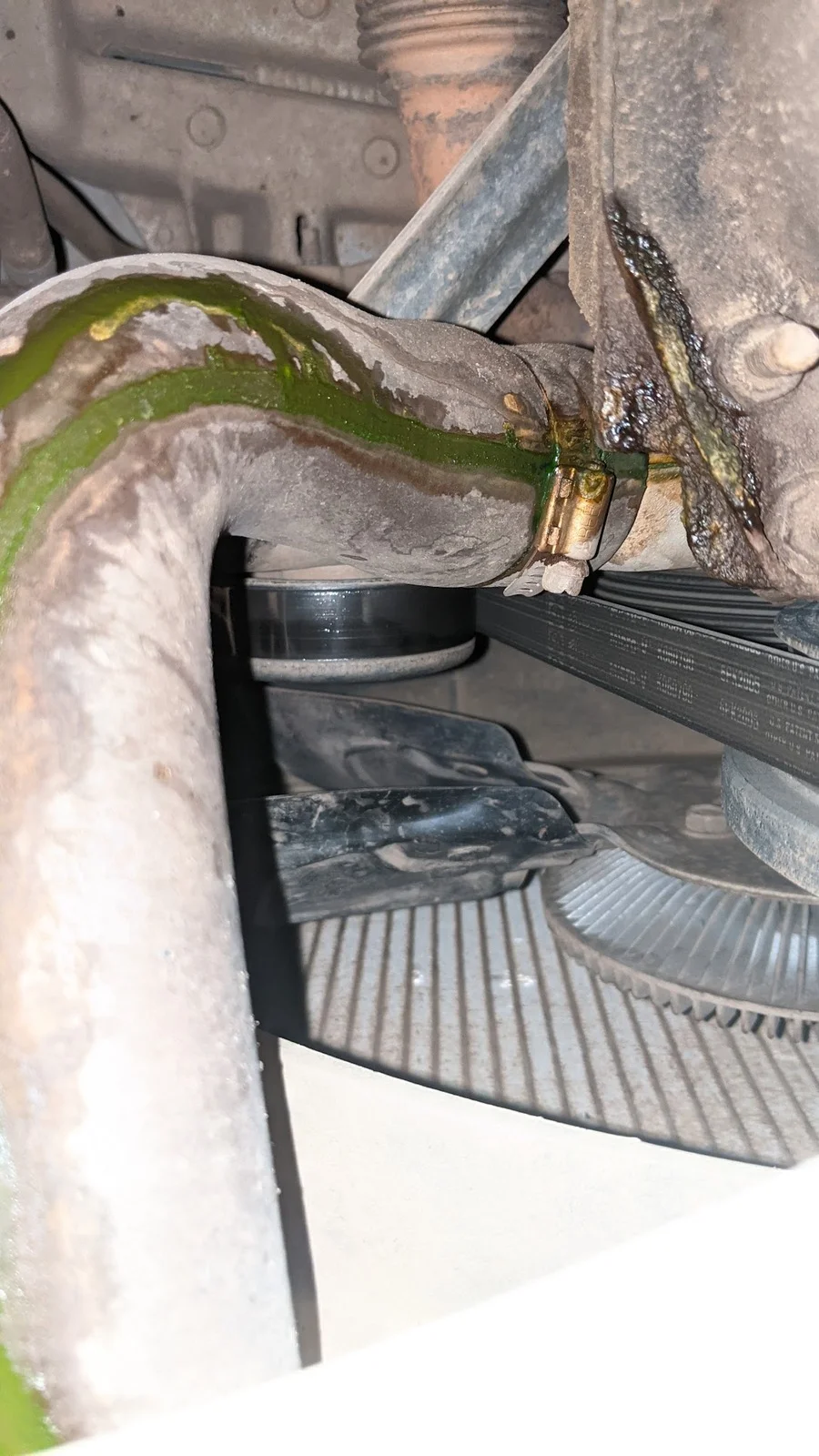

In prep for the trip is to figure out a coolant leak I have going on. It's dripping down my lower rad hose, I've got a replacement that I bought when my upper rotted out, figured I'd need it eventually. I think I read the water pump will leak over there through it's weep hole if it's dying though... Guess I've got some research to do. Hopefully it's just an old hose.
Threads are no fun without pics, here's a gross leak:
That hose looks bubbly in places. Also, a constant tension clamp is better than a hose clamp.
Reactions: Wildman
Yeah that hose looks pretty bad... wonder if it's just age or if it's been sitting there soaking something up. Any idea what specs I need to be sure I get the right tension clamp to replace that?
