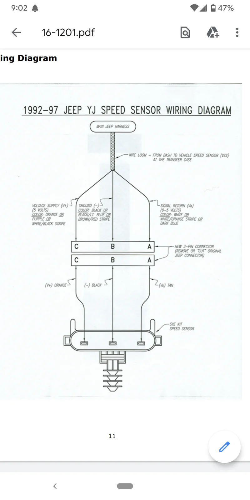

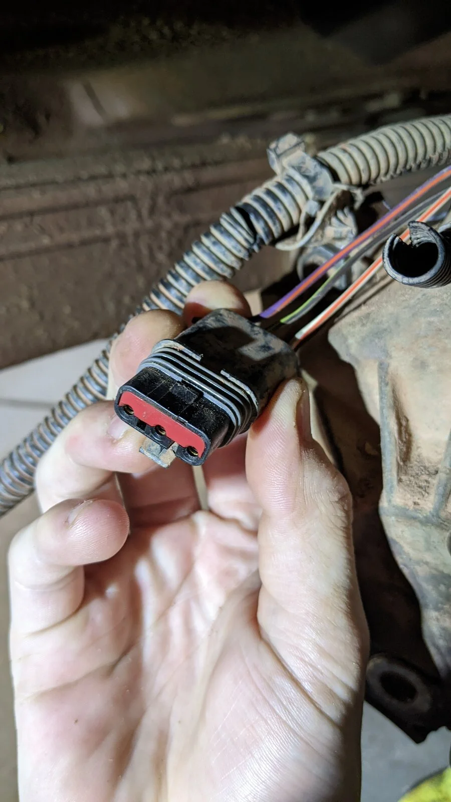

Anyways thanks to @thekidwithquestions help on collab it seems like I'm bumping into the curse of the 97 YTJ - I think I have a YJ pigtail on my tcase and not TJ, since mine doesn't match the one on the new speedo sensor. JB Conversions shows a wiring harness kit for it on the bottom of the install sheet but I can't find it on site, guess I'll have to wait til tomorrow to call them and see if they still sell it

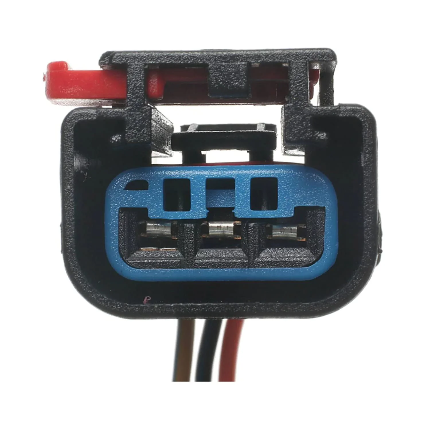

Post up a picture of the plug and the wire colors. I had to change my plug when I installed the AiRock and STaK's t-case so I might be able to help. And I might have the plug you need.

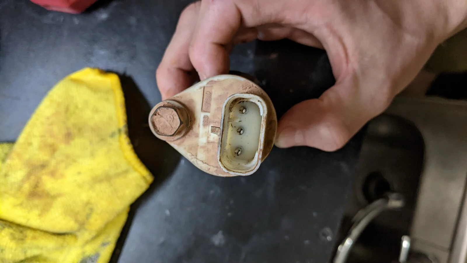

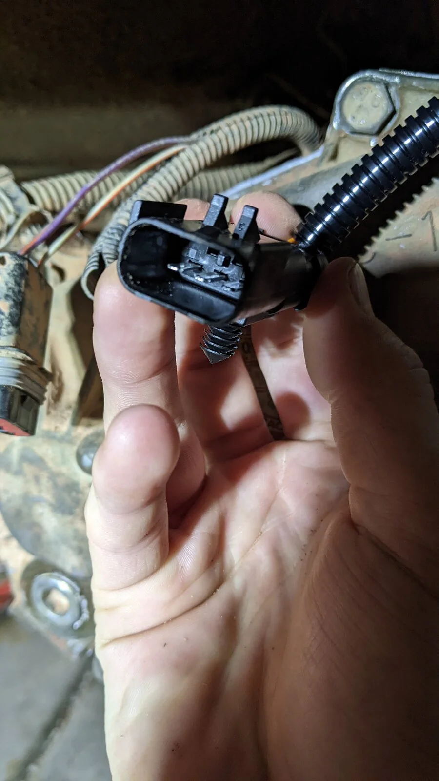

Okay this is it... Flats on the new, rounds on the old
Yours is a 97 too right? Maybe it was manufactured late enough to get the new one?
From the JB Conversions kit. My wire colors seem a bit off too but probably not a huge deal
Sorry I went and reread what you wrote. I'll have to go look at the plug I cut off. I have the flat connectors now but I did change mine.

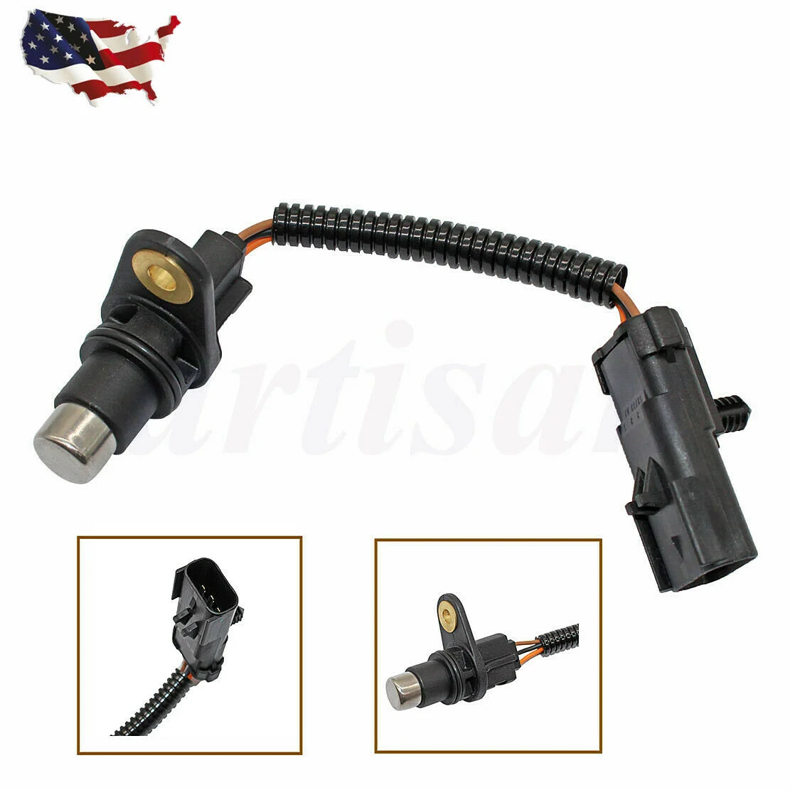

Mine is a 01/96 build 97 Model. I had to change the plug due to the STaK's and AiRock. The plug with the round connections isn't a Jeep part. If you look at the plug I linked on Amazon and then the speed sensor they are all flat connectoors.
Right yeah you guys both posted what looks like the one I need...
Here's my old speedo sensor, you're right I can't really find the Chrysler star on it anywhere
