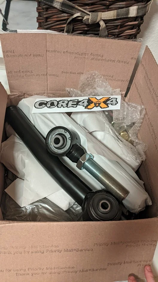

Oh boy more goodies from White Santa (USPS). Wait, can I say that??
All 4 adjustable rear CAs!

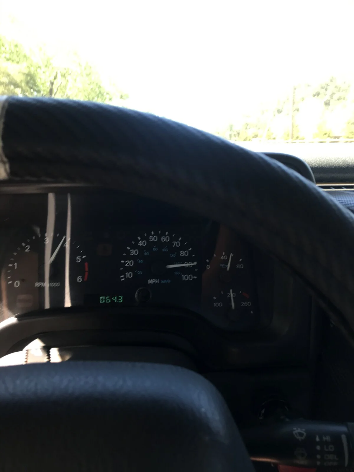

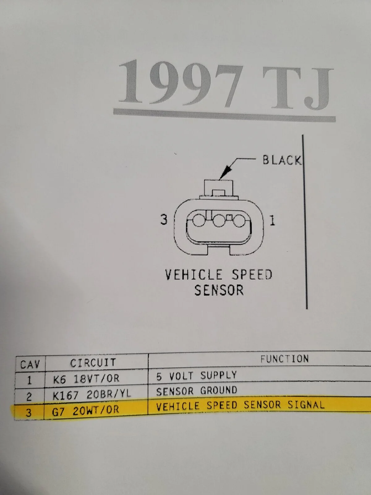

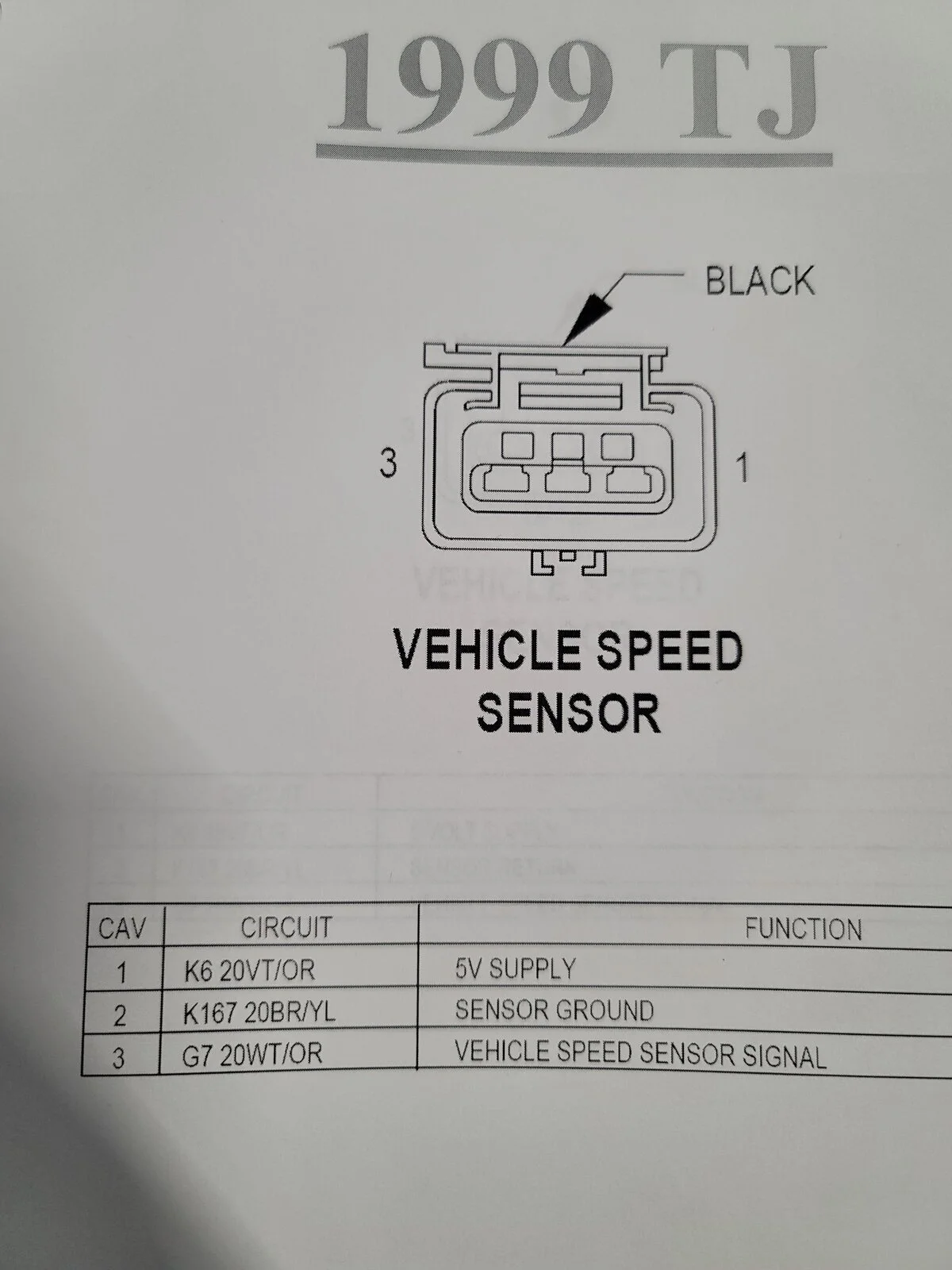

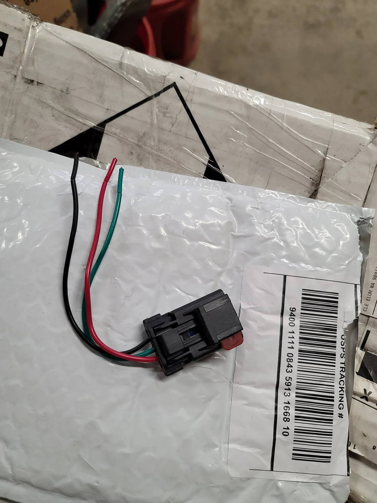

I didn't forget about your speedo connection.
So I couldn't find the plug that I'd cut off but yes stock did have the round connectors.
When you get that plug from Amazon you just need to wire it in.
Red is #3 Speed Sensor Sig
Green is #2 Sensor ground
Black is #1 5V Supply
Awesome!! Thank you that will be super helpful. And also good to know this isn't a result of PO fuckery. 1/27 estimated arrival. Sucks to have everything waiting on a 9$ connector lol, but I'm sure you know the feeling
