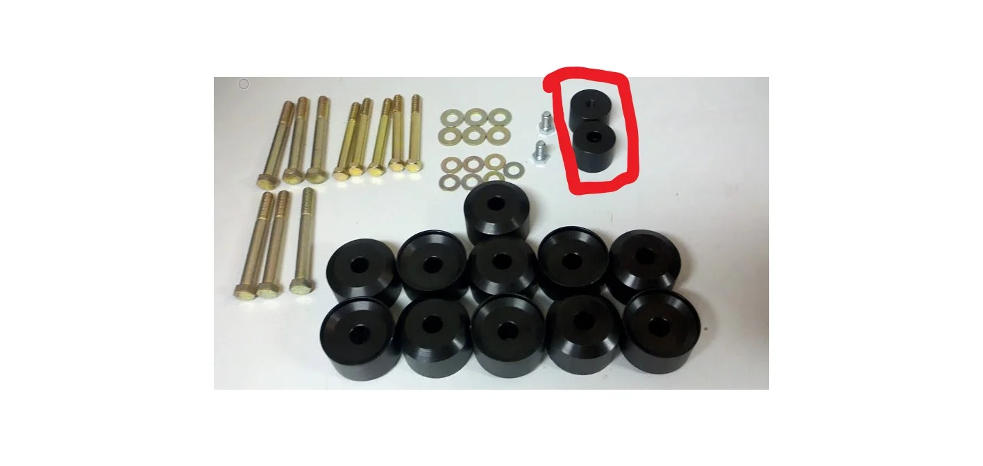

Is it the aluminum good stuff lol. What could I make the cowl ones out of?
These two little spacers for the front cowl (what your headlights mount in) they space the rubber snubbers
It's a Savvy BL but I raised all my mounts except for the front mount in front of the radiator.
@Alex01 might have one puck or someone else that raised the 6 main body mounts.
wait, when I ordered my BL no one said anything about cowl spacers, or are they not needed with a MML also installed?
If you have a Savvy BL they are in it.
Oh, those are what your talking about, yeah I have those...
Edit: Funny since JJ IGNORED ME (PUSSY) I can't read his comments but it seems he can read mine.
I gave my spare pucks away a while ago. Since then I believe they passed hands and now @JMT has them IIRC.
Hmmm I'm not sure how I'd make those little snubbers. Plus I already ordered lol, not too bad a thing since they're made in USA I don't mind too much spending the money...
First year I've gotten a tax refund and didn't have debt I need to pay off so I kinda just pulled the trigger on a bunch of crap right away :LOL:
If you can weld, make a couple simple 1.25" tall pads that sit on top of the frame below the grill snubbers. You can screw something down a well.
I can't weld unfortunately, I'm kinda waiting til I move (hopefully this year) to try picking one up.
You might see me begging to trade some good beer or a drink of choice for a few welds I need done before TJ Fest around here soon hahaha
If it's Back Ordered for a while you could cancel that in your order. Just thought I'd offer it to ya.
Reactions: lBasket
Yeah true! Well we'll see if any of the guys you tagged still have one of the pucks laying around - if so I will probably take you up on the offer so thank you!
Wildman
Staff Member
Dec 12, 2015
16,848
In the hills of WA
I'd bought it thinking I'd use all but 6 of the pucks and then ended up raising all my body mounts other than the front one. So it's just sitting here.
I'm sure there is someone who has an extra one. And as JJ said it's easy to make a spot for the snubbers. Heck I might just make something for mine. Since I have a welder.

Sorry for not being able to think of the correct terminology for the grill... All I could think was cowl. Let me know if it's going to be BO for a long time and if you decide to cancel you order. Then we'll work something out.
Make local friends, a few of us have welders, can weld, and like to work with others 😅 oh, and have 4 spare savvy spacers and bolts in a box somewhere.
