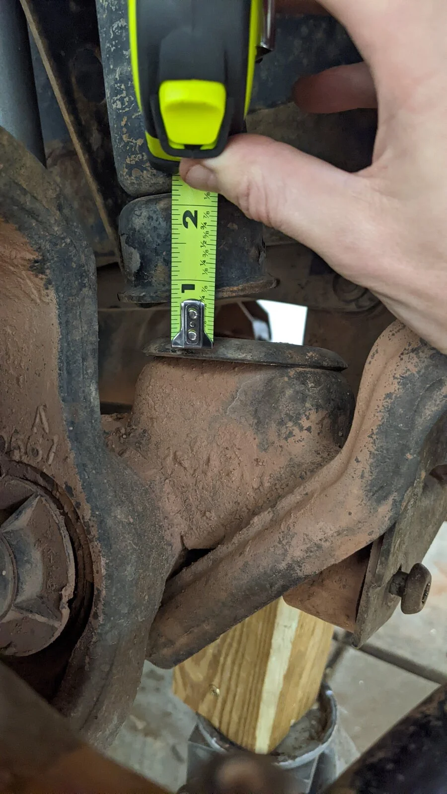

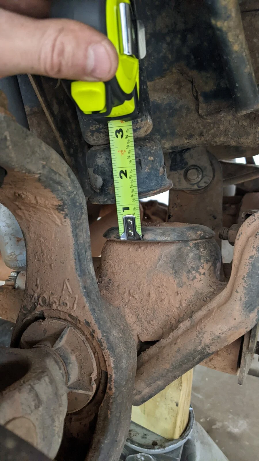

Soo when I am checking to set bumpstop do I want to lift just one side of the axle at a time? Or from the center? Or maybe both and pick the max bumpstop required for both?
I set the fronts both independently at full articulation. Make sure though that they'll still work at full bump though because fill articulation may allow to to go a bit shorter than you should. (Fast driving offroad and hit a whoop you'll need full bump. Flexing you'll need full articulation. )
Ah okay so make sure bump isn't too short with both sides pushed up?

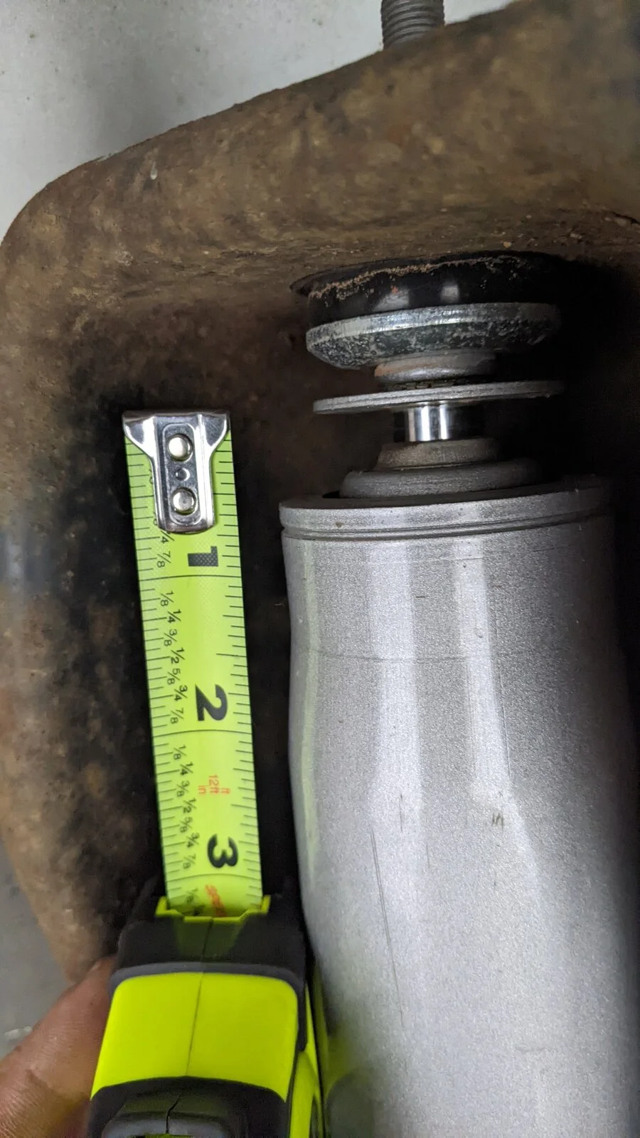

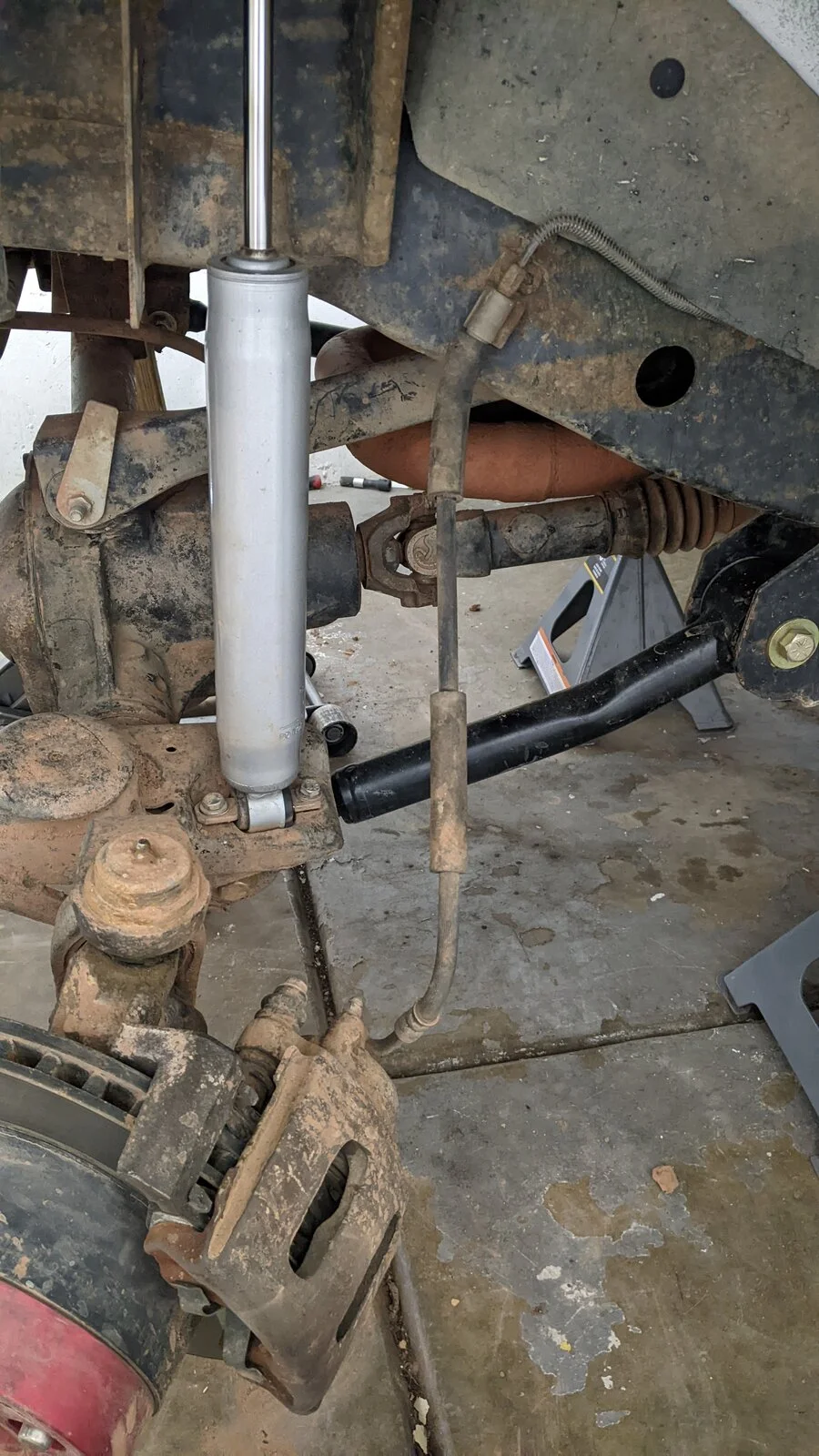

Discovery #1 is I should've installed those YJ brake lines I bought after all, drives side with passenger where full bump is going to end up needing to be, full lock:
Reactions: Alex01
OP
lBasket
lBasket
Branch Manager
Dec 14, 2020
1,613
Aurora, CO
Looks like I need 1" of bumpstop over here. That's nice i wasn't excited to try to to cut a hockey puck in half with a hacksaw
