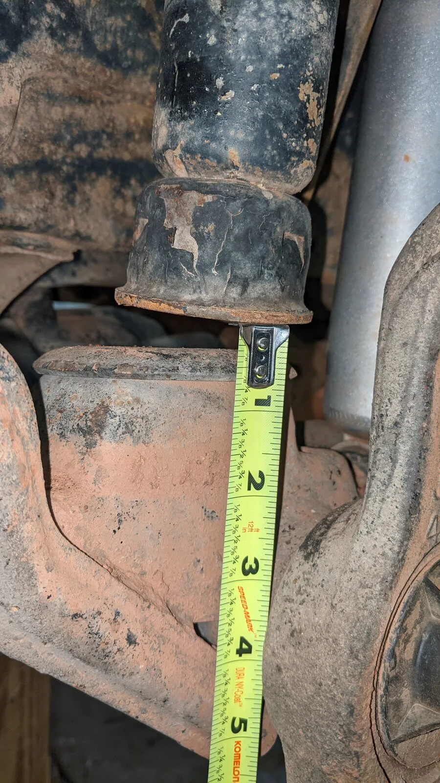

Okay so this is as close as I can get to full compression of the shock and still being able to turn the tire by hand @10psi. So this is when I'd want to space the shock top mount down a little bit (rather than just using bumpstop to stop the uptravel) to maximize usable travel?
That's what I would do. Bump to that shock length and then space the shock down a bit with a cup washer or two. You should have four from the old shocks.

Okay cool, starting to understand what I'm going after here... Maximizing travel while preventing interference. Takes more thought than just adding bump til nothing touches that shouldn't
You're most of the way towards understanding an outboard. 😉

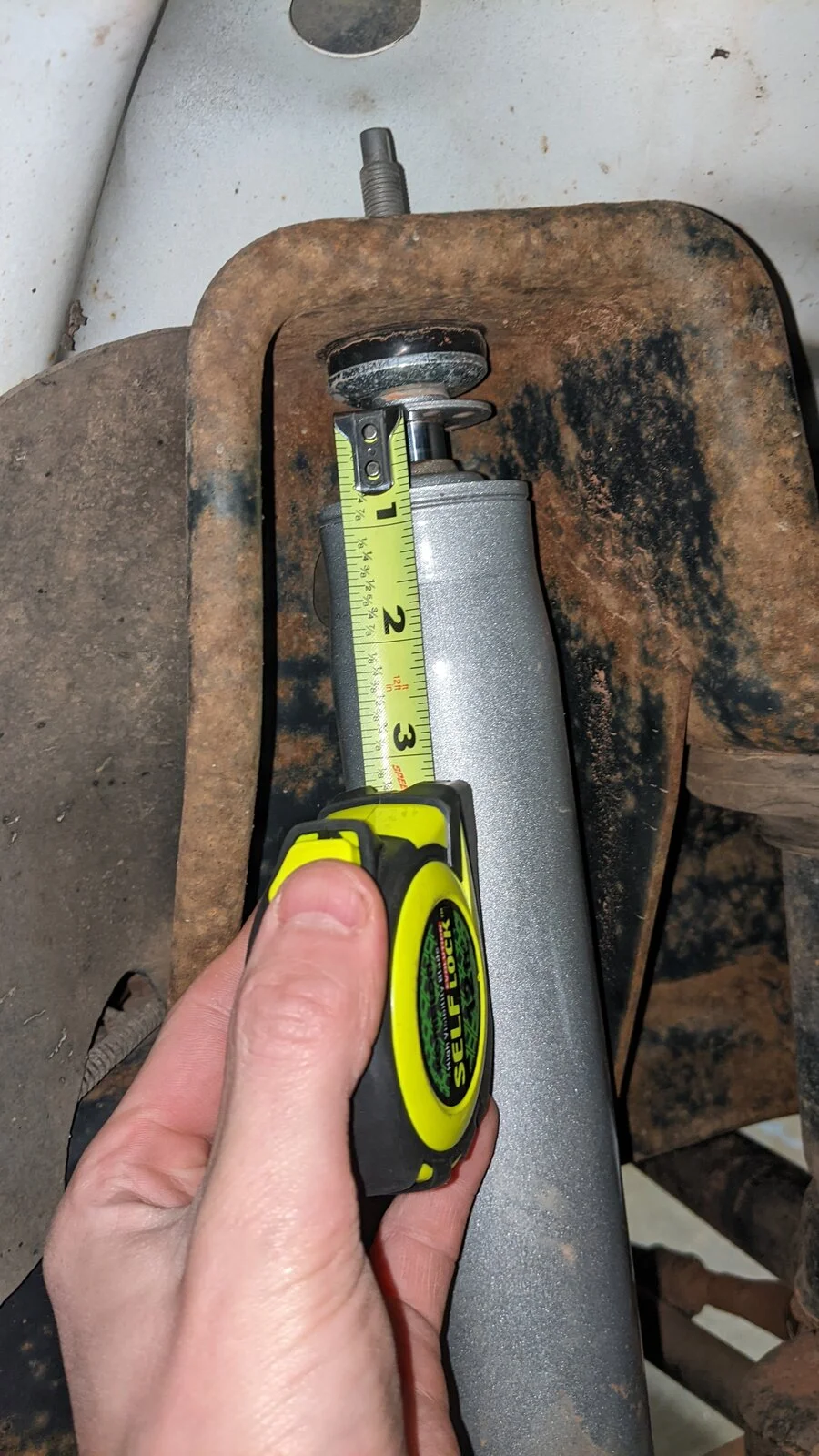

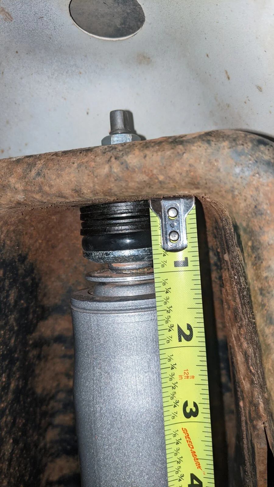

Sweet, got some washers spacing the top mount and now I can spin the tire at full shock compression
And now my bump shifted and should be 1" now
So I just shifted unusable uptravel due to tire size to usable downtravel. Cool! And I'm guessing when I get my body lift I can remove the spacers and redo all this.

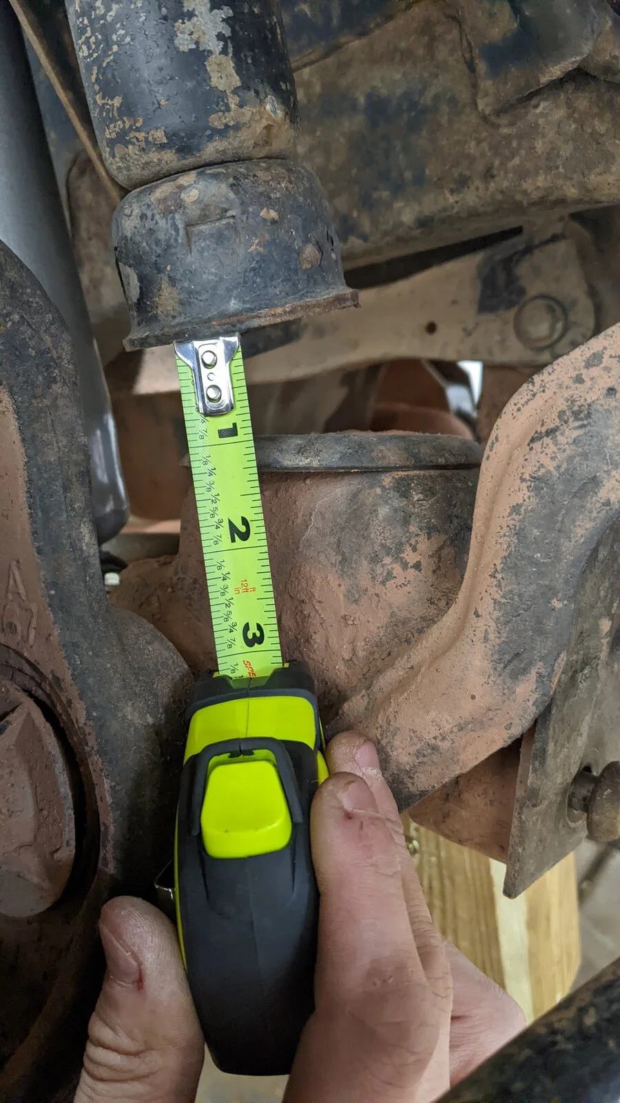

Back to checking for the driver's side. Definitely seems like the axle is pushed driver's side, no problems with clearance at all shock fully compressed, lock to lock.
Track bar clearance is close too. But doesn't touch!
Much less bump needed over here.
So, is there any problem with having spacers on passenger side and not driver? Or should I put the same spacer on top mount for driver even though it doesn't need it so it's symmetrical?

I've always made both sides the same.
