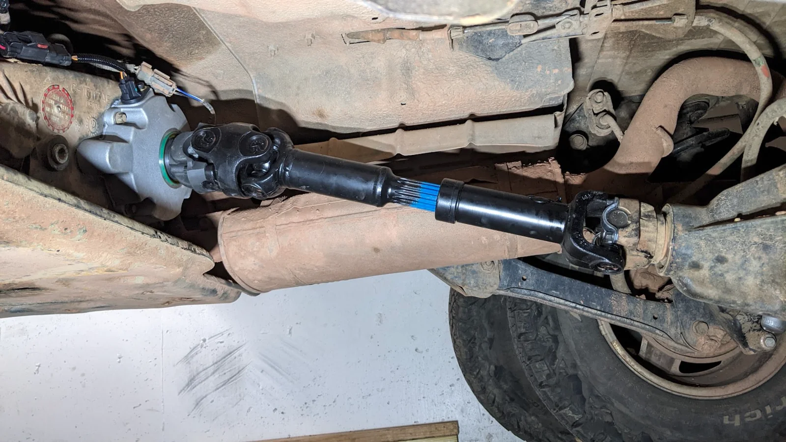

For a minute there I thought you had installed dual shocks!Driveshaft is in

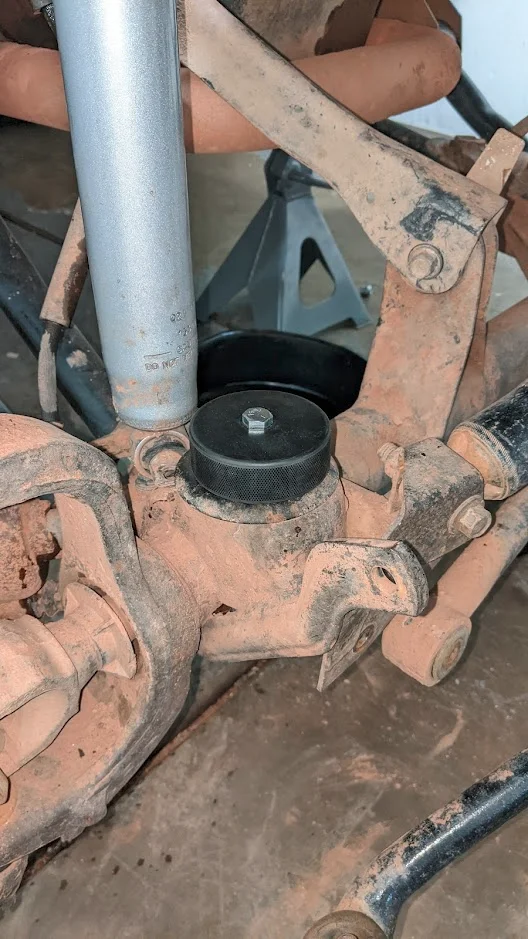

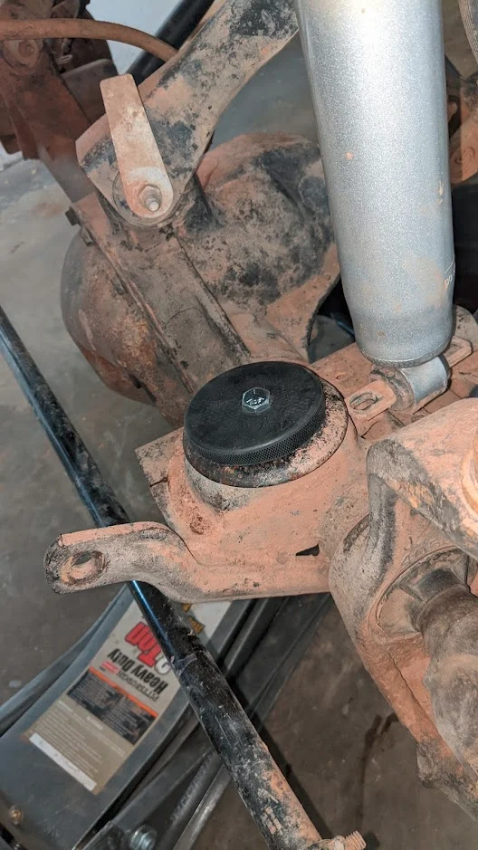

Got the bumpstops made too. Was cool to just have the right bolts laying around so I could put the front end together tonight
View attachment 307134View attachment 307136
Sucks they're so uneven. Looks like an adjustable TB is in my near future... Now I just need to put the extended brake lines in for the front. I need new crush washers for that, they were supposed to show up today in the mail but instead I got an empty package. Never seen that one before
I think the rear is just at that angle because the front is lifted up - I have core 4x4 t2s adjustable arms for the front lower, and upper and lowers for the rear that I'll be installing soonLooking good! What CA’s do you have? I see factory CA’s in some pics and another CA on the ground in another. Upper adjustable arms in the rear I suppose given that angle.
Haha nope just in a weird position from the axle hanging with everything disconnectedFor a minute there I thought you had installed dual shocks!

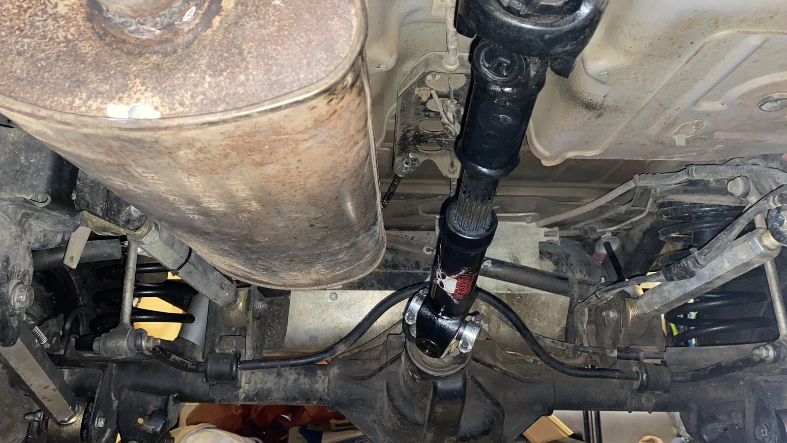

Looking good! Your DS seems to be more extended than mine??Driveshaft is in

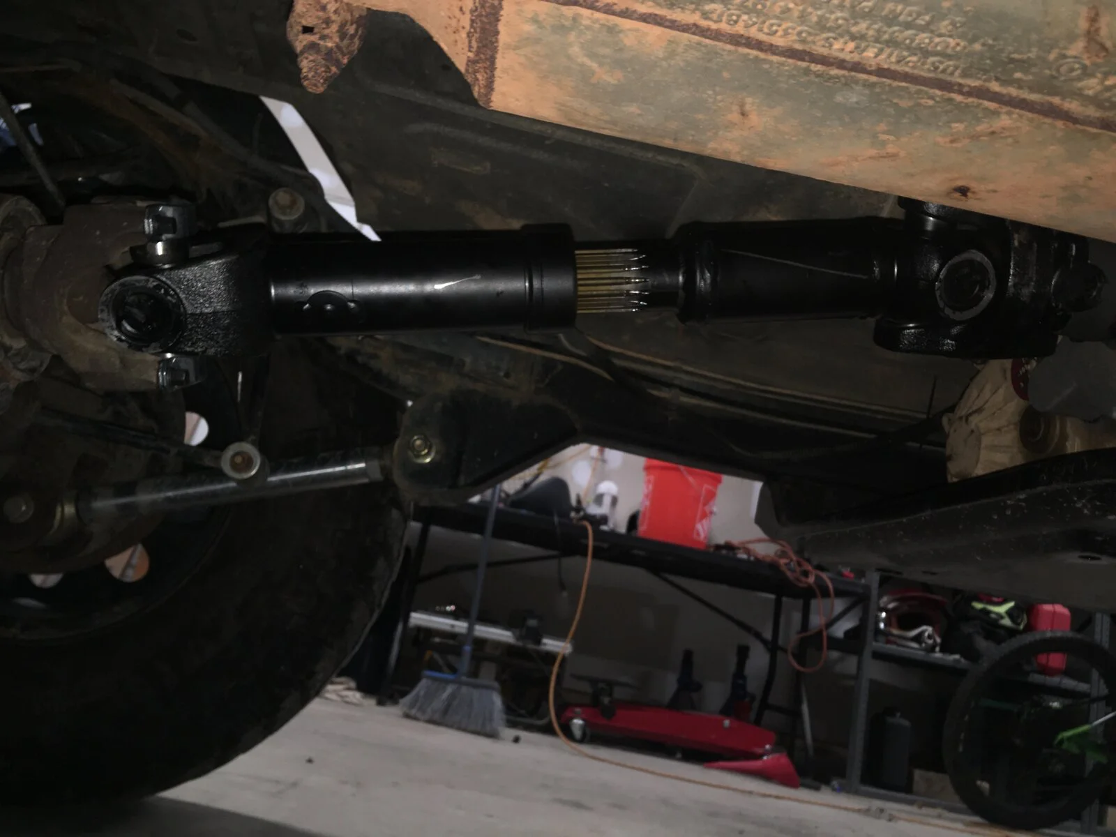

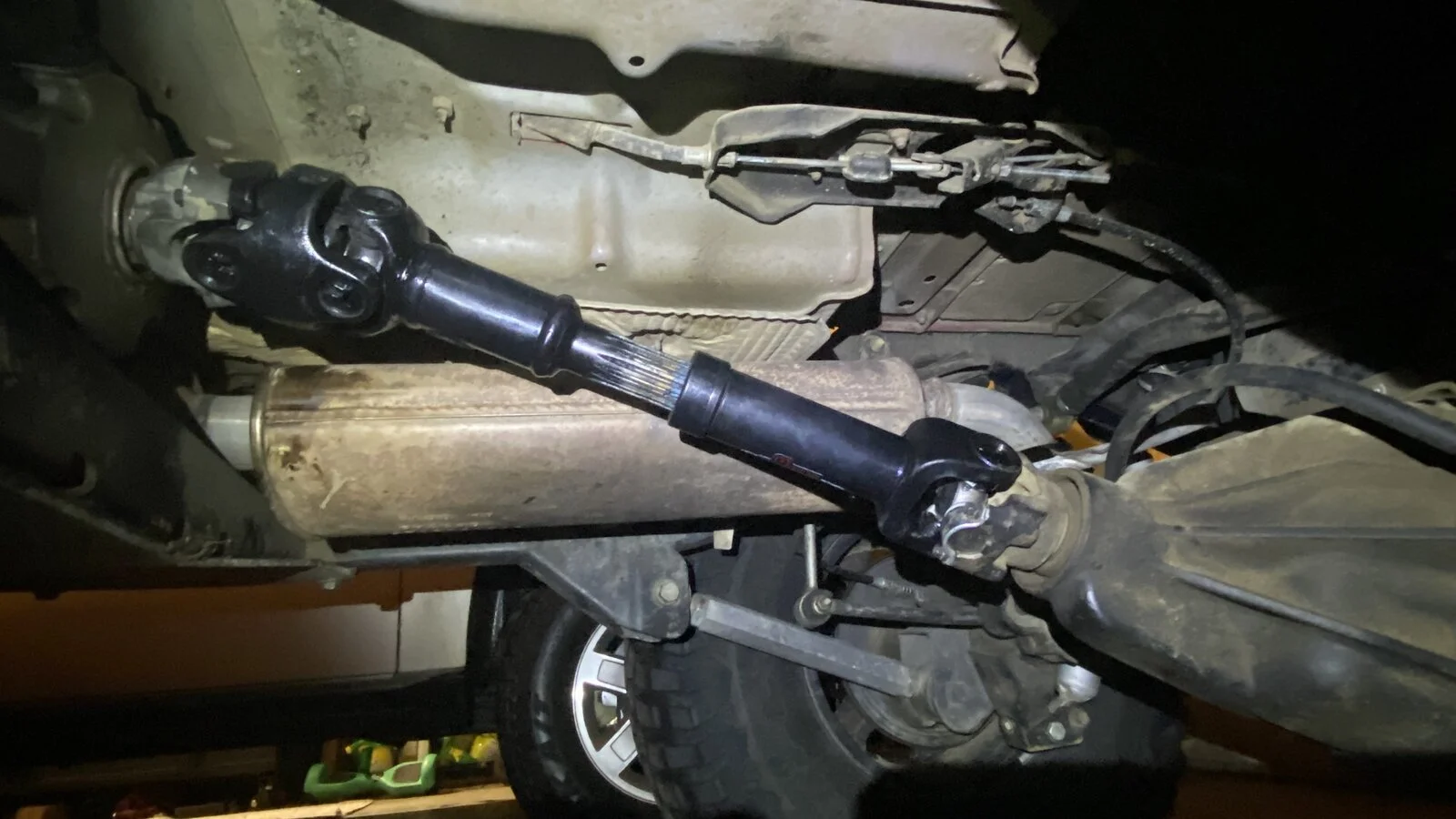

I did get the x spline I also told them to try to make it long enough for the TT.. maybe it's because mine was a little bit longer than yours if I'm remembering right. Did you the the XB or XC option for the slip yoke?Looking good! Your DS seems to be more extended than mine??

I assume you have the X spline?
I never heard anything about a XB or XC option??I did get the x spline I also told them to try to make it long enough for the TT.. maybe it's because mine was a little bit longer than yours if I'm remembering right. Did you the the XB or XC option for the slip yoke?
but that would mean it should be less extended because it would have to leave room to extend more?I did get the x spline I also told them to try to make it long enough for the TT..
Idk exactly what the difference is, it said one was better for rocks and one was better if you're in mud alot I think. I picked the one for rocks cos I hate mud. Mines XC I can see it on my invoiceI never heard anything about a XB or XC option??
Yeah idk, I'll have to check out how far it extends at full droopy, it looks like it's about halfway extended which I think is what I want? It's only 70$ for a resize for the tuck if I need it anywaybut that would mean it should be less extended because it would have to leave room to extend more?
The X spline will extend through most of the shaft on the pinion end. They’re really long. I was surprised when I pulled mine out.Idk exactly what the difference is, it said one was better for rocks and one was better if you're in mud alot I think. I picked the one for rocks cos I hate mud. Mines XC I can see it on my invoice
Mhmm, sure...The X spline will extend through most of the shaft on the pinion end. They’re really long. I was surprised when I pulled mine out.

I have a similar amount of exposed shaft.Mhmm, sure...
Yeah I gotta check if my rear brake line is too short like the fronts were anywho so I'll be sure to check that out as well. Hopefully I didn't F up my measurement lol. I guess that'd be what I get for not knowing how to use a tape measure
Oh good. It's supposed to be about 50% exposed at normal height right?
