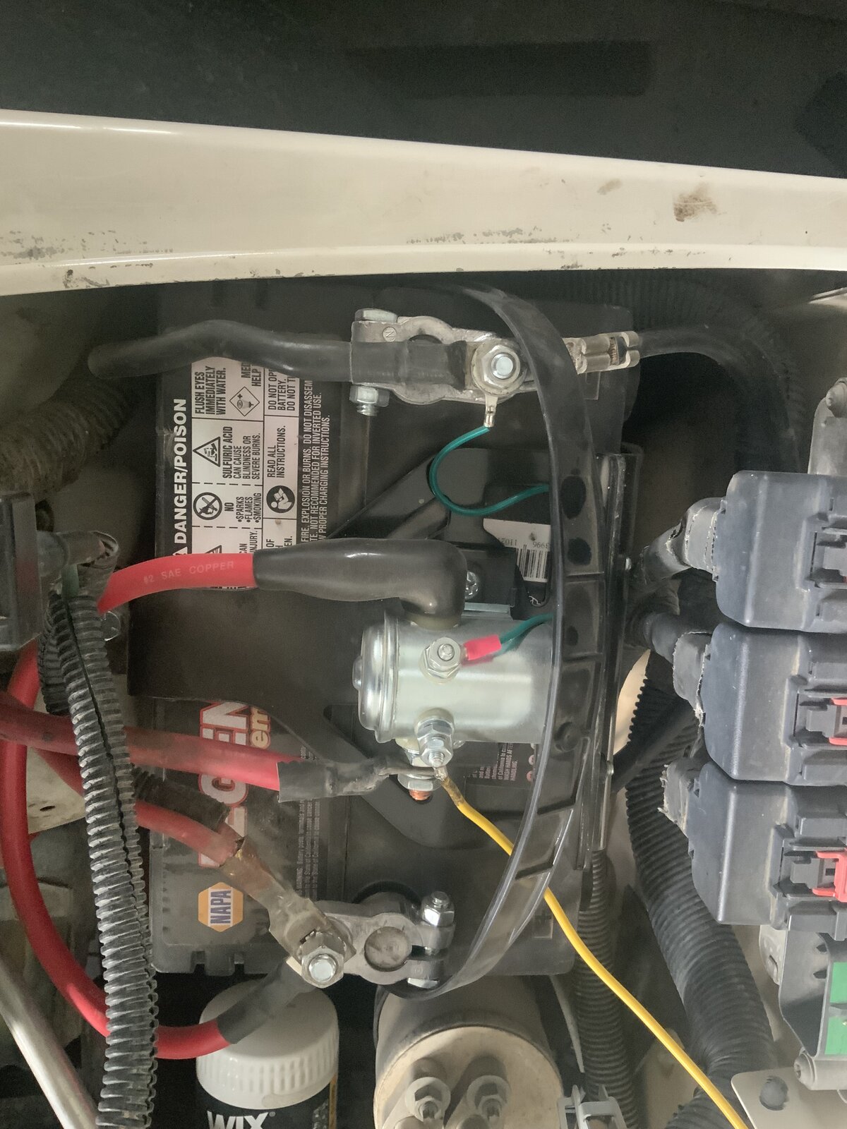

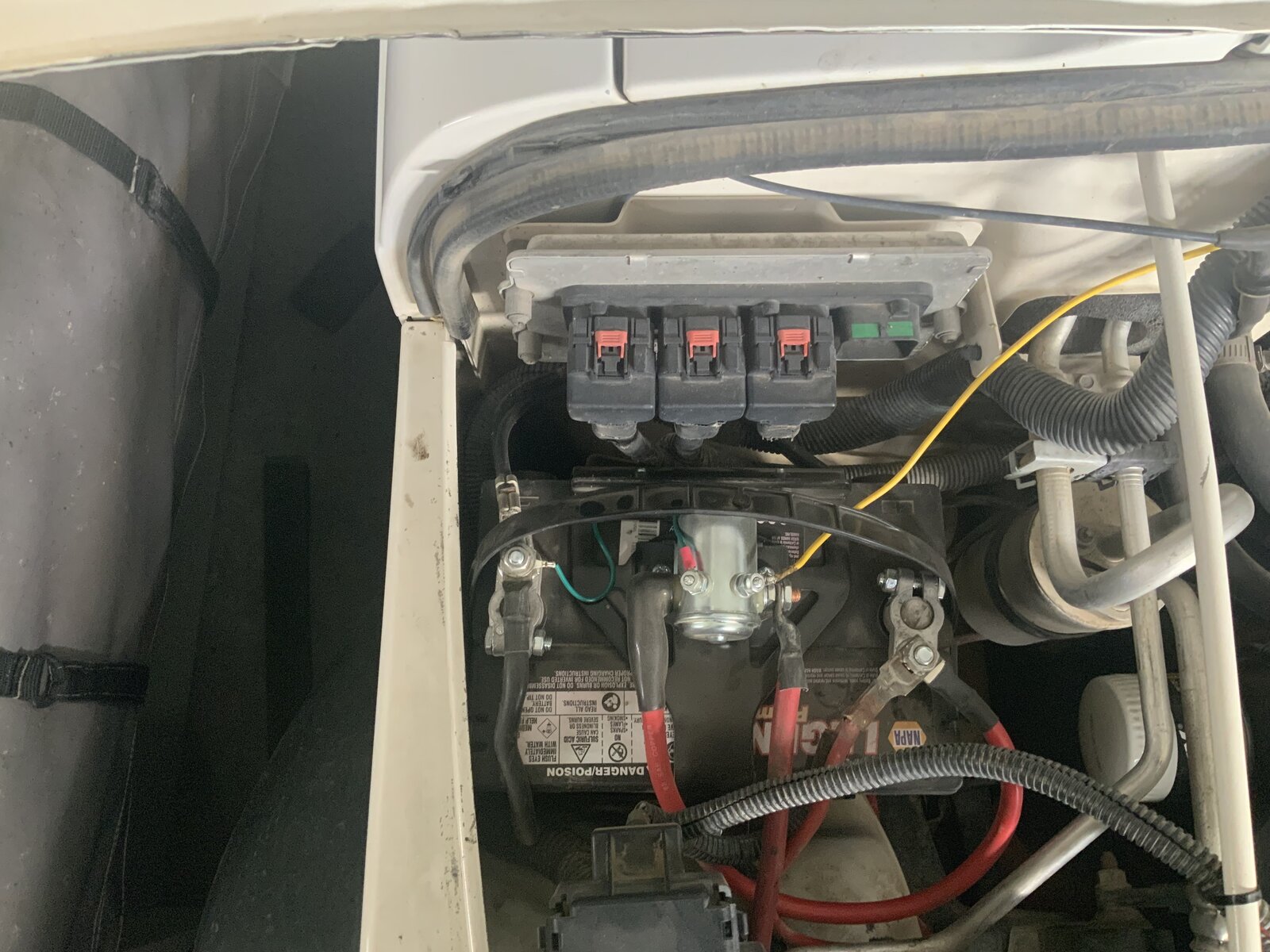

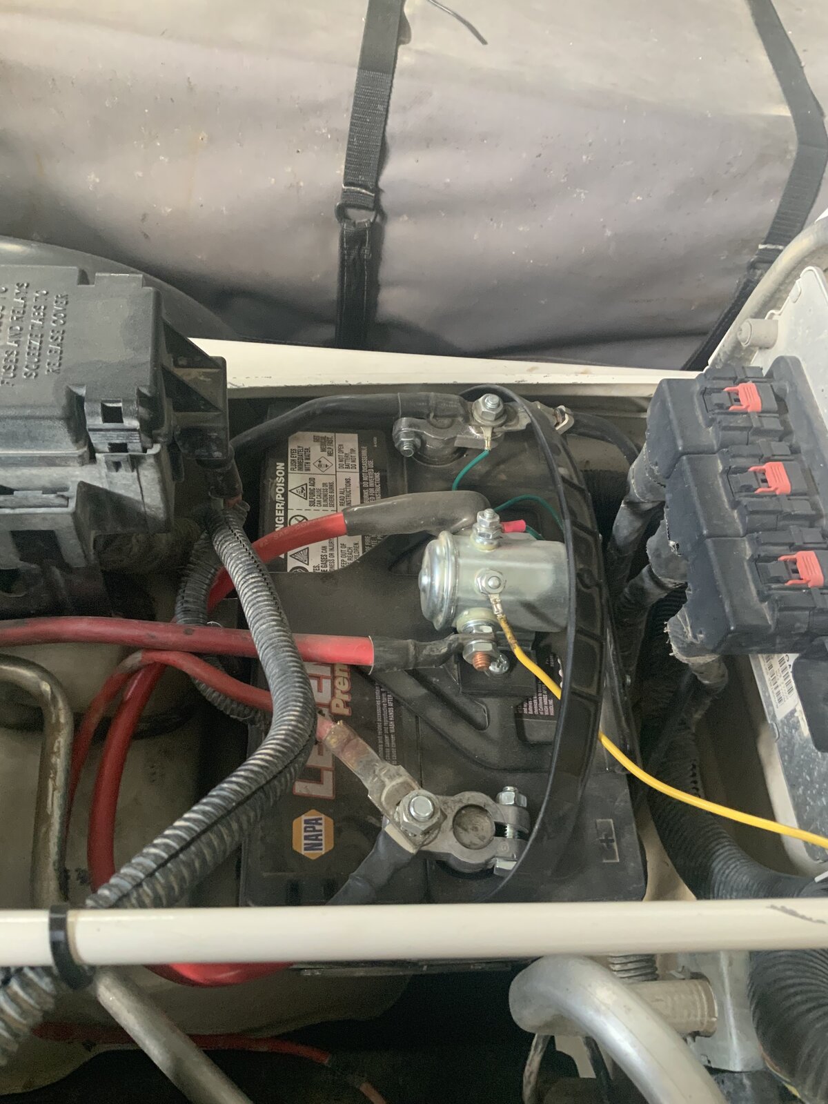

I put a Trail-Gear single battery box in my 06, and also flipped the battery so that the negative post is on the fender side. It is solid and the steel top of the battery box gave me a place to mount the solenoid for my winch disconnect.

Pics of the installation.

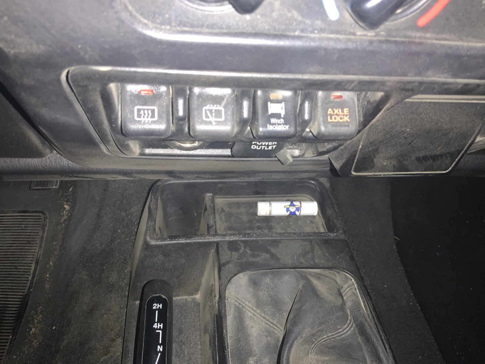

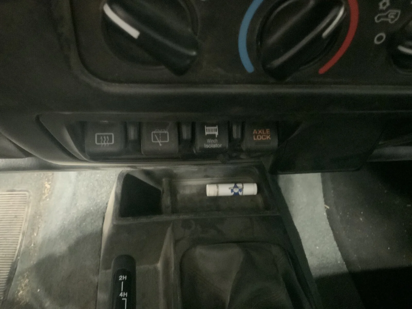

The solenoid is to disconnect the winch, and later wiring to the cargo area to a Hella plug for a fridge. I found this cool dash switch on Amazon to control the solenoid.
