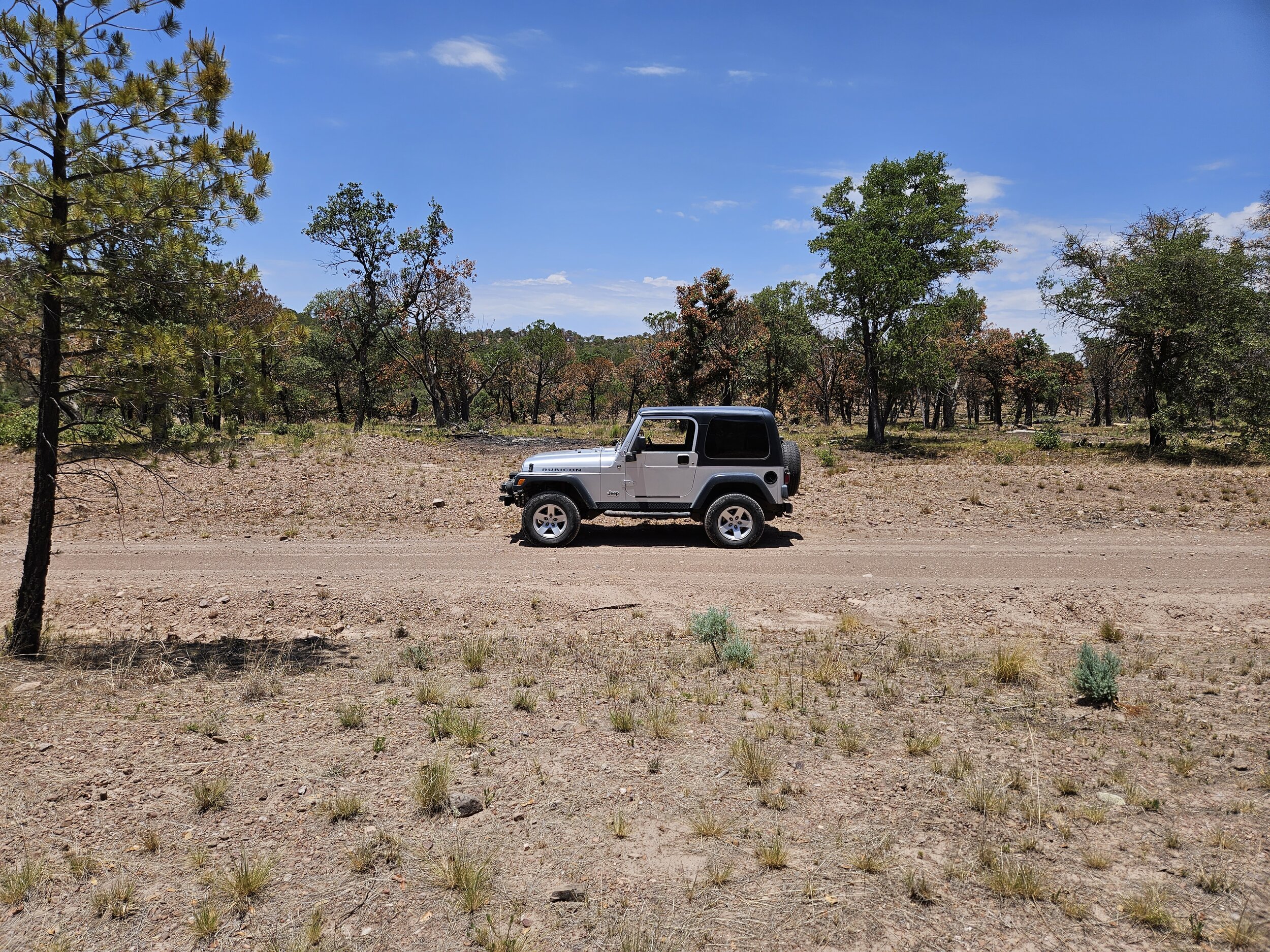

I did a 2.5" spring lift on my '05' TJR thinking that I would run 32s. Also been rolling around in my mind about adding a 1.25" body lift to run 33s. Now I'm thinking 31s because it's hard enough to get in with the 245/65/16's with just the 2.5" lift. Being retired and limited funds I think brings me back to reality. I'm pretty surprised where the 254/65/16 Walmart AT's take me down here in South East Arizona. I'm thinking if I ever make it to Moab, I will go wherever the 31's or 32's will take me. My jeep as it sets now.
