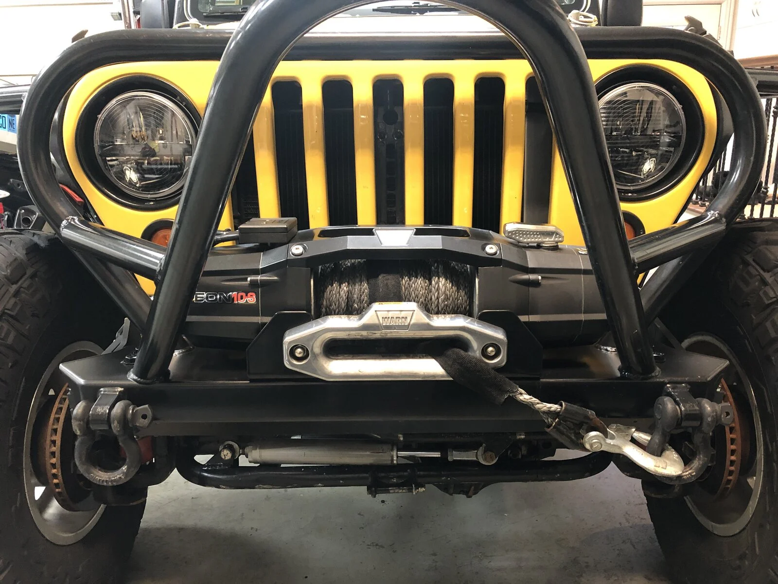

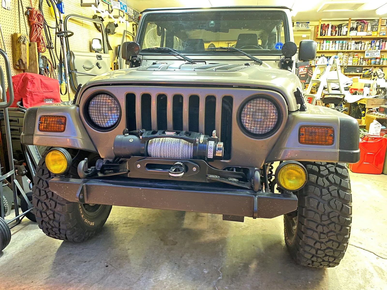

Moving the solenoids/contactor under the hood might clean up the looks of winch and bumper. That is why I did it a long time ago. Mine lives near the factory relays.
This is my primary reason for considering moving mine. I like the idea of exposing more of the seven slots, along with the balanced symmetry. @MountaineerTom moved his and I like the look.
Yes, a cleaner look was the main reason I moved mine. I’ve been happy with it.

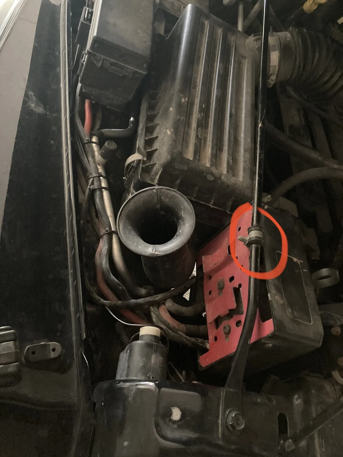

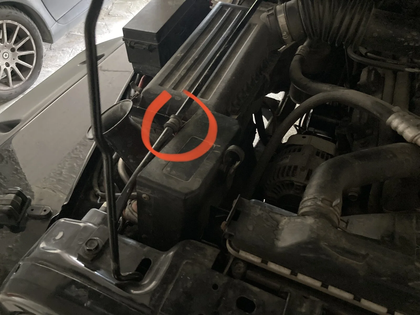

Indeed. But I guess it's easier to have to use less of these thick wires that the winch requires and safer to have it protected under the hood. In my case, I have the control box tied to one of this longitudinal rods that run under the TJ's hood. This way I think it's better protected from water crossings. Can post a pic tomorrow.
@Andymc79 A couple of pics of how it has been mounted under the hood.

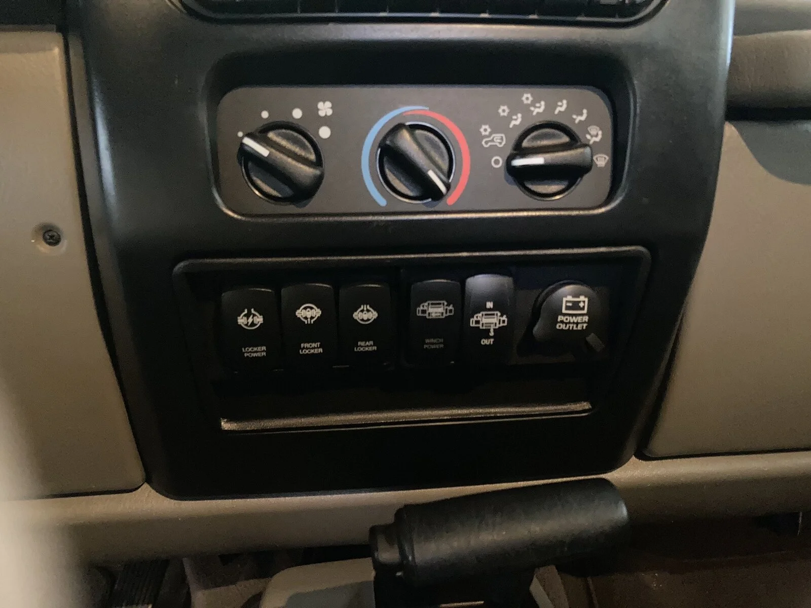

It is custom made from aluminium painted black and is indeed mounted below the A/C controls where the stock switches originally were. I had searched a lot to find a bolt on solution for what I wanted but none of the ready to be installed products online fitted my needs. Essentially, it's a combination of various designs I have seen tailored-made to what I wanted. Can revert with a close-up pic of the panel installed.
Here is the pic of how it looks installed.
After giving it some though and considering that none of the bolt on panels I could get my hands on didn't really fit my needs or liked the way it looked, I took the decision to create a panel from scratch.
My decision to go with a soft top justified the idea of deleting the rear defroster and rear wiper switches (which I didn't use a lot even when the hard top was on the Jeep). It was hard top jeep from factory so all the necessary wiring has been kept in place in case I want to install a HT again in the future.
Same goes with the overdrive switch which throughout the years I have been driving the TJ, I felt almost never the need to switch off (no towing needed/intended with the TJ).
Finally, with the power plug being used in the majority of cases with a USB adapter on and as a charge point for phones, losing one of the two was not issue for me (or least I though so, we''ll see...). To note that I kept the power outlet on the right that provides power even when the engine is shut off since it could be proved useful to keep charge a phone while breifly stepping off the Jeep or keeping a cooler plugged in in a trip.
As a result, and taking under serious consideration my OCD telling me to do something clean and neat :rolleyes: I created this off road dedicated switch panel. Is it based on the frame that was there from the factory on which a 2-step aluminium plate has been welded.

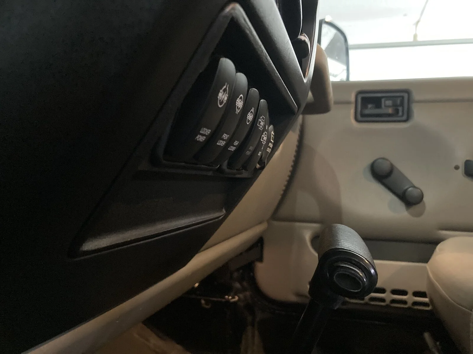

Although initially I was thinking of angling the surface and do not brake it in two steps, I though that (1) visibility of the switches and (2) interference with the auto trans T-handle could cause issues.
Thus, I broke it down to a two step with the first one being the main where all the switches and the plug are mounted while the lower part sits more close to the console to make room for easy operation of the shifter. Indeed not interference issues at all as seen in the below pic! :)

The final design was mine after taking ideas from various panels I had come across through the years, but since I have no welding skills at all, everything was taken care by a friend who is a carpenter but loves working on cars and metals. ;)
The switches and frames on which are mounted come from here: https://www.otrattw.net

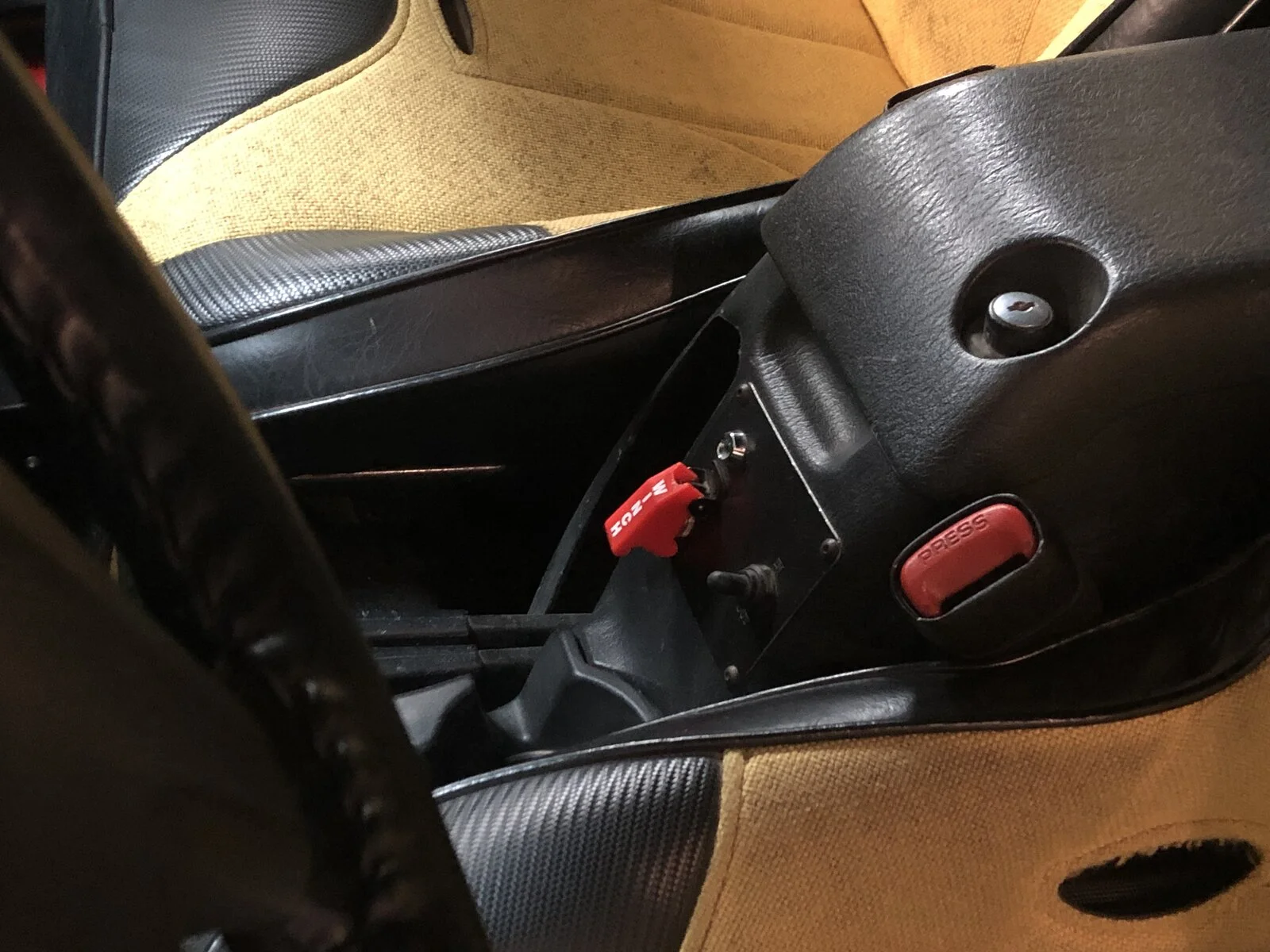

When I installed the in-cab controller, I had the same thought that Jerry mentioned - it didn't want to have to be reaching for the dash to use it, especially on a nasty climb. I located it on the console. I can lay my arm on the arm rest and my hand drops right to it. Having used it many times in some crazy nasty situations, I'm glad it's there.
