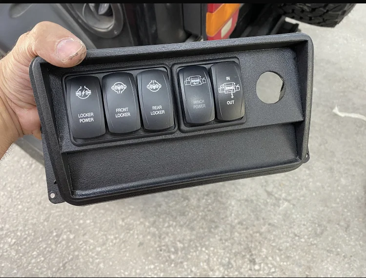

These two are exactly the same reasons I have relocated mine under the hood. Personally I disliked the view of the box hanging on top of the winch on on side and secondly I have constructed a panel that includes all off road related switches including a winch power switch and an in-out switch.

Here is the custom made switch panel I was referring to btw.

@Kon is that a panel you printed or purchased? I'm assuming it goes below the hvac controls?
It is custom made from aluminium painted black and is indeed mounted below the A/C controls where the stock switches originally were. I had searched a lot to find a bolt on solution for what I wanted but none of the ready to be installed products online fitted my needs. Essentially, it's a combination of various designs I have seen tailored-made to what I wanted. Can revert with a close-up pic of the panel installed.

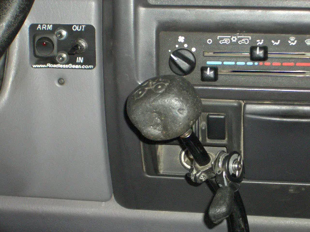

For the control switch, I mounted a remote winch switch onto my dash in my previous TJ but having to hold my arm out continually while operating the switch was nothing I cared to continue with on my second Jeep after that Jeep was stolen. Instead I use the standard Warn remote control and simply run its wiring behind the radiator grill and around the driver's side mirror and lay the hand control on top of the dash. When I need to use it it's far more convenient to grab it and then hold the control in my hand than it was when I had the switch I added mounted on the dash.
This is how I did it on my last TJ and I wouldn't put a switch on the dash again like I did then.

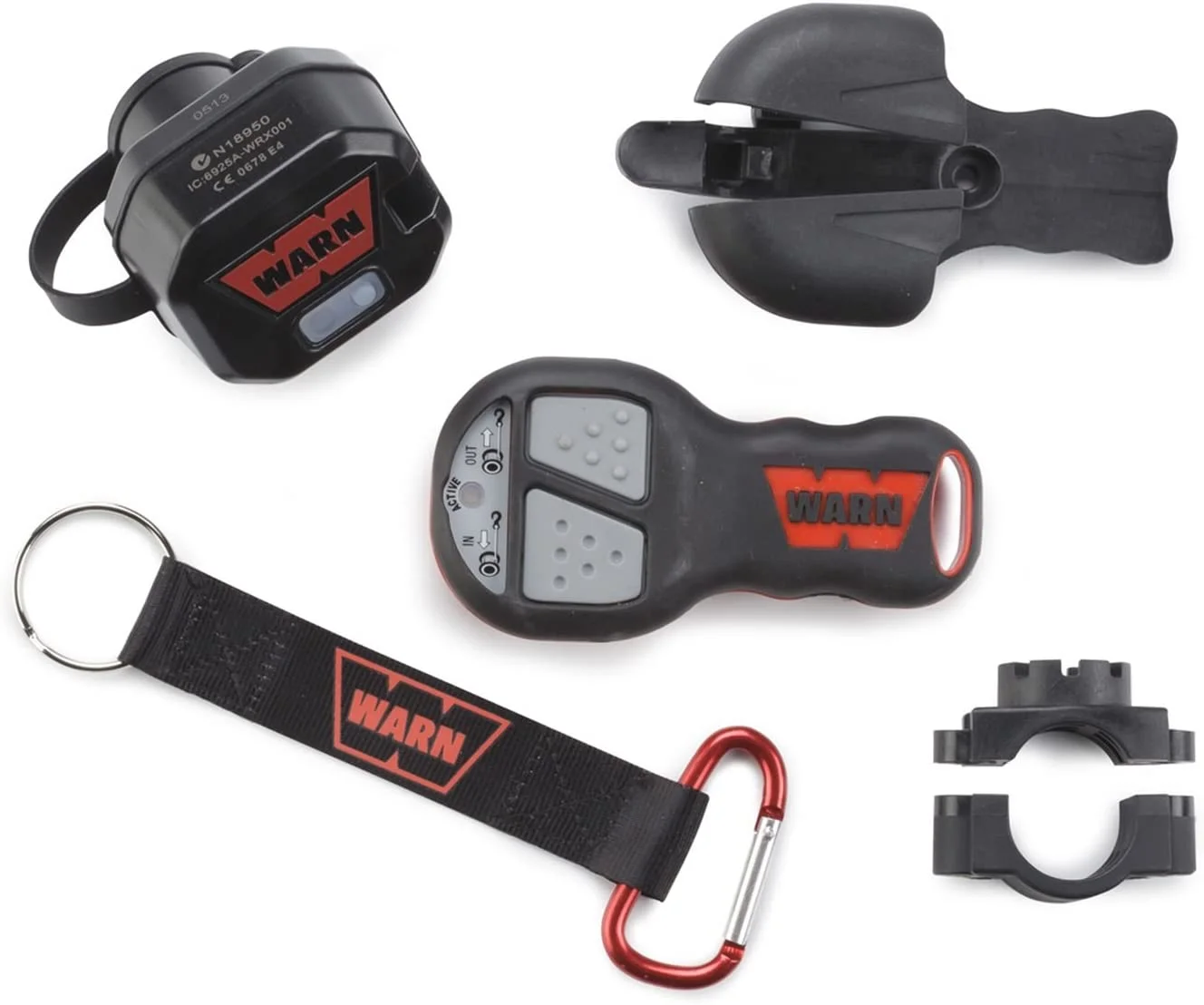

This reminded me that when I bought the Warn 9.5XP, one of these was in the box!
On my secomd one of these replaced under warranty. Failed after 6 months. Not saying this is a pervasive issue, but dont count on it when you need it. Always keep the wired controller with you just in case. It is convenient though.
I carry a recovery bag and the wired controller is always in it! (y)
