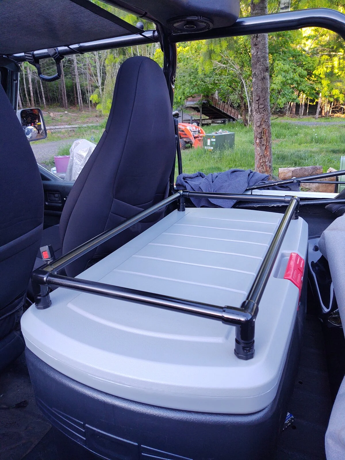

Folds up and can be placed beneath my rear seat no issues.
Got this idea off YouTube. Works well!

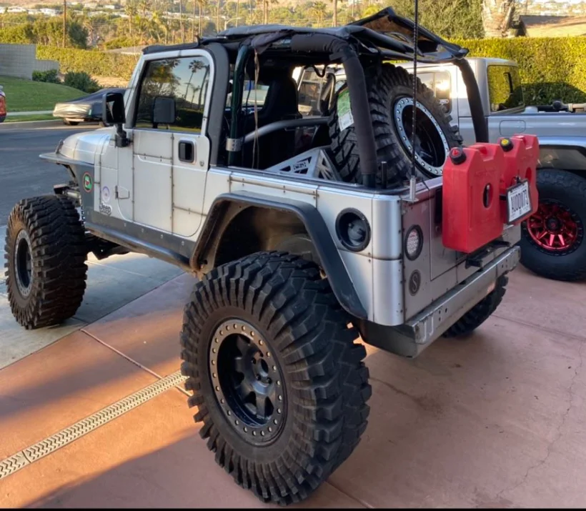

I was busy looking for the spare tyre relocation rack to inside the tub in Craigslist.
I guess you don't carry much in the rear cargo area? It's so small as is .. Can't imagine putting the spare inside the vehicle.

A lot of folk carry the spare in the tub in the desert southwest. You center a 35" and pack everything around and overtop of it. A rack makes it easy to carry stuff on top of the tire as well (that's what I think @starkey480 is doing with the BestTop rack I sold him).

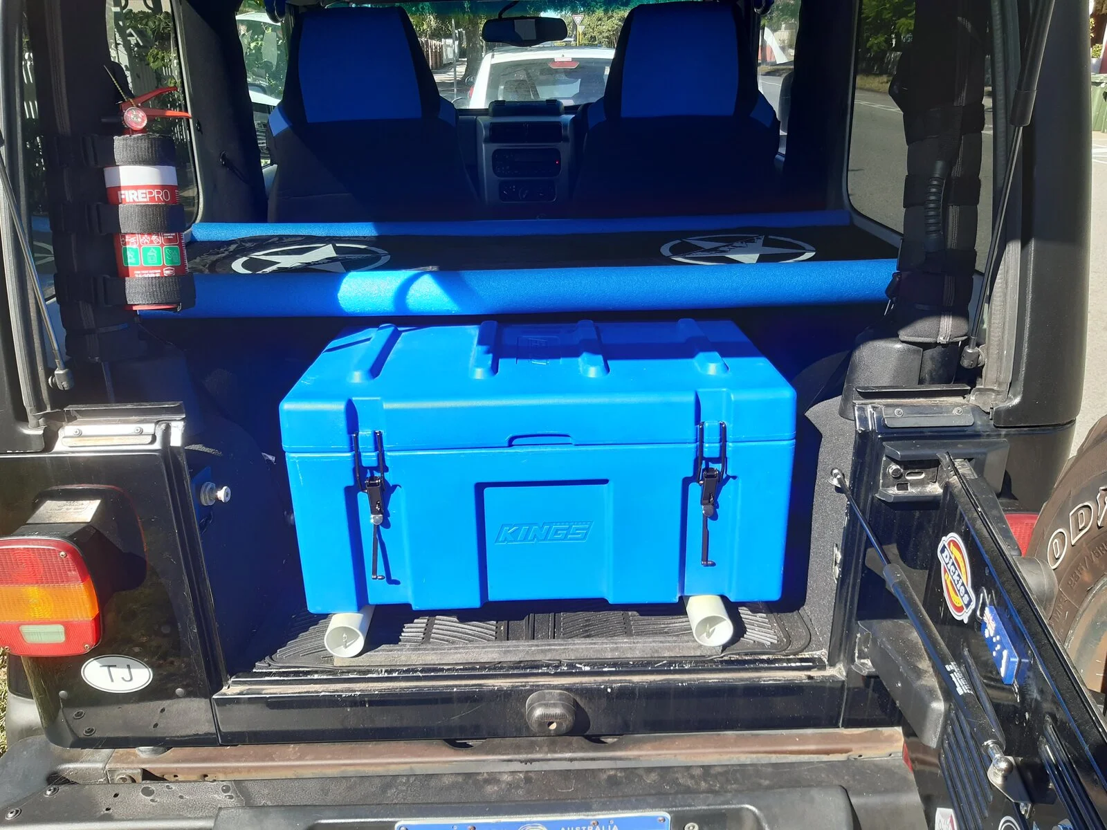

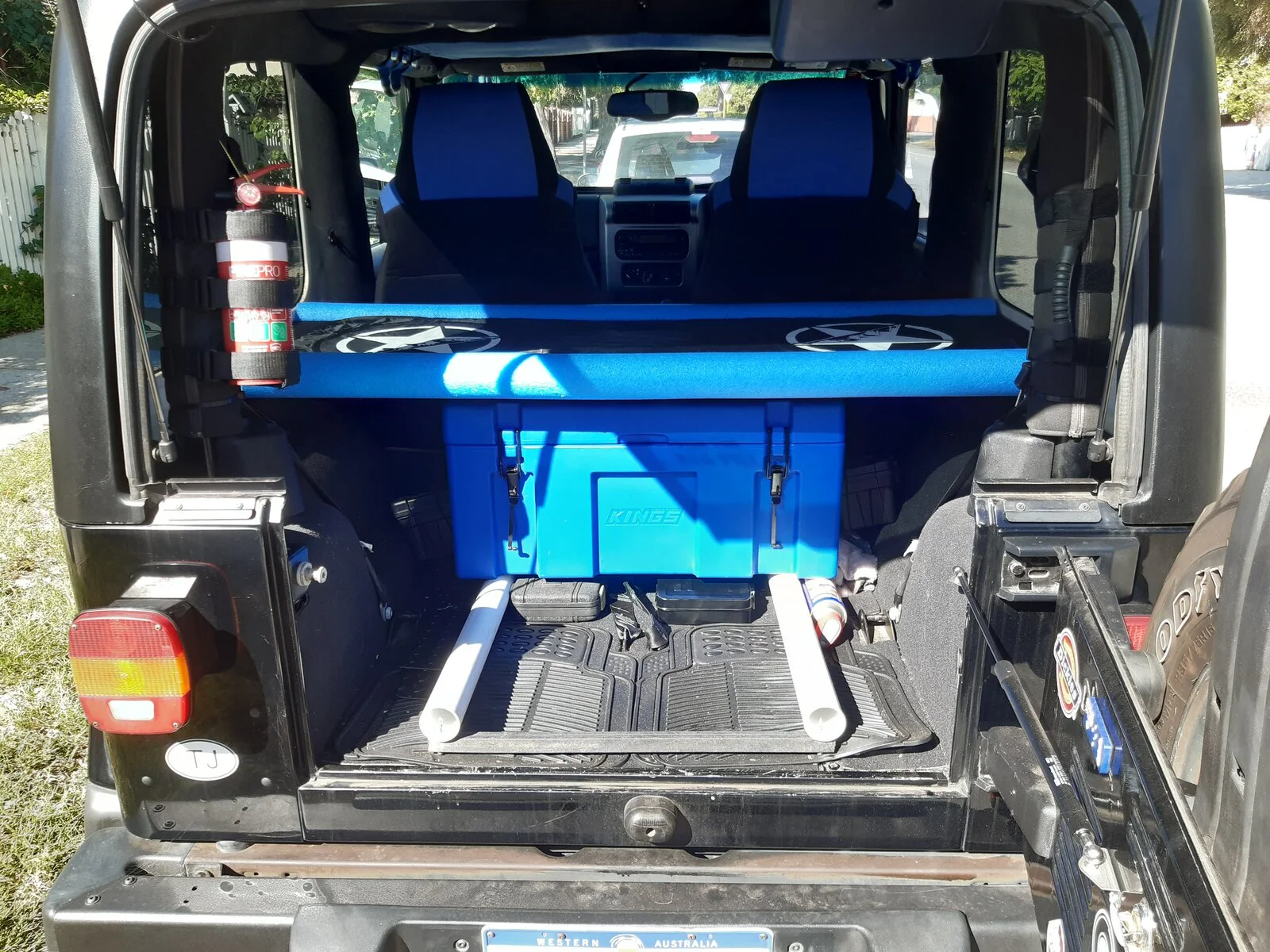

If your hardtop is on you can span the entire width above the arches with a piece of carpeted ply, that's what I have done, I can fit 2 pelican cases underneath cost less than $10, I made it narrower so it slides forward to the seats or back to the roll bar, it was just temporary to begin with but I have not bothered changing it because it works so well. The 50mm pvc pipe is angled back and makes a cheap slide for the cases that clears the rear seat brackets and seatbelt bracket.

And it's blue!!!!!

I think yellow would pop better and give you a better shot at ride of the month!!!!
