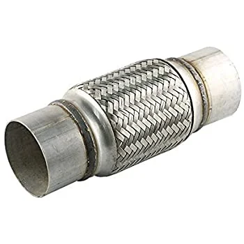

I also remember another user having a eurocar flex pipe put on part to help with the manifold breaking every few years.

Definitely add in a flex coupler to prevent the manifold from cracking, it really helps on the 97-99 4.0L engines.

Tell me more about this flex coupler. Where does this go in the exhaust system? I have a 1998 model, and I am on my third exhaust manifold.
I'm planning to have it put after the exhaust wraps around the passenger side this let's the cat/muffler pretty much mount to the frame and allows the engine to move on the engine mounts a bit.
The best place is somewhere in the down pipe between the manifold and the cat converter. I have a new manifold and flex coupler waiting to go on mine, and I'll put it right in front on the piece that snakes around the oil pan.
