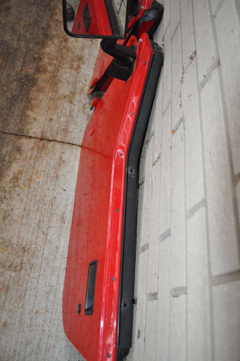

This is a pic of the top of a YJ half door but it's basically the same as a TJ door. It shows what the pin inserts look like when installed. The interior door panel has to be installed first and then the pins are inserted. They're a friction fit with a spring of sorts that holds the upper half pins in firmly. It takes a bit of force to install them … just line them up and pound them down with your fist.
It sounds like someone might have "customized" what you have. Hope things work out OK for you. 👍
