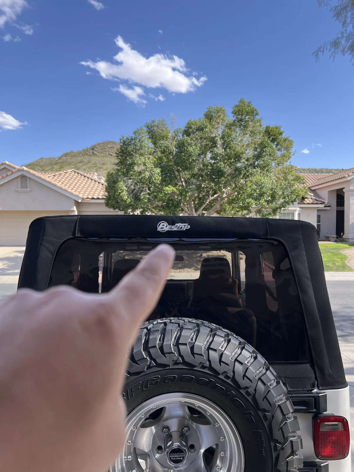

So, I went ahead and splurged … 😬… I was on the phone with Bestop hoping I had some warranty on my SuperTop NX, but I was just a couple years past… all well, I decided to splurge since I was on the phone with Bestop and get the BLACK TWILL for the LJ. Finally we long butt Jeeps hat a quality top!!!
HOWEVER!

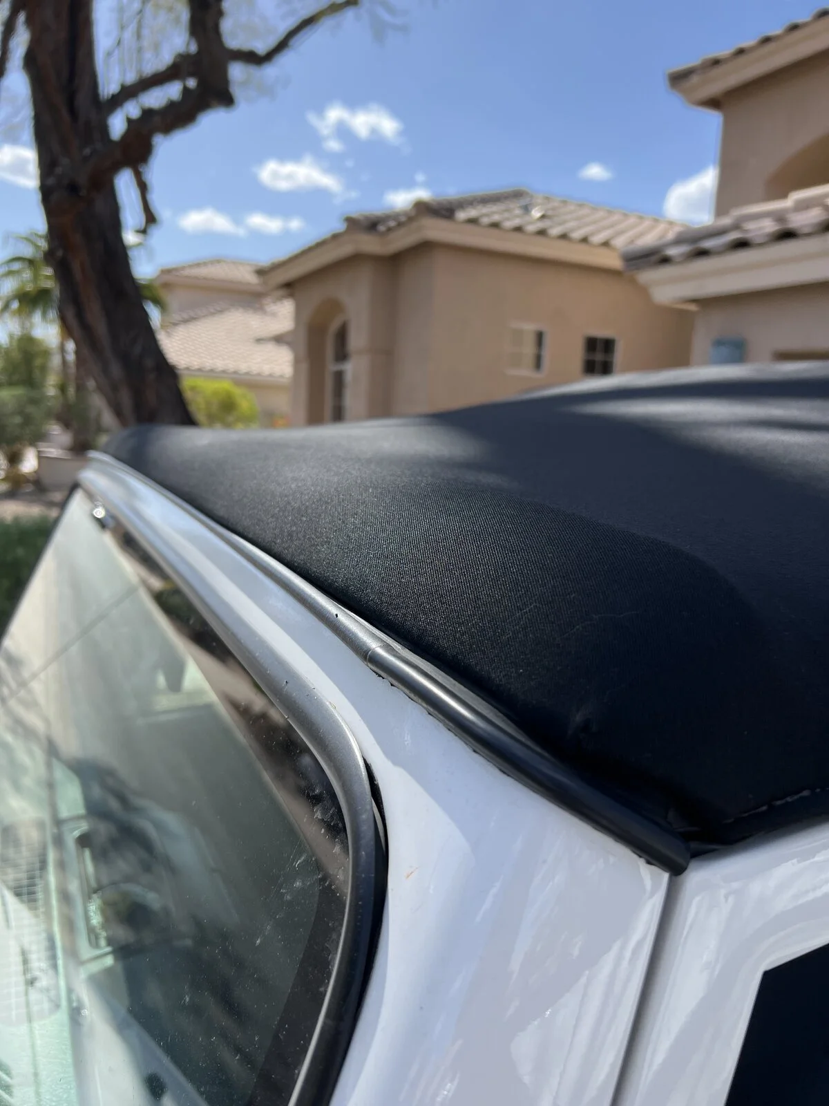

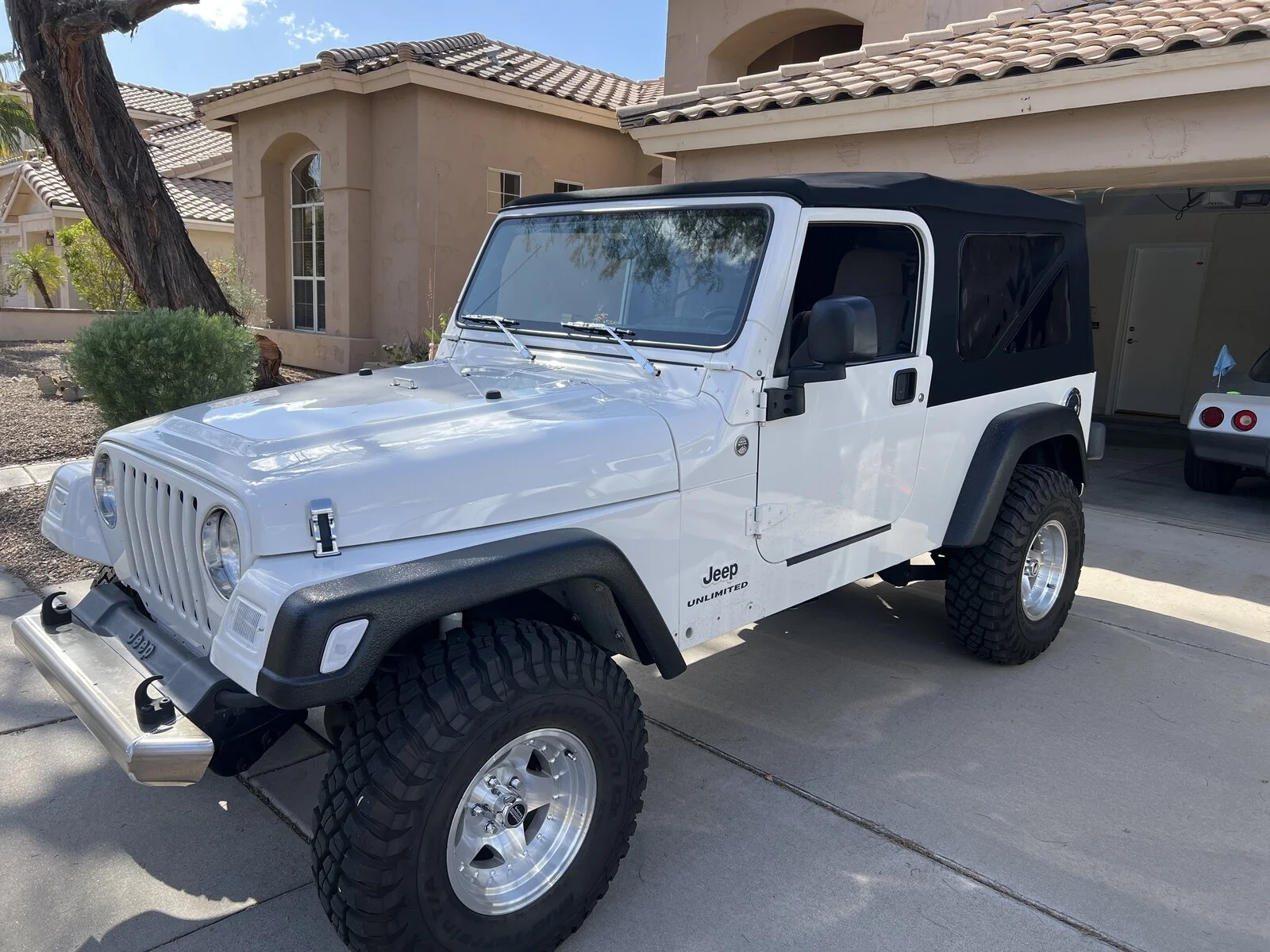

I am not sure Bestop did a very good job retrofitting the twill to the LJ platform. It fits a little crooked and it’s actually LOUDER than my used and tired Super Top NX!

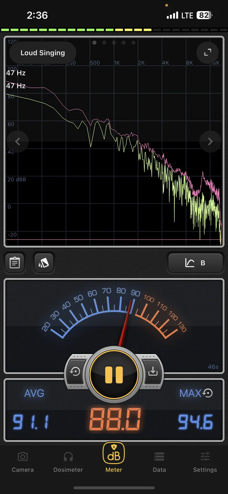

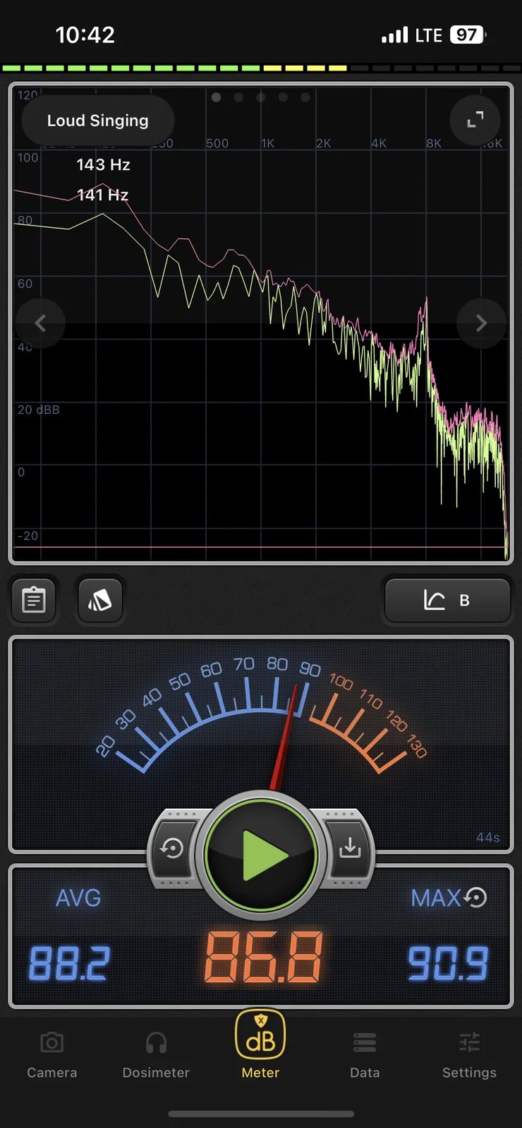

I did a decibel meter hoping to be blown away with the difference. Here is a decibel meter snapshot of a specific stretch of road, same speed of 50mph, 5th gear, no HVAC, no radio and no cars around me.
OLD FLOPPY TOP
Same setup, this is the black twill
Well, this is disappointing…
I’ve had 3 TJs with Mopar soft tops (one dual top) and 3 LJs with Mopar tops (one dual top). I have gotten rid of every hard top because I thought the soft top was just as quiet unless it’s flapping… I very much HATE hard tops…
I have had 3 JK unlimiteds, 1 factory twill top, one hard top that I sold for a mopar Khaki Diamond (vinyl) top. And another with hard tip that I didn’t keep long enough to sell the top (haha) … in my experience the regular black Diamond was good but that black twill was AMAZING!
Sooooo, enter the LJ. The black twill should lift my skirt just like my JK, right ?!?! WRONG! 😡
Then I realize that I totally forgot that aluminum bar that goes across the top of our heads, this will make it better, right??? WRONG. That thing just rattles and clanks around as the soft top vibrates against it. 😡 😡
It is pretty tho… I do live the look and feel of this material.
I also notice Bestop cheeped out on the hardware. The surrounds no longer come with knobs, just bolts. Ok, cheesy, but ok… a couple of the holes of the rods needed to be redrilled because they were off. The header doesn’t quite fit as well on the passenger side as it does the driver, makes a little whistle but super super minor.
Also the driver side sits an inch higher that the passenger when comparing to the tub.

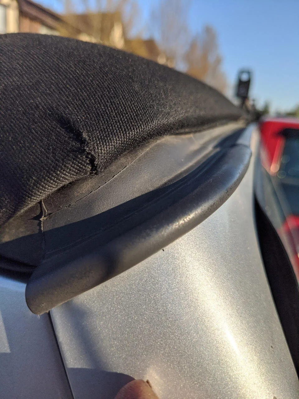

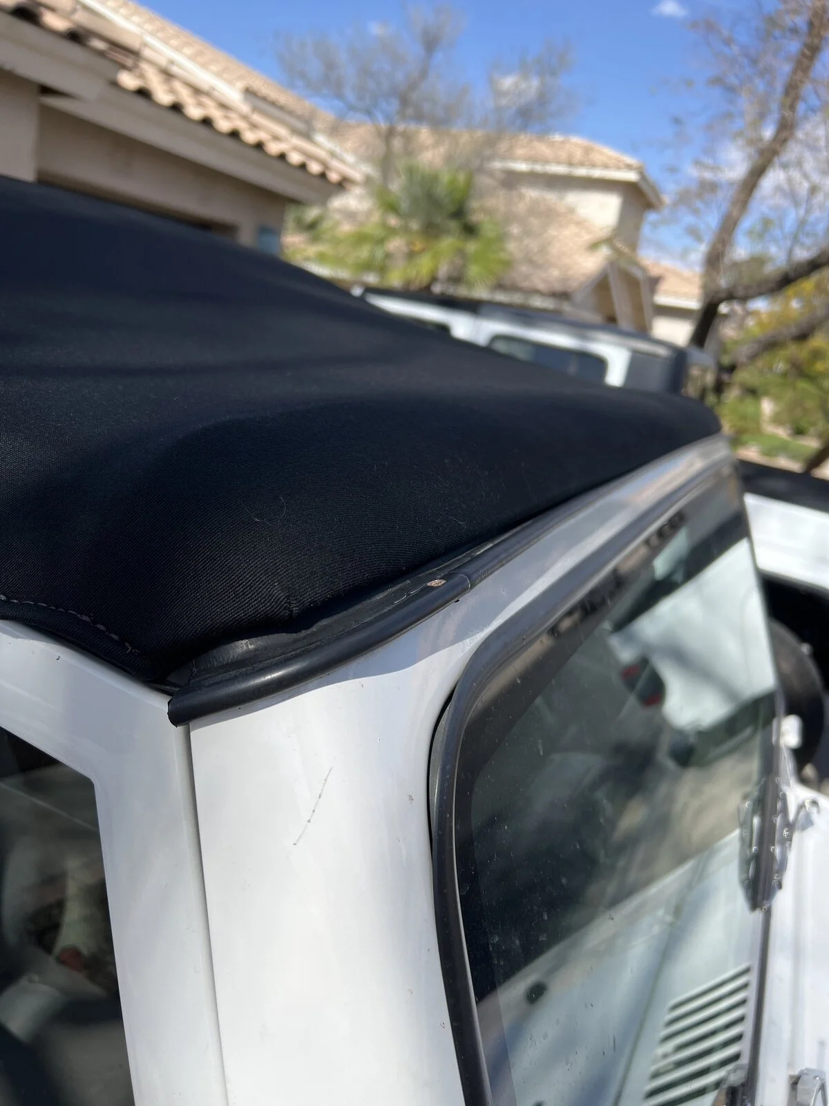

I had a similar fitment issue with my header and the twill top. It's a TJ, not an LJ. I removed the fabric from the header, then set the header on the frame to where it was even across, and then locked the levers. Lowered the side bars down to the header pegs and measured.
I found the pre-drill holes by BT were off, making the header too short in length, which gave that big gap (s) on the windshield frame. Once I made even measurements on the pegs to the new header placement and screwed it in, everything worked fine.
In the pic of your top, where the center material is flush on the windshield gasket, after my adjustment , the entire top looks and fits like that. It also cut the road/wind noise significantly.

That’s EXACTLY why I thought of doing!!! Or re bending the arch bar for a little more “reach” … but they want to void my warranty for relocating a screw hole in one of the bows (inner silver sleeve) because it was way off … so. These jerks make it real hard to do anything … I shouldn’t have said anything but I wanted them to know it was an issue. You can tell the bow was in the jig wrong when drilled because every hole and bracket on that bow rod is off the same degree …
How do you scoot forward the header on the rod? I feel the adjustment would be so minor that the hole would only need to be oblonged, but then it could scoot.
With the bare header (completely disconnected from the top material) and locked in place on your windshield frame (where you want it to seal all across), then lower the frame pole on each side to see where on the header peg they will rest. Make sure the measurement is same or close on each side and mark the pegs. Then slide the poles onto the pegs to your marks. Drill a small hole in each and lock in with the screws they provide in the top kit.
I'm guessing you have the fold-back. Unlock the header and fold it back, then re-attach your top material to the header.
I hope I've understood your question. I didn't take any pictures when I did mine, but here is a pic of a bare header with the peg.
Ray

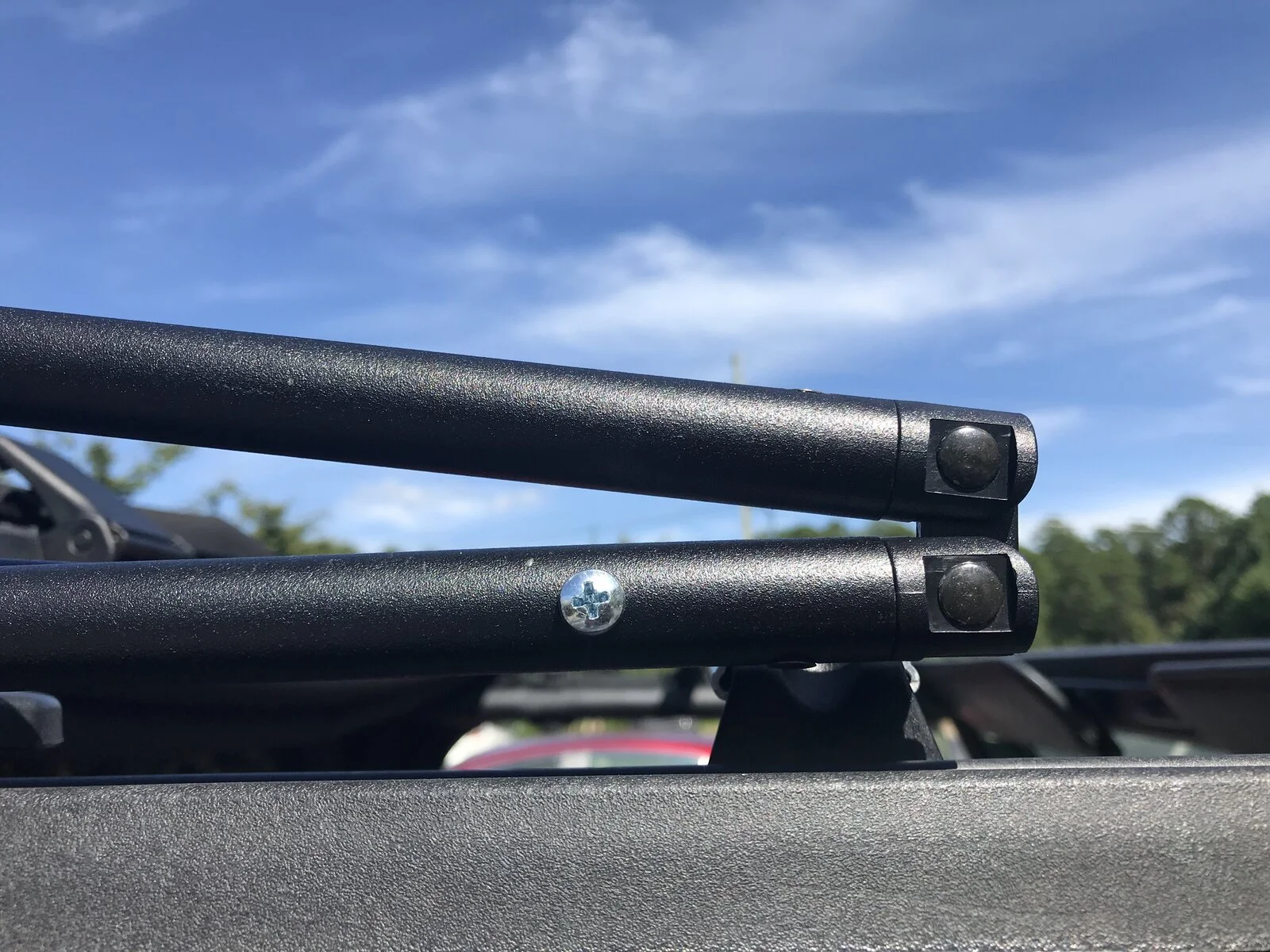

regarding the header fitment / whistle with the twill top, bestop had sent me a replacement top after shooting this photo to them a few years back. mind you this top had been installed for about a year at this point and stretch should have occurred by then. replacement top issued had fit much better along with the 2 new bows and header bar sent along too and the whistling had stopped.

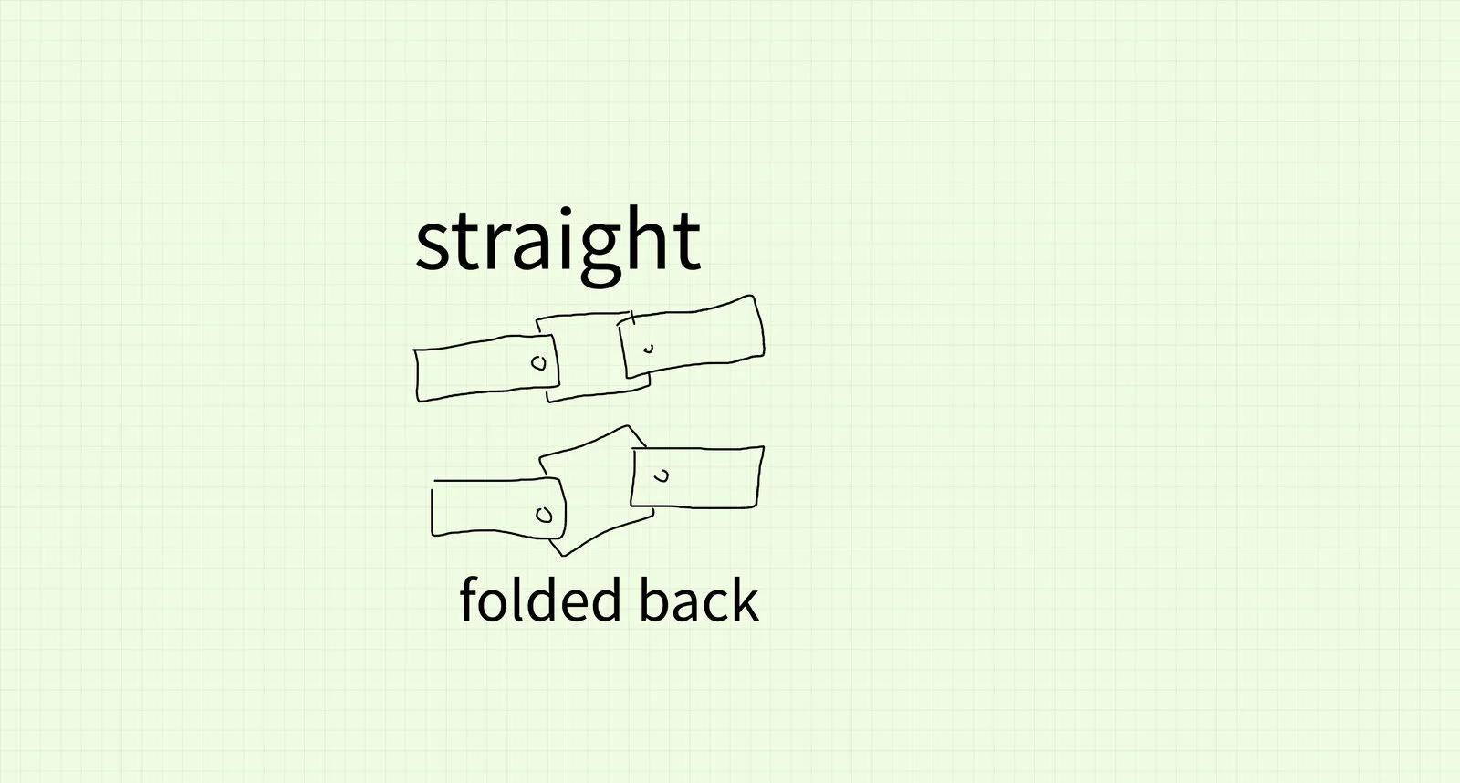

my assumption on why the header isnt fitting very well may be something to do with the silly "sunrider" feature, I see that with the top up the elbows above the door are not straight and somewhat folded back on themselves allowing for some slack in tension.. but then again the tubes are fairly light duty anyhow and I would assume that they really aren't pushing the top forward much anyhow.
by folded back on themselves I mean like a Z shape rather then a straight line.
elbows im discussing
its been years since ive been in a jeep with factory (non bestop) softop hardware.. im talking maybe 20 years ago. so I dont have anything to compare it to. but I suspect the minor amount of play in the elbow may be restricting the forward push of the top fabric to the front header seal.
the sunder feature is useless imo anyways. ive had the locking pins above the door come loose when driving with the sunder open and had the pins give loose and the top drop on me a few times. my top has since the occasional oh shit times just either been fully up or fully down.
So, on my 06 with a factory soft top. there is a sleeve that slides over that knuckle to keep it straight and true... another cost saving measure by bestop. They also got rid of the door surround knobs and replaces with screws. I been looking for those sleezes to retrofit on my bestop bows. I do see a value in that sleeve.
Reactions: Fulton_Hogan
🤯 cost saving.. its a feature :ROFLMAO:
the bestop tube at my elbow joint measures out to 3/4" OD and 5/8" ID. ill probably end up exploring my options at the local hardware's for some sort of tube I can cut to make a sleeve with a inner diameter of 3/4 that I can fab up for shits and giggles. looks like a sleeve may fit over the elbow joint too. dont see this as much of a solution though, more of just a thought.
