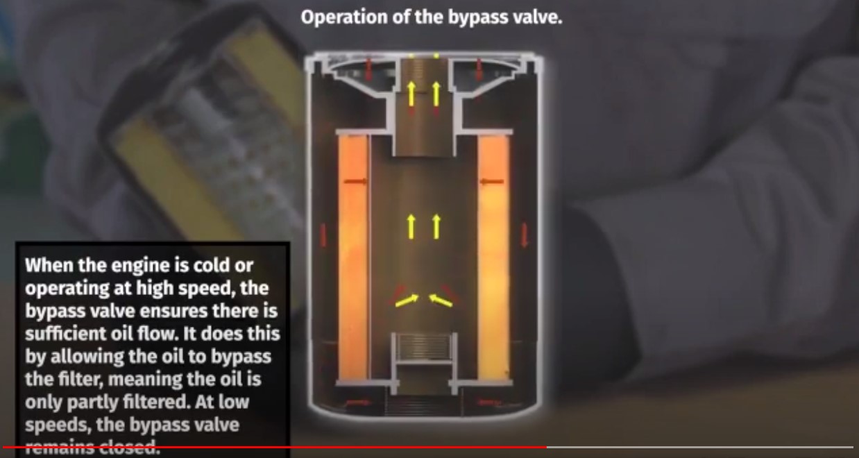

Keep in mind that bigger oil filters don't filter any better, they can just be used longer before getting so clogged they go into bypass mode.
