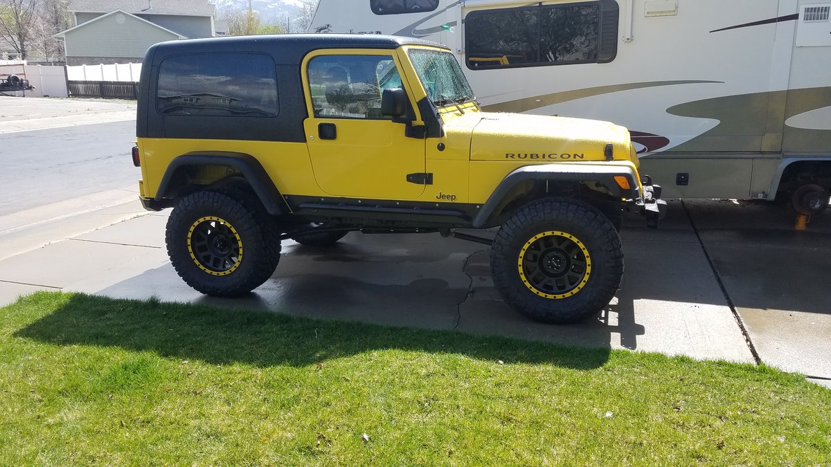

The Jeep had a set of 35" B.F. Goodrich Krawlers. I understand that they are great rock crawling tires but I can tell you one thing for sure, they are miserable road tires. It was time to start looking for some different tires.
The picture shows the Jeep the day we brought it home.

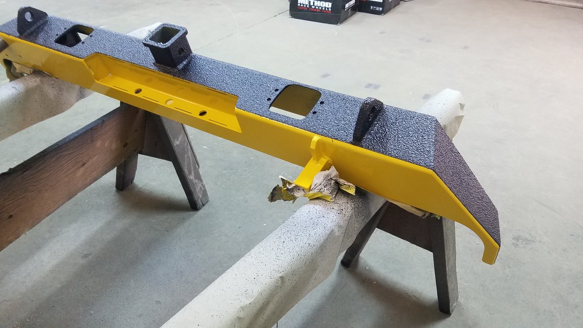

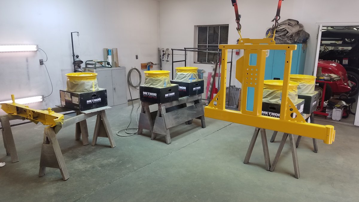

The wife and I had registered for the Easter Jeep Safari in Moab. Since it was now getting toward the end of November, I knew it was time to concentrate on finding a solution to the problem with the ECU/PCM. I began scouring the internet looking for a possible supplier. This would end up taking a lot longer than I had anticipated.
I felt it would be in our best interest to get a replacement PCM before the trip to Moab. There were some other issues that needed to be addressed as well. When we purchased the Jeep, it did not have a spare tire, or even a spare tire carrier. The guy that sold the Jeep to us, told me when we first looked at it, that he had owned several TJ Jeeps and liked to buy and sell them regularly. Again that didn't mean anything to me at the time, but now we had the Jeep at our house, and I had been using it for a couple of months, I started to notice a few things about it. Why did it not have a spare tire carrier? The rear bumper had no end caps on it and there was a brand new Reese trailer hitch mounted under the bumper. I could also see wear marks on the grille where cables had been routed to a winch at one time. There were small holes in the dash and console where I am guessing a CB radio and microphone had been mounted. I could see marks on the left rear downtube of the roll bar left behind by a fire extinguisher?
My gut feeling is that the seller had purchased this vehicle knowing all about the PCM issues, and stripped all the goodies from it for use on another Jeep. Then he just waited for someone like me to come along and take it off his hands. I realize that when you own a vehicle, you can do whatever you want with it. I have no regrets about our purchase.

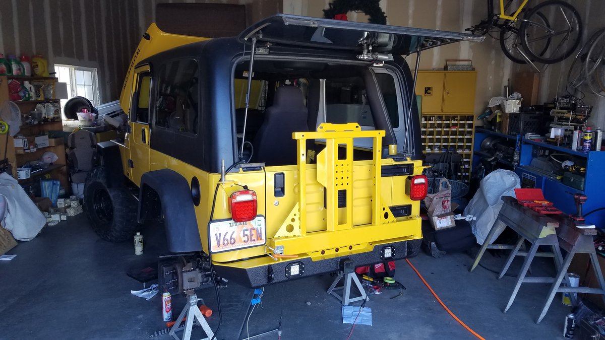

To my mind, it is a good thing to have a spare tire on the vehicle when you travel. So that state of mind led me to search for a new rear bumper with a tire carrier. I found one I liked that was manufactured by LOD. So I ordered it up and specified that it be shipped in bare metal. That thing about being a painter..... At the same time, I found some new wheels and ordered a set of tires. Of course I had to get 5 wheels and tires. It's a good thing that purchasing a Jeep was as much my wife's idea as it was mine. The cost of all these repairs and upgrades was starting to add up.
This shows the rear of the Jeep as we bought it. Notice the lack of a spare tire and carrier.

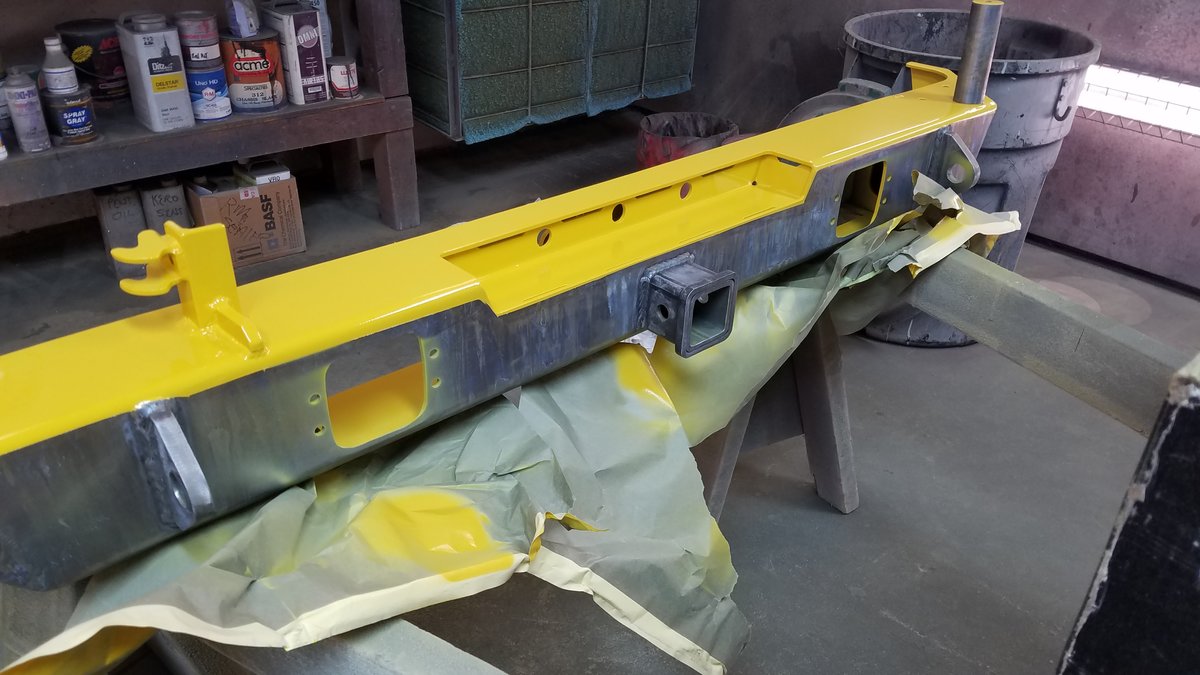

When the rear bumper and wheels arrived. I set to work getting them ready to put on the Jeep. I wanted both the bumper and wheels to look different than what most owners would do with them. The rear bumper was painted partially yellow to match the body of the Jeep. The lower half of the bumper I sprayed with Raptor Bed Liner. The idea of doing it that way was when it got scratched on the bottom, I could just use a rattle can of bed liner to touch it up. The has proved to be a decent way to do it. The wheels are not real beadlocks, just the faux version. I thought it might look better if I just painted the outer rim. Add a little accent if you will. I good friend of mine has a small paint room attached to his workshop and graciously allowed me to use the room for a couple of days.
You may have noticed that I drilled three holes in the step area of the bumper. I installed small red led lights in there.
View attachment 142064View attachment 142065View attachment 142066View attachment 142067View attachment 142068View attachment 142069

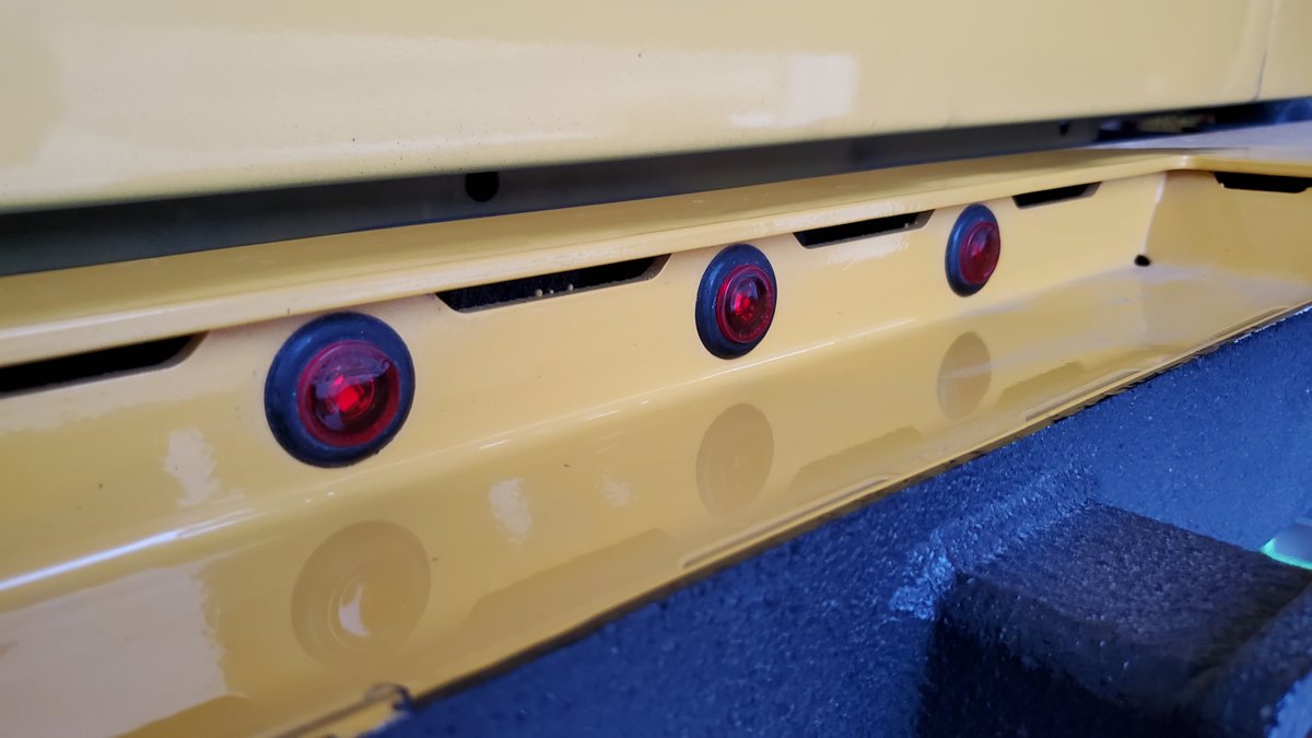

I have the same LOD bumper/tire carrier and was wondering what the three round holes were.
Any pics of the lights installed in there? Sounds like a neat idea.

I will take a close up photo of the bumper with the lights and post it. Won't get it done until tomorrow.
If I remember correctly the lights are 3/4" diameter (anything larger would not fit in the space), I found them on Amazon.

Ah I see, I bet I know what they are. I used some 3/4 round LED's in my empty spare tire lug holes as 3rd brake lights after installing my LOD bumper/tire carrier.

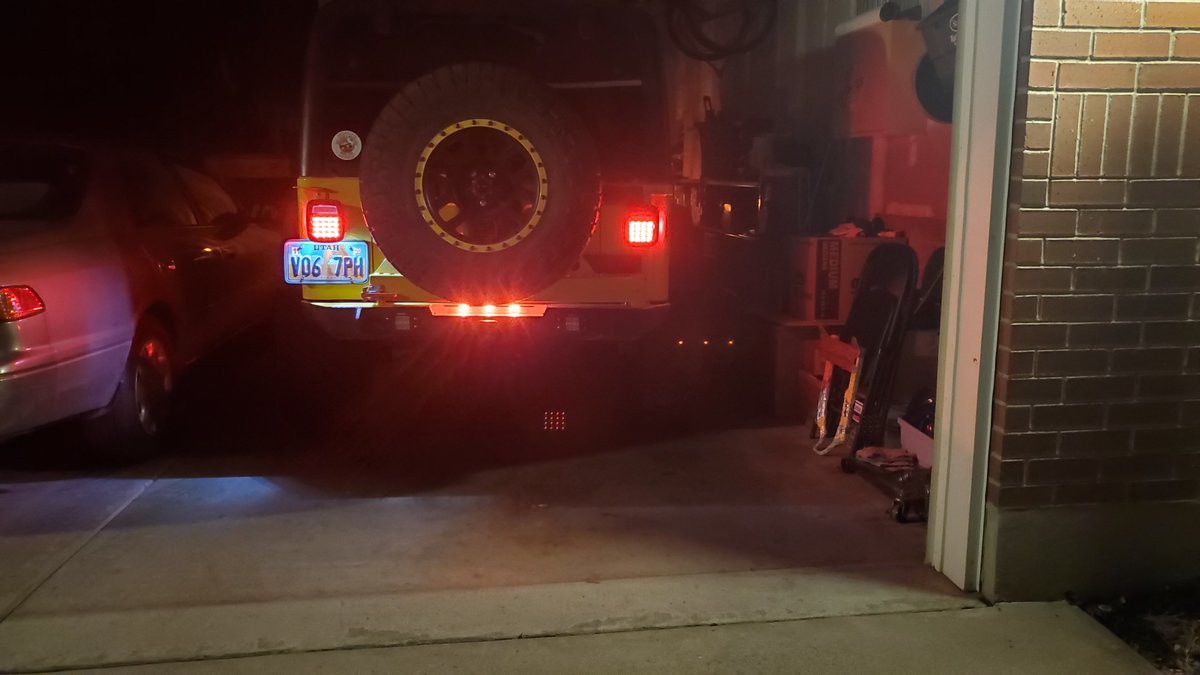

I apologize for the delay in getting back to you. My wife had some health issues that we have been dealing with. Everything is good and she is recovering nicely.
The pictures are not the best but hopefully they show what you were asking about. The small LED's in the bumper came with the rubber grommets when I ordered them. The center hole was a bit difficult to drill. I used a 3/16" bit to make a pilot hole and then a unibit to get to the 3/4" finished hole size. I could not use the unibit in the center because the bracing for the hitch receiver is in the way. For that one, I had to use a die grinder with a carbide cutter to enlarge it. Not a perfectly round hole when I finished, but the grommet covers it anyway.
You can see in the photo I took after dark that I have also swapped out the original tail lamps for a set of LED style. I got them from Quadratec and they are quite a bit brighter than the originals.

No problem, I’m glad she’s doing well.
That looks really good! I just recently put the same tail lights on mine.
