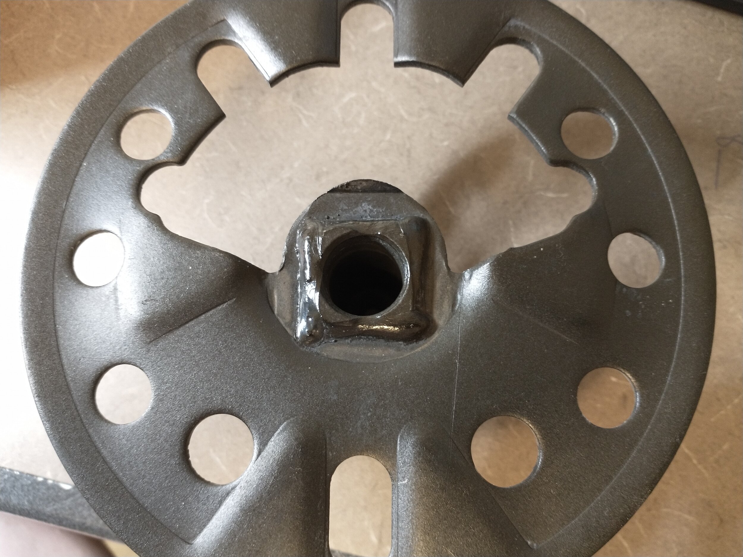

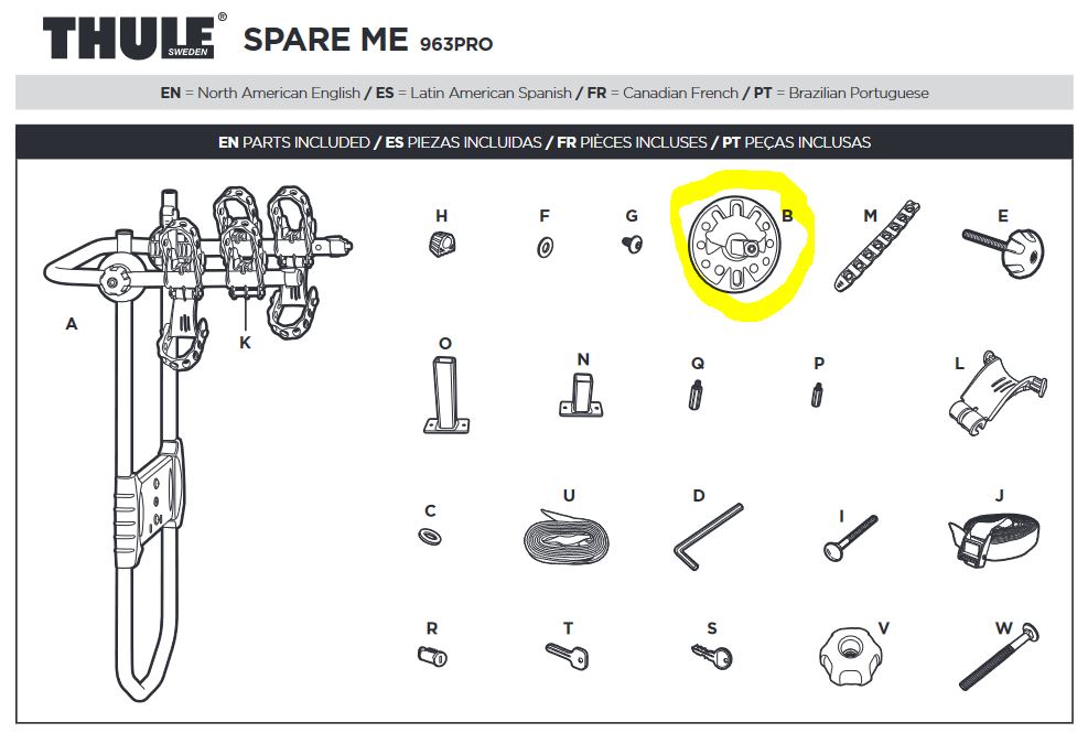

Forget all of that...I think the Thule mount might work with your setup as is....check this photo of the back side (front of vehicle) of item B, the mounting flange...
That bore in the center is ~ 3/4" in diameter, it should clear your bolt. If you think it might work, I can send you my flange to test fit before buying anything.

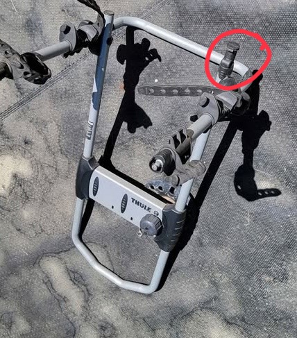

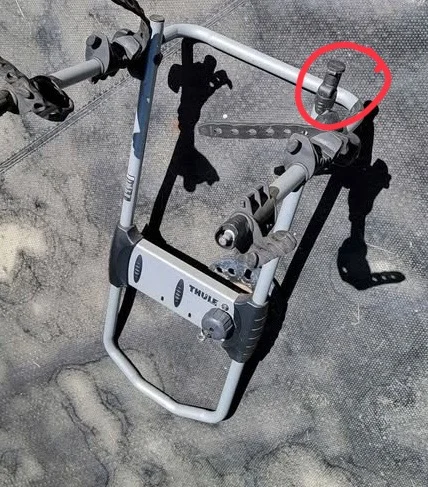

What's the black component on the top of the passenger side upright?

And I see that the piece at the top right is the locking cable extension. Might not need that.

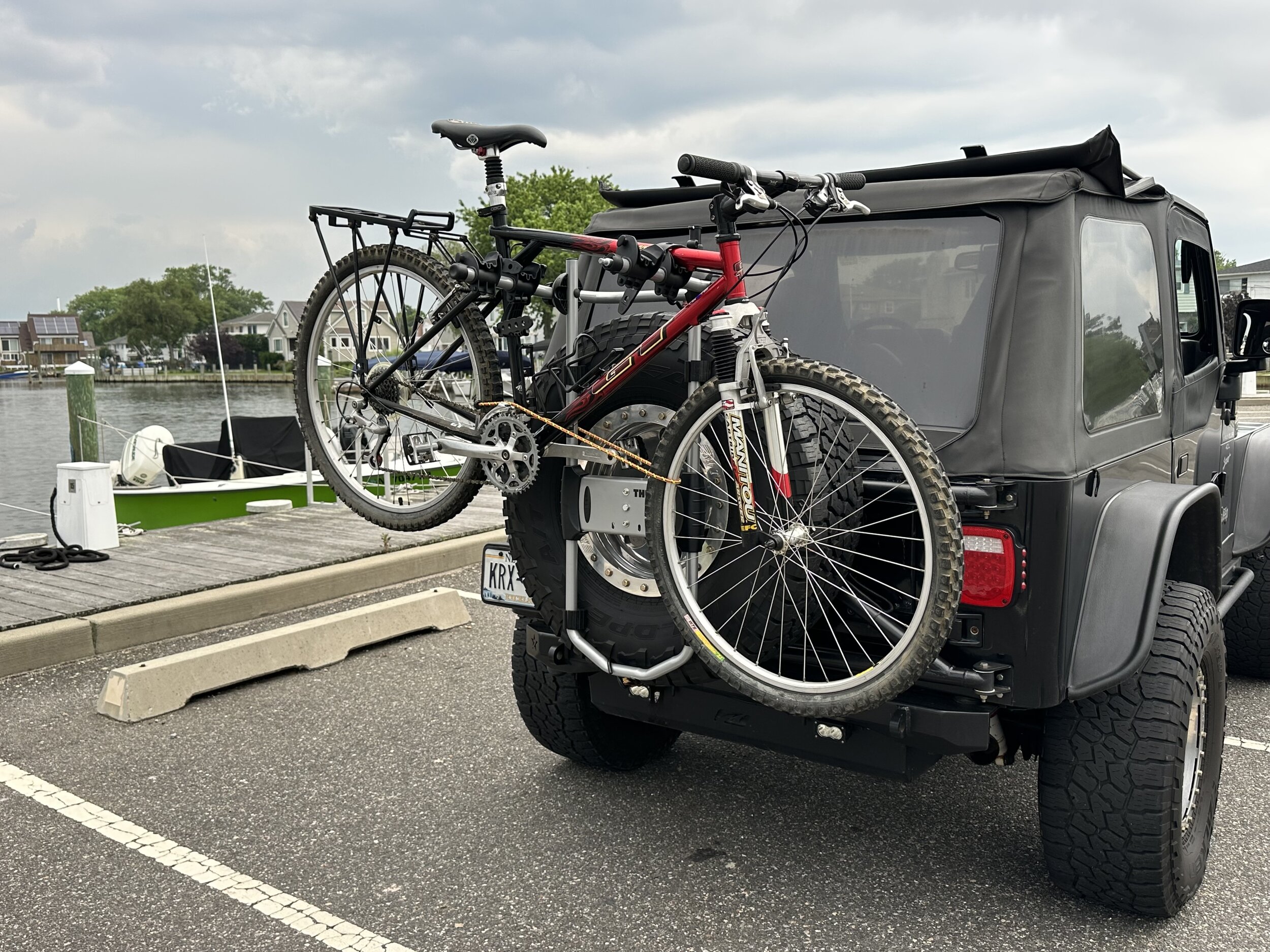

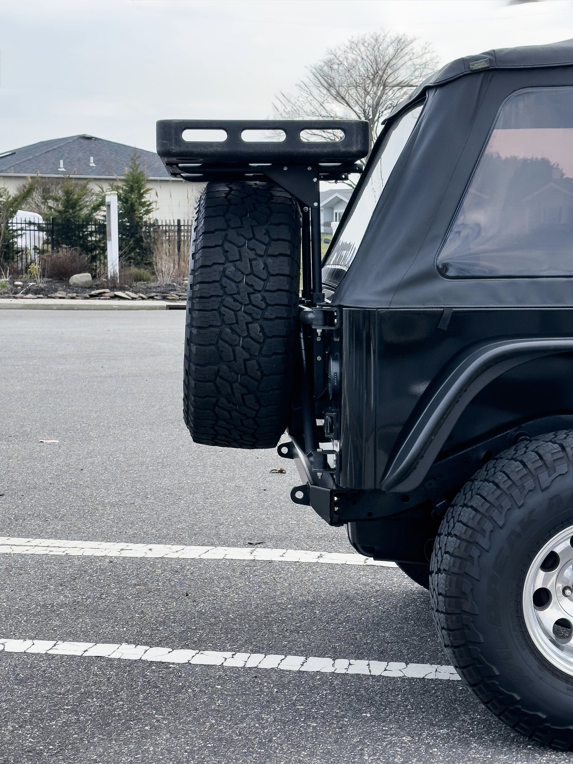

As mounted on the back of Tess, tire is 31" KO2 (an old one) for reference. The rack folds flat for storage where the bars meet, you can see the cruciform in the black plastic disc just below the top tube on the left side of the rack.

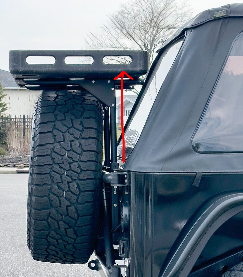

FWIW, just a thought: it wouldn't be a mission to craft-up two new vertical support bars for the basket. Raise it enough to clear the bike rack and, ideally, keep it below the roof top so as not to create wind resistance.
There is room on the existing verticals to raise it but for months I’ve contemplated doing exactly what you describe.. 1x1 stock with welded in gussets instead of the round tubing with bolted connections, with the goal of strengthening the whole.
Haven’t pursued it because of the additional weight of the heavier stock
The basket is rated for about 50 pounds. Add on the heavier stock and the bicycle and there’s not a whole lot of capacity left.

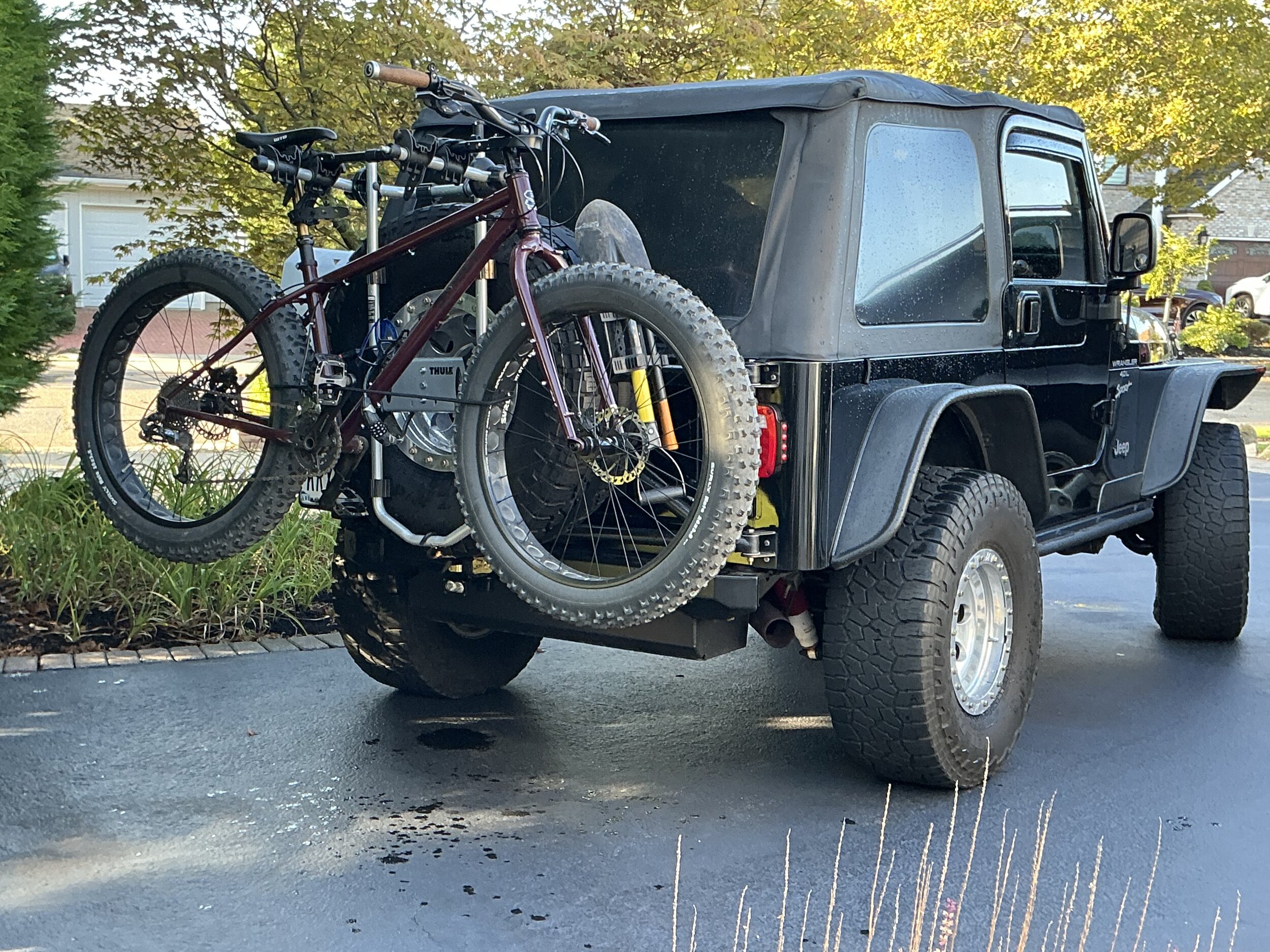

Well.. It's functional.
Will provide details on the solutions once I take it back off. For now I had to sacrifice the threaded lock knob for a simple M8 1.25 bolt. Pretty easy for someone to steal the whole rig with a 1/2 wrench. Did a quick search for an M8 1.25 x 140 mm safety Torx pan head but came up empty.
This bike is being donated to a coworkers son. I am picking up a Surly Wednesday Fat Bike tomorrow.
For closure on this project... the Thule rack works just fine. I still have to revise the mounting bolt. Easy enough to install and remove.
