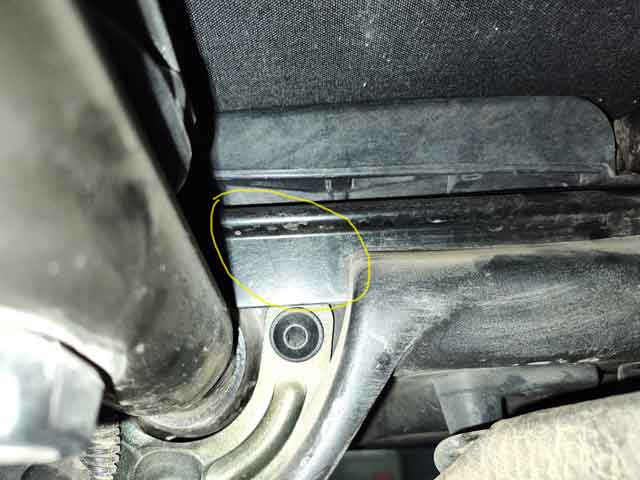

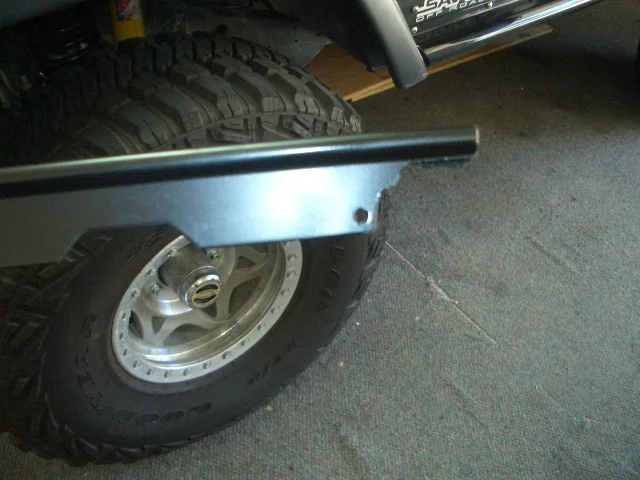

I dunno what could have caused those issues, it mounts right up onto a 2004 once the plastic trim has been temporarily removed. This is a terrible photo but the part circled with yellow shows part of my drill-style header under the plastic trim. It seats flat against the inside edge of the windshield frame, it doesn't go on top like some think it does. The angled sections like on the right in the second photo fit together in the center to go over the top of the mirror.
P.S. Now that I think back I think I did have to use an angle grinder for a little more clearance where it's two pieces fit together over the footman loop. I hit it with a little satin black Rustoleum afterward where I used the grinder.
