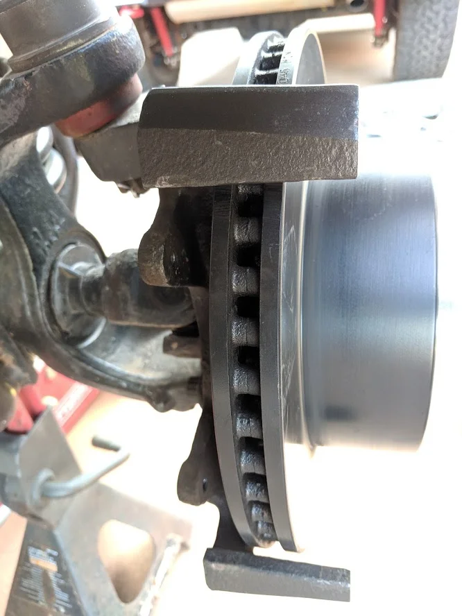

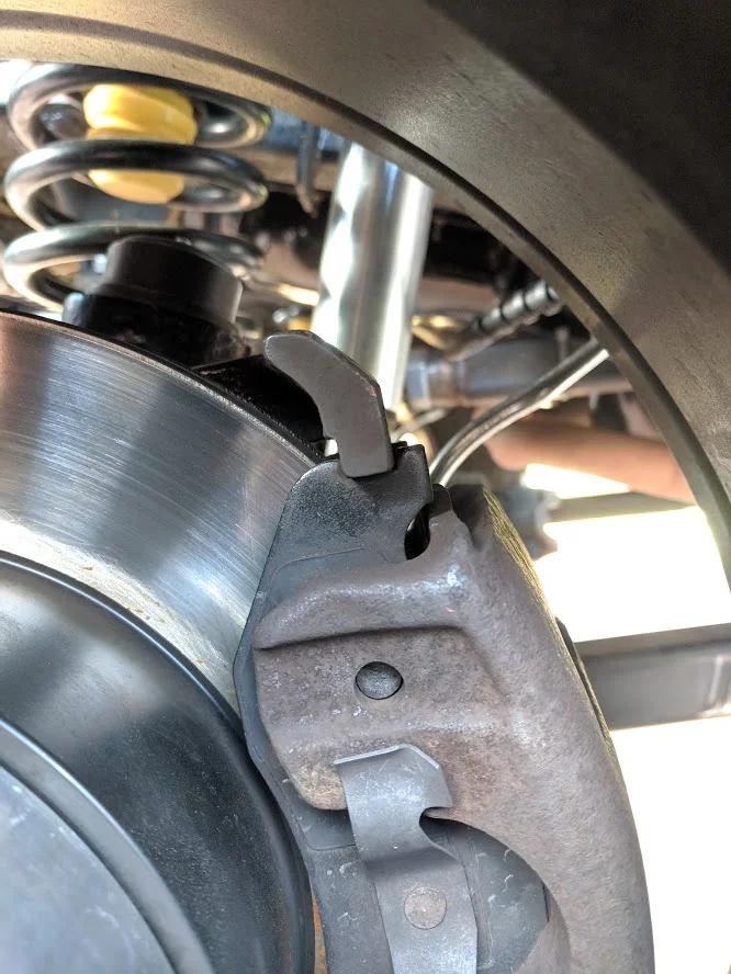

Ok, so I've been having brake squeal after 5 years of flawless performance from my BM. After reading this post last week I flipped my pads (apparently upside down) to see if it resolved the problem. It did not, so I asked for clarification on what was up. While flipping the pads I took careful pictures to ask questions.
First, are these divots deep enough going to cause problems? and Is the paint on the slider a problem?

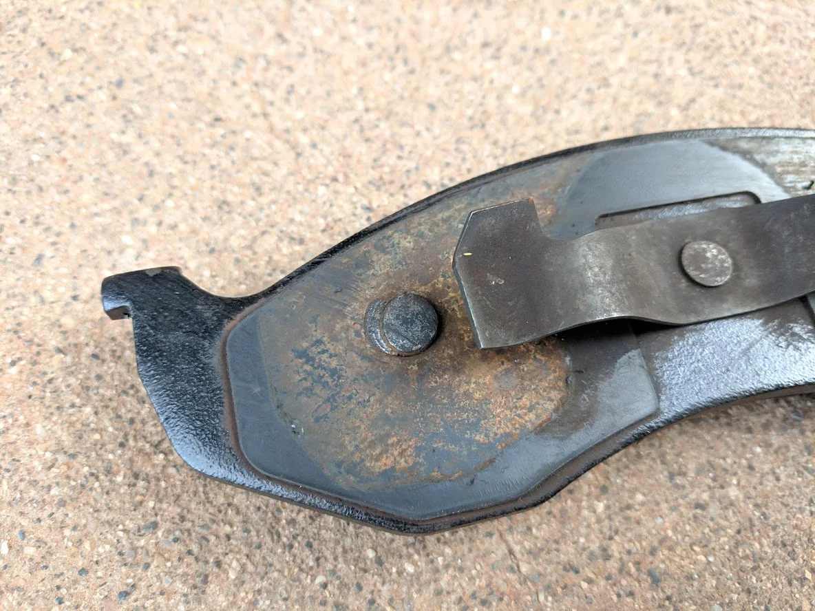

Then while carefully inspecting and cleaning the pad itself I found this:
89532
I'm going to go out on a limb here and say that a while back, I had not fully seated the pad and the first time I hit the brakes the caliper crushed the edge of this pin. Is it safe to assume that this is why my brakes squeal?
It certainly isn't going to help it not make noise.
