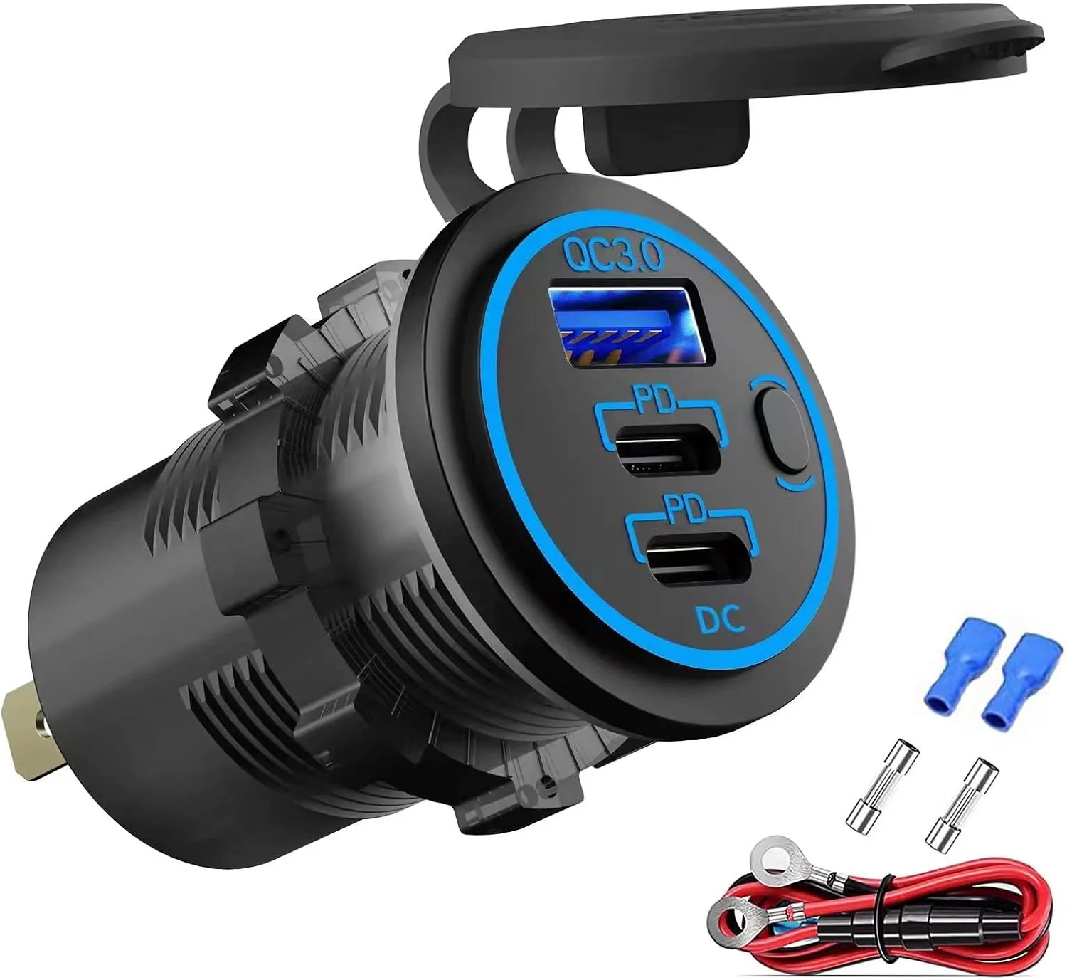

I would disconnect the wiring from the back of the socket first and verify that it is the problem. You can pull the ash tray and 12V socket without taking the dash apart. Then if you've identified that it is the socket I'd next ask do you use it? And if so for what? If for phone charging and the like I'd suggest replacing it with a 2 or 3 slot USB type plug. Similar to this.
https://www.amazon.com/Outlet-Charger-Charge3-0-Android-Suitable/dp/B0BX6F1ZP9/?tag=wranglerorg-20
