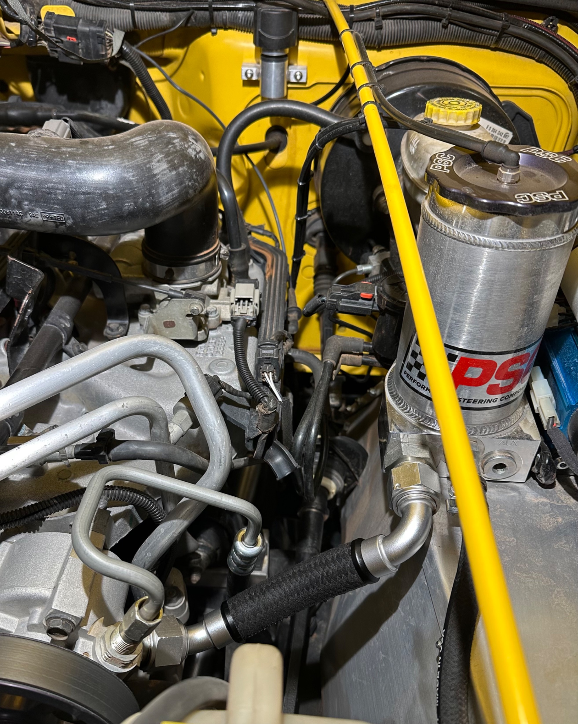

Before diving into the install, I want to cover my current set up and experience. I have been running PSC's Hydro assist kit. This kit was installed about 3 years ago. It included their gear box, pump, cooler, and reservoir. This kit made a night and day difference with steering power. But unfortunately when fast steering input was given, I could feel the steering wheel become harder to turn. I changed the mounting location of the reservoir so it was closer and a more direct feed into the pump. My hope being it would resolve the issue I was experiencing, it did not. After chatting with Blaine, The next suspect was the -6 return line. PSC's kit is plumbed using -6 for the return. Blaine's -8 kit is designed around high flow, high pressure and low restriction on the return side. This kit replaces all the -6 return components and upgrades them to -8. Below are images of the PSC -6 return.

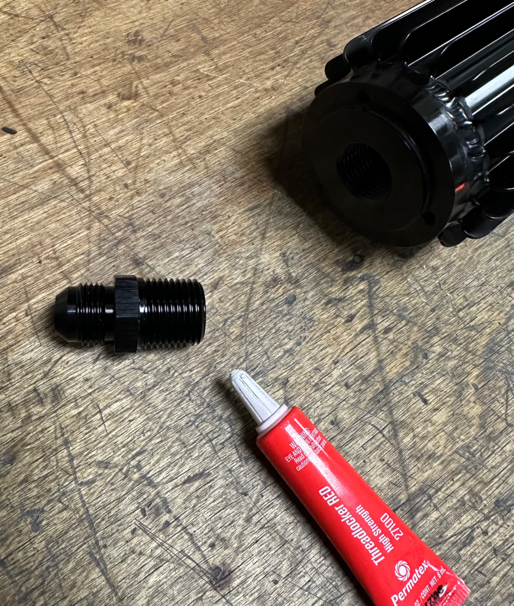

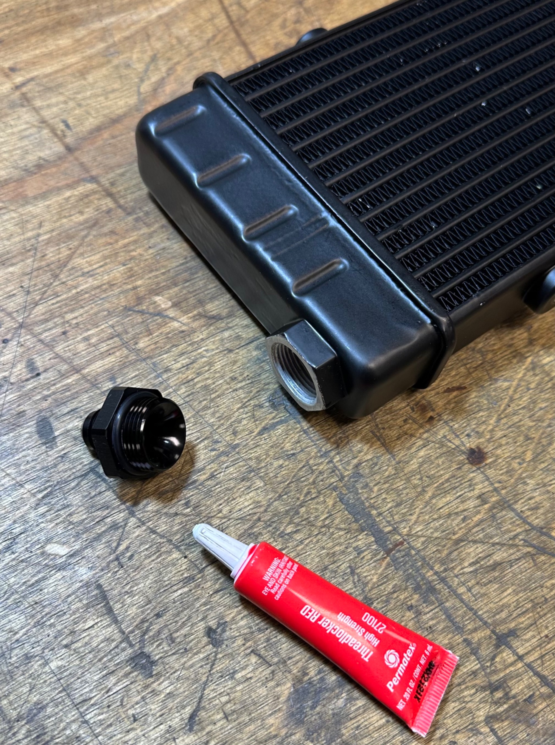

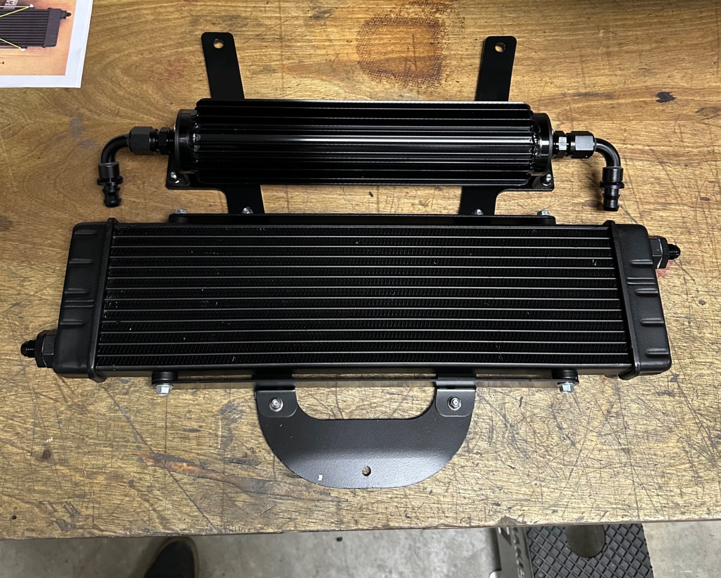

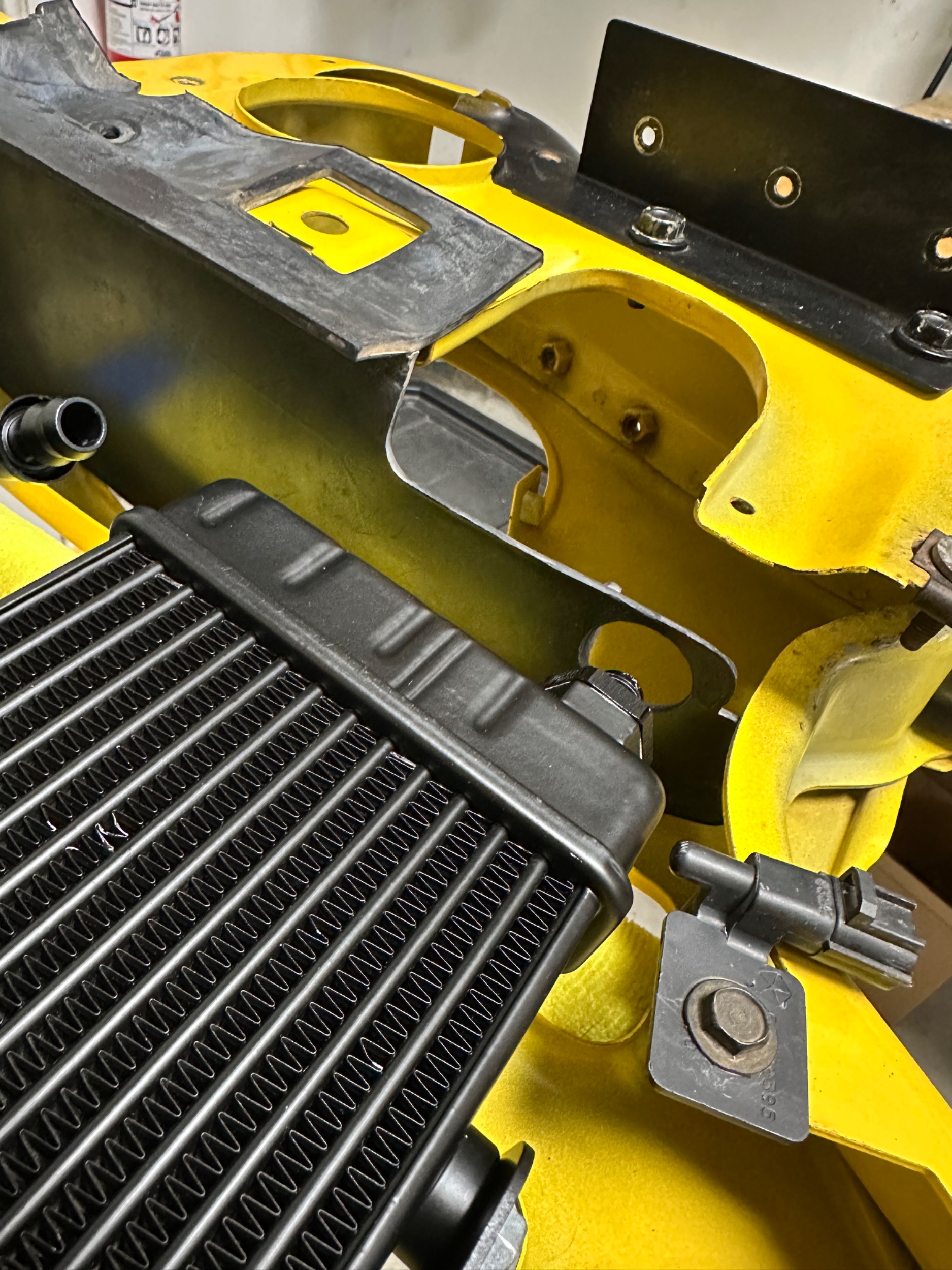

I opted to remove the grille to install the coolers and V mount. The power steering cooler may be installed with the grille still on the vehicle, but fighting the transmission cooler into place wasn't something I wanted to try. First I prepped the V bar and coolers. A coat of black paint was done on the brackets. To prep the coolers install the threaded adapters in both the Derale and the Setrab. The adapters should be installed with red Loctite. (NO Loctite on the AN side). This acts as a thread sealant and insures the adapters wont move when installing the AN fittings. Word from the wise, The Setrab is delicate, use a wrench to hold the boss when installing the adapter. Following the instructions found in the Black Magic Kit, mount the power steering cooler and transmission cooler using the suggested hardware. When completed the V mount with the coolers will be ready to install inside the grille.

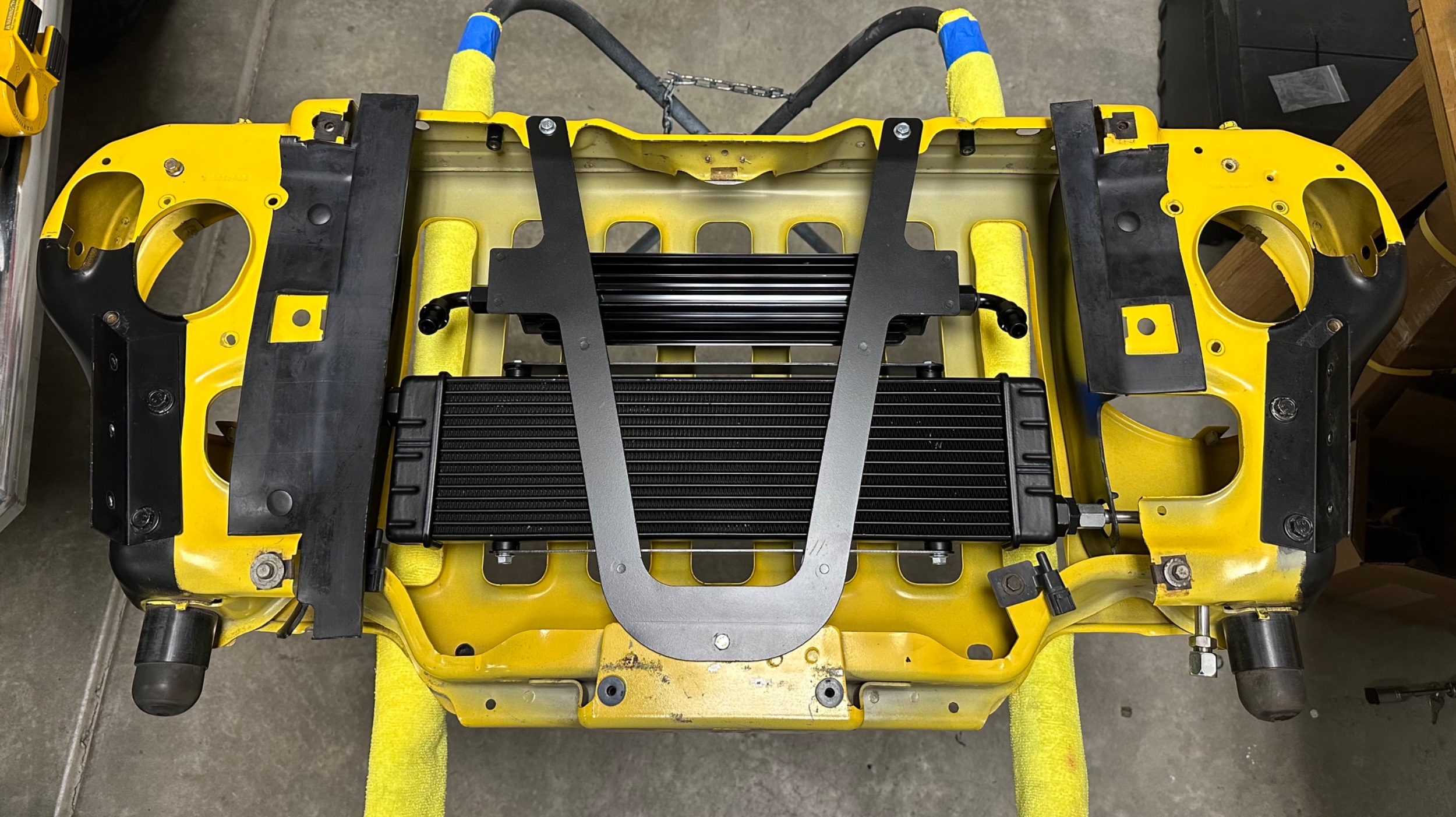

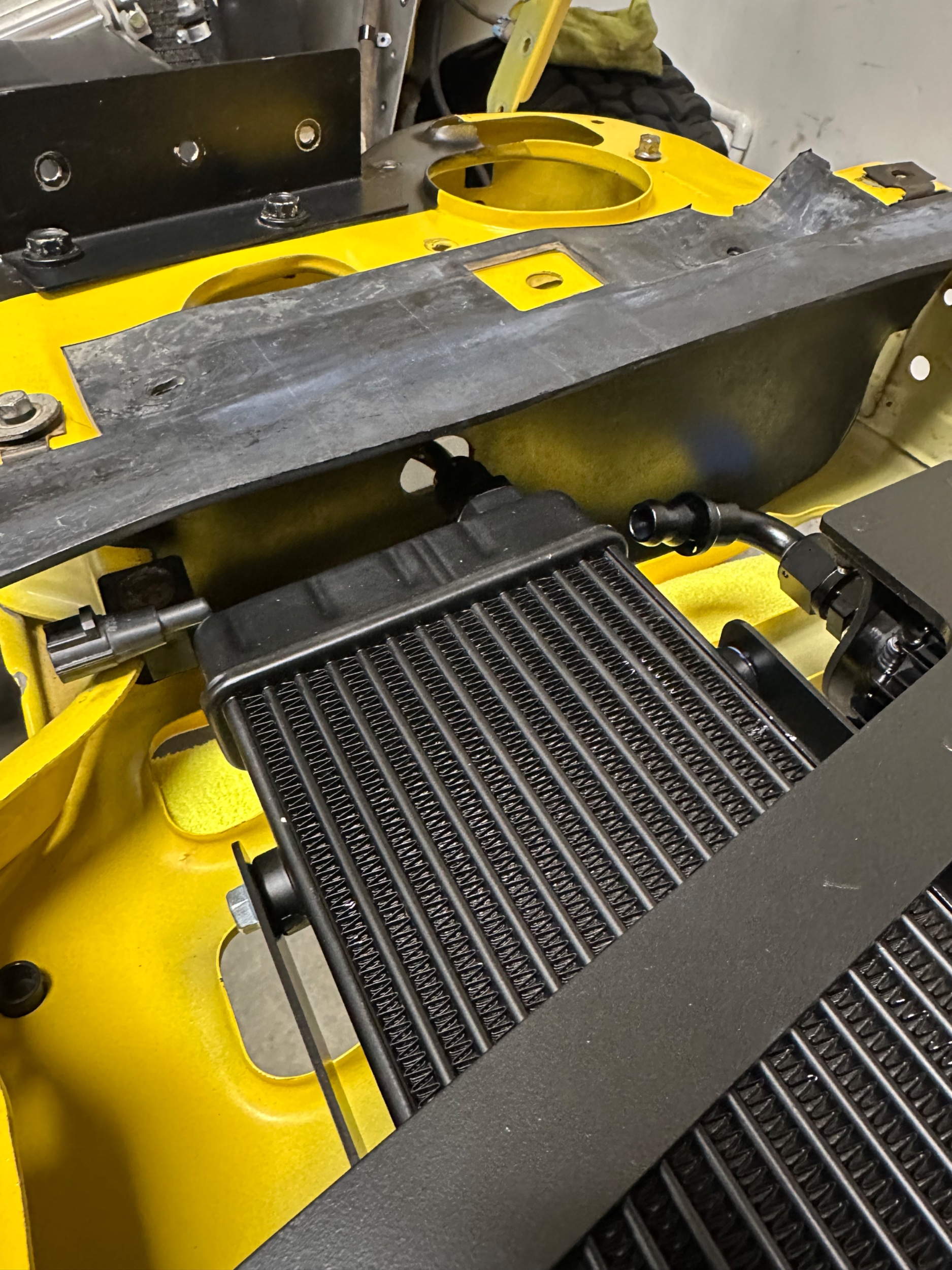

Install the V mount with the coolers into the grille using the included hardware. If installing the Setrab, now is the time to cut holes in the air dam. I used a hole saw. I installed Blaine's fitting on the side of the transmission cooler. This fitting helps get the hose down and out of the grille ready for the AN fitting. Installing this cooler without this fitting would not be fun. Space is tight! Take your time. The last thing I wanted is to have issues that required pulling the grille.

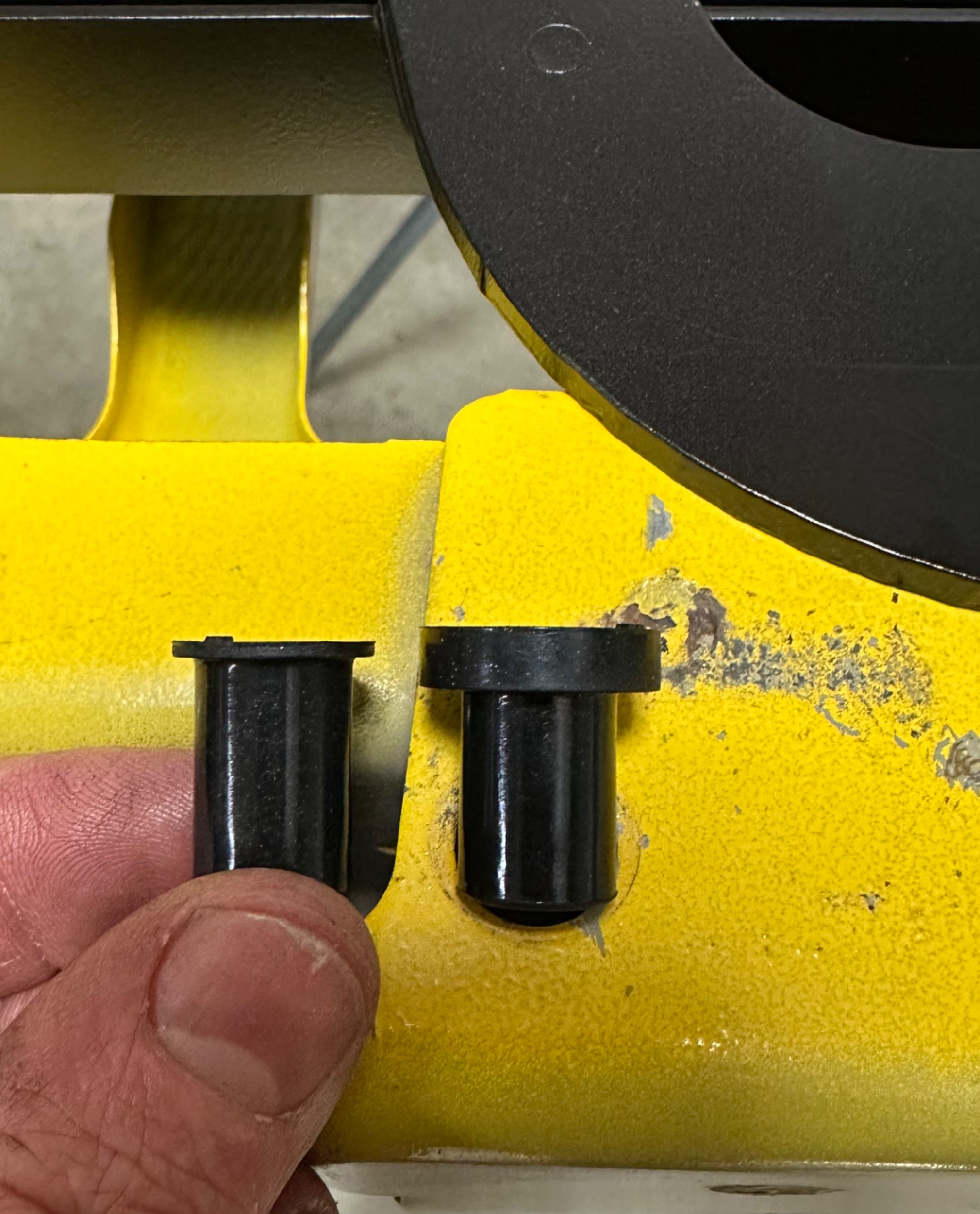

Find the new included well nuts. Note that 2 of the well nuts have a thicker flange. These go at the bottom of the grille. The thinner flanges go to at the top of the grille. Install the well nuts with some super glue under the flange to keep them in place.

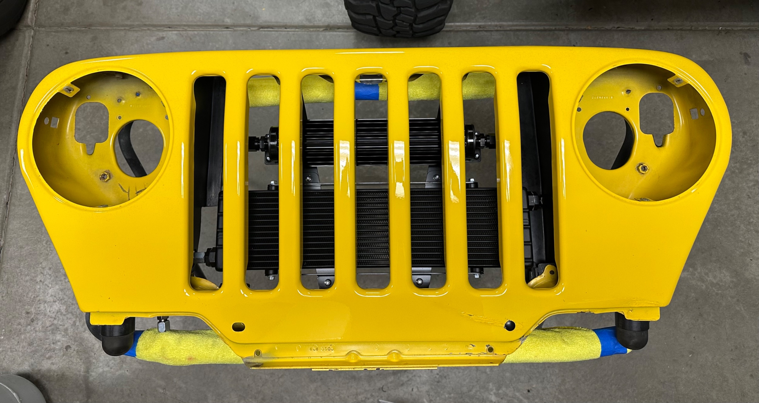

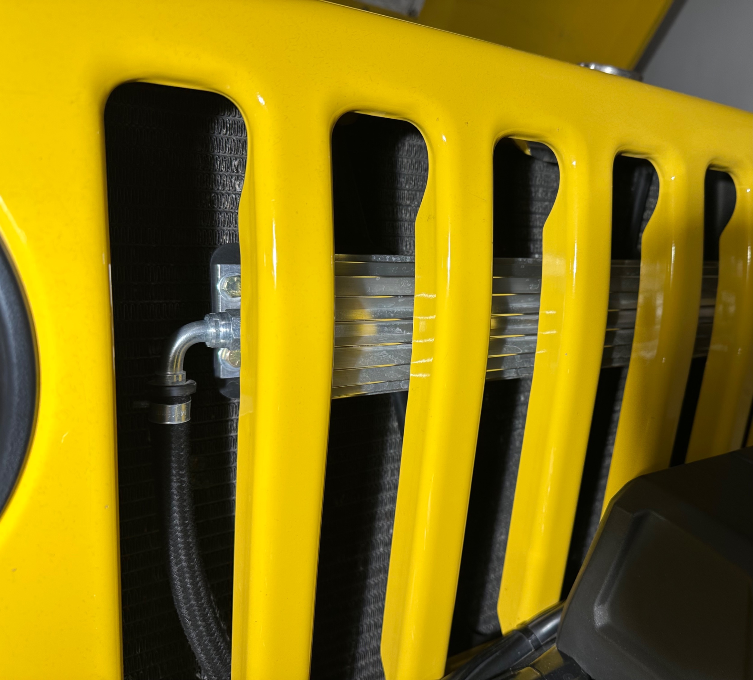

Below is an image of the grille ready to be reinstalled. Double check your work here. Make sure adapters are tight. You can see the transmission cooler fitting on the right side, it is tight and ready for the AN fitting. Access to the coolers and fittings gets harder from here on out.

The only explaining I see that may be needed is why the fitting for the Setrab is on the right side. Just easier to do that way is all and we want to go in at the lower port and exit the cooler at the upper port to push air out and prevent an air lock, or try to anyway.

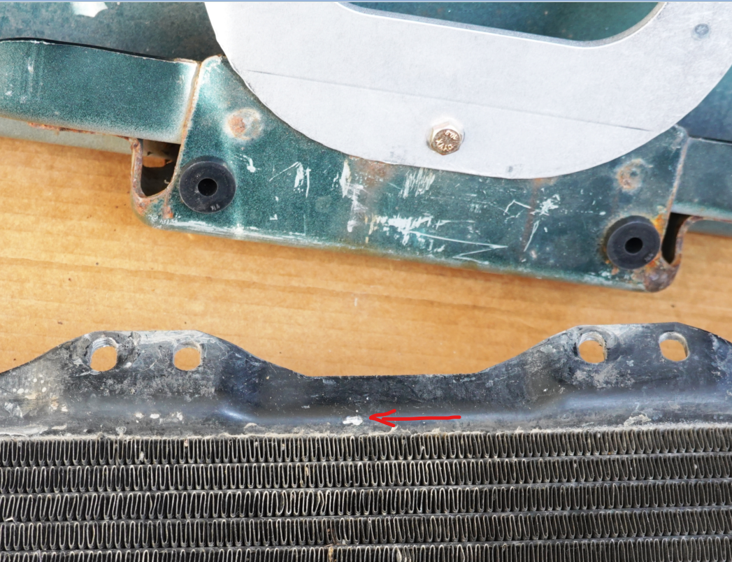

This won't matter to most but if I see something, I try to work around it and not make it worse. Because we are adding some thickness to the V bars where they bolt to the grill, that moves the head of the fastener into greater contact with mounting flange on the condenser. The thicker flange on the well nut spaces the condenser out a small amount to help with that as does the conventional hex head bolt instead of the flange head used at the upper pair of holes.
While I don't believe it would hurt much, it isn't the correct way to do things. This is the condenser that had the contact point in stock form on the stock V bar lower bolt.
Never realized that made contact. Not to derail this thread...but this might be a worthy point of discussion in the radiator thread as to why many manufacturers fail to build a TJ radiator.

Zero to do with the radiator. The radiator is well removed from that area and the only thing that can make contact with the bolt head is the mounting flange on the AC condenser which sits in front of the radiator.
Makes sense why it would be installed in this orientation. The instructions mention to install the cooler this way, I simply followed.
Great catch and solution! Your instructions are very clear on where to put the new hardware. Having the backstory brings this full circle.
