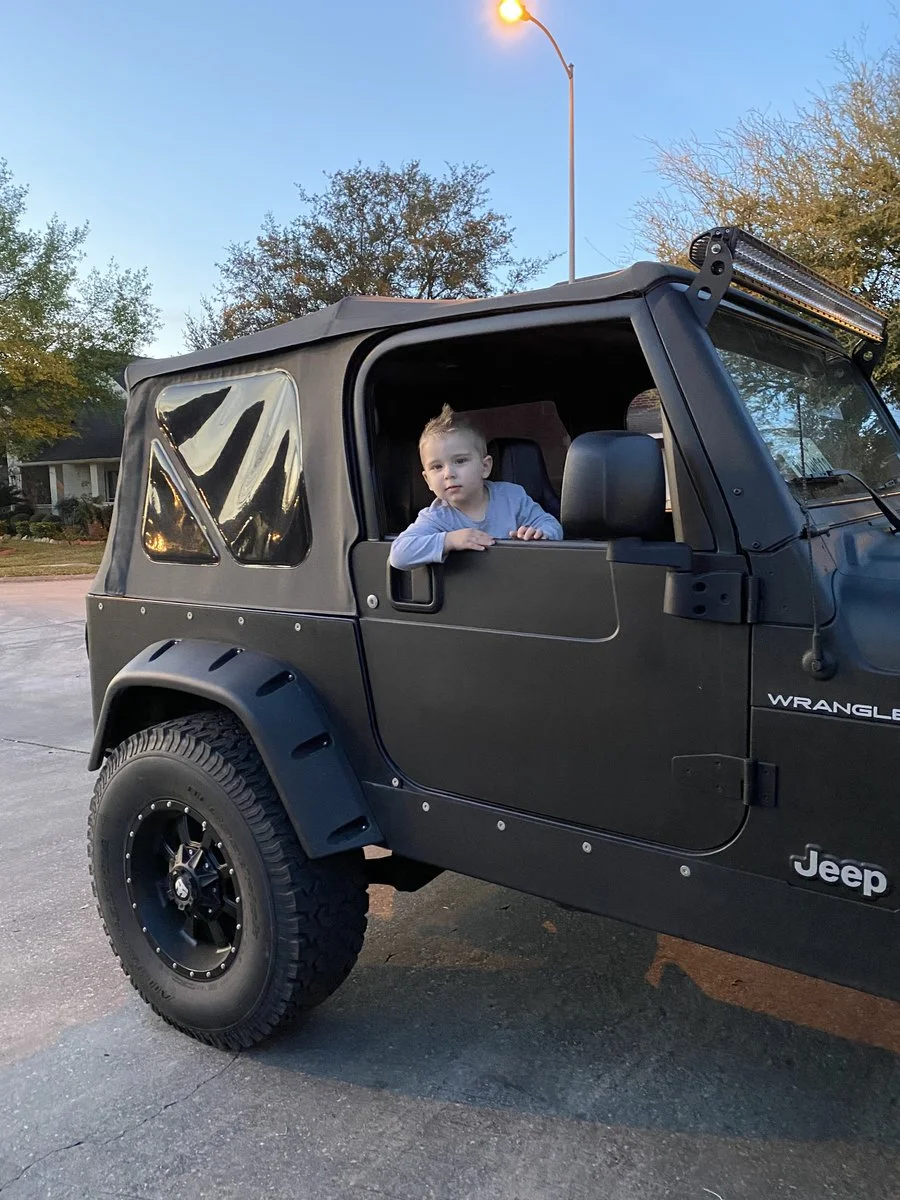

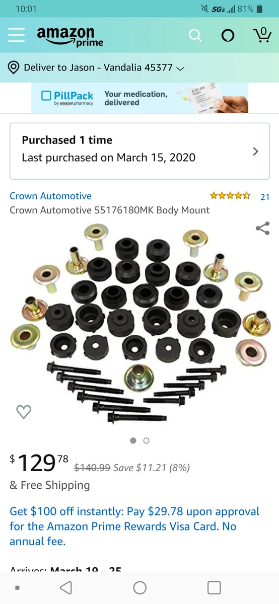

my honest advise would be to replace the worn body mounts with OE rubbers and add the 1.25" BL & a MML.
ditch that huge fugly misshaped rear flare for a trimmed stock piece. and attempt to guestimate some bump stop temporarily until this is sorted.
what use do you have planned for this rig? is it just a cool ride around town? or are you gonna take it to the trails?
you can slop together a cool lookin Jeep easy enough......to build 1 that functions on the trail is another monster and if you cut corners you'll be disappointed, not us.
some things are becoming redundant also. if your willing to do HL fenders and trim the tub you don't need more lift. if your gonna do more lift you don't need HL's or trimming. it's all about getting the wheels enough room travel to function and either method will work. it's just where do you wanna spend your $.
and the BL and MML will compliment either set up.
