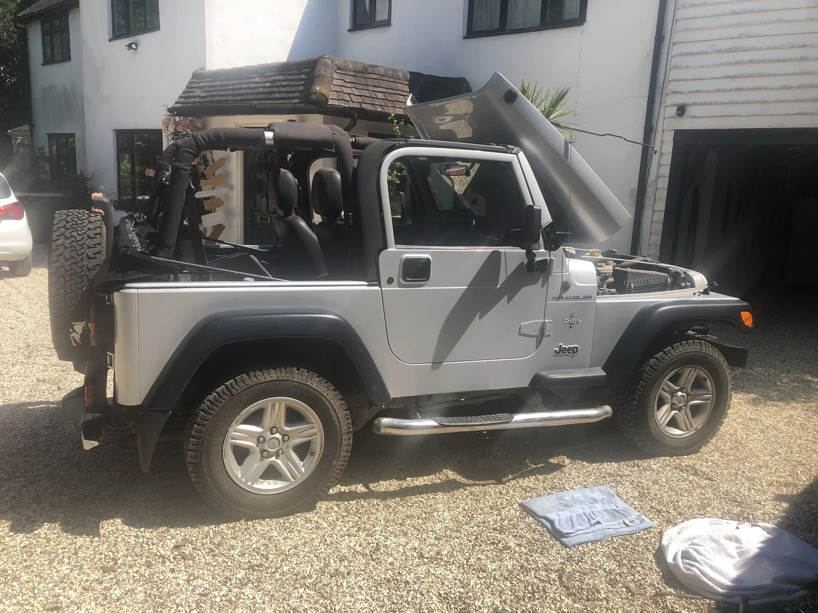

How is the lift? I think you were going away so had much time testing it?
Not sure there is much to say about it. The Jeep is taller, I like the look better though it is not that obvious in pictures.
Before
After
Also helpful that I have a silver Jeep, so the aluminium pucks don’t look out of place.

Before
After
